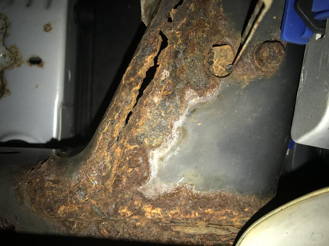

Rust under the paint on the rear license plate holes. 2015 SR5-P.
Rea frame rail/hitch mount bar rusted bad.
Just purchased this $runner in Pensicols 2 weeks ago, found rust all over the backend. The hitch bar part cost 800.00, and needs to be welded in place. The labor is 1200.00. Thank God I got a great price on this rust wagon. Would like to know who else has this issue. More pics in MY GARAGE

^^^^ That looks like a 1st or 2nd Generation Tacoma. I have yet to have a rush issue with my Tacoma and hope I never do.
Well that is a reason why I have used Fluid Flim on my Tacoma's in the past and now on my 17 4R. Sprayed my 4R with 2 cans last weekend.
