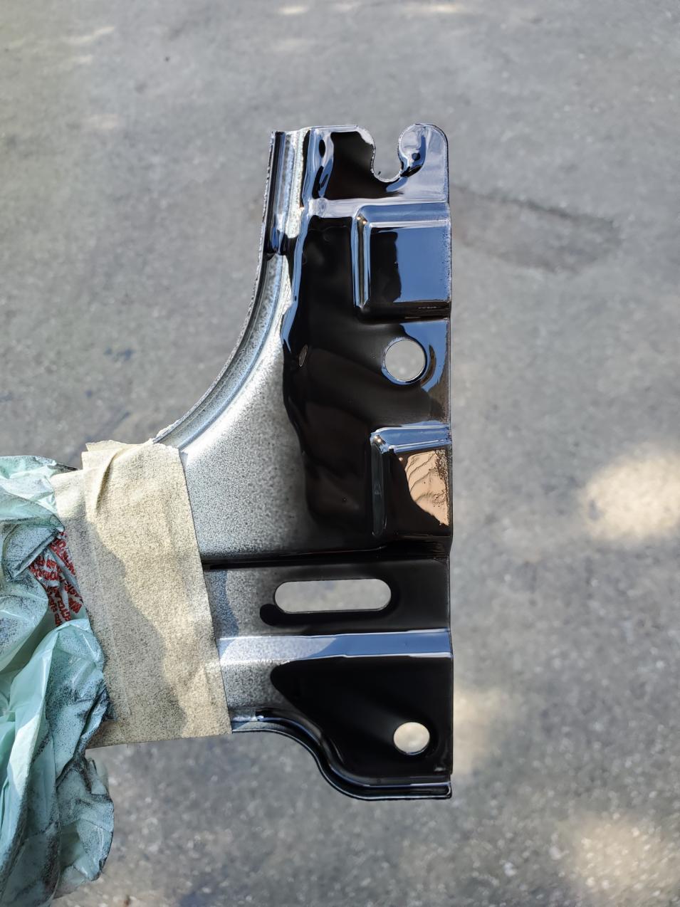

Same thing happened to me. Sanded off the rust and sprayed rust inhibitor.
Out of curiosity, given that the rust is centered where it bolts to the tailgate, have you considered that this is galvanic corrosion?
If you have two dissimilar metals, one will corrode horribly. Even if you paint and reinstall, it will rust again. You need a thin barrier between the two metals.
Wranglers were known for this - the door hinges were a different metal than the body and was a source of early rust. Jeep fixed by including a thin piece of rubber between the two.
[MENTION=183417]dweh54[/MENTION]
Thanks for your message. I have no idea what that is but I will put some rubber in between after I dremel and paint next week. I appreciate the idea. Thanks.
OK so I finally got around to taking care of this. I dremeled the rust out, but there were a couple of specs I just couldn't get at as my grinding stone wore out and I didn't want to close the gate to go to home depot as I was afraid I would not be able to re-open it. But I think this is good enough for now. I did put some rubber between the 2 metals to prevent the galvanized corrosion mentioned by [MENTION=183417]dweh54[/MENTION]
