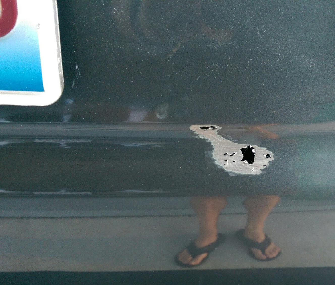

Not sure if this is a common problem or not. I had a patch of rust starting to show under the paint on my 2007 liftgate. Just under the rear license plate.
So ground the paint off and back daown to bare metal. You can see where this area had been patched with body filler and repainted. I knew it had been repainted but not sure why when I bought it.
This gives an idea of the area size and location - started poking at it and it was all the way through.
Ground down fist pass
Sprayed it with some primer so I could detect any more spots and there were a lot as you can see.

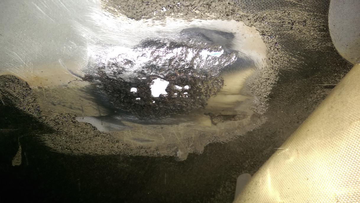

So ground some more and ended up taking the inside panel off. That is when I discovered the about 15" square piece of eith insulation or sound deading material stuck inside the body panel. What had happened is that a strip of the 1/8" thick rubbery material had seperated from the metal and was trapping moisture behind it. It is cover with a die cut sheet of thin plastic sheet.

So I ened up grinding more and removing a lot of rust and left many big holes.
Ended up laying fiberglass resin and cloth on the inside first and then again on the outside. I little filler to smooth things out and then paint. I just used the duplicolor stuff from the auto parts store and then clear coat, but came out fine.
Still not sure the purpose of the material that caused the problem but it sure did cause a lot of damage.

Mines got this issue too...so are you guys just completely removing the piece of rubber that’s causing the moisture to get trapped? I had mine ground down and fixed a few years ago like above but it has come back. I didn’t think to open up the inside of the tailgate and look for causes though. Frustrating
