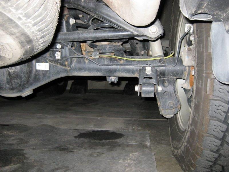

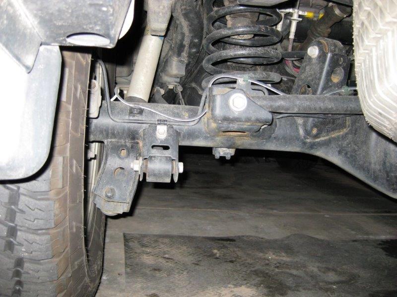

2 colorado winters and mine looks like this. I`d go to the dealer and rise hell about it.

So I bought a new 2012 4Runner Trail last November. Today was just loading stuff in the back and saw some rust under the truck. Looked under to see pretty much everything is covered in rust. Does Toyota have some new car rust policy or am I stuck with it. Thanks
My truck is 2 years old and pretty much the same as yours.

Really I have no worries seeing rust underneath my vehicle. What is most important to me is the RATE at which it is rusting. Now, if you guys showed me pictures of corrosion underneath that has pitted the steel considerably and not the surface rust that is shown then I would be concerned and looking for an alternative fix. My truck underneath looks like the OP's picture. I figure it will go a long time before rust causes any problems other than cosmetic.
I consider the material spec to be much more important for corrosion resistance (underneath) on a vehicle of this type than any type of spray on coating. Even in the short time I have had my newest 4Runner (6 months) I have lots of scratches from rocks and debris that I doubt seriously any coating would have withstood. I understand that for some people this is important to be rust free and if you have a 4Runner in most of NA you will be rust free. If you live in the snow areas of the east and you want to be rust free then you will have to spray on some type of coating and reapply it if you go offroad. To me, having driven many miles in my 34 years I have had a license over snow and salted roads, this is normal and no cause for concern. I have no rust on the actual body components like the floor pan, only the iron and steel suspension and frame components. Materials.

This is a real good point, OP, what types of roads do you normally drive over? Gravel? Actually, looking back at your picture, it looks like you're parked in a gravel lot, lol.
If you knock off the frame paint from road debris, it's only a matter of time before it starts to rust, and judging by your pictures the most severe spots of rust seem like right around where debris would kick up and chip off the paint...
