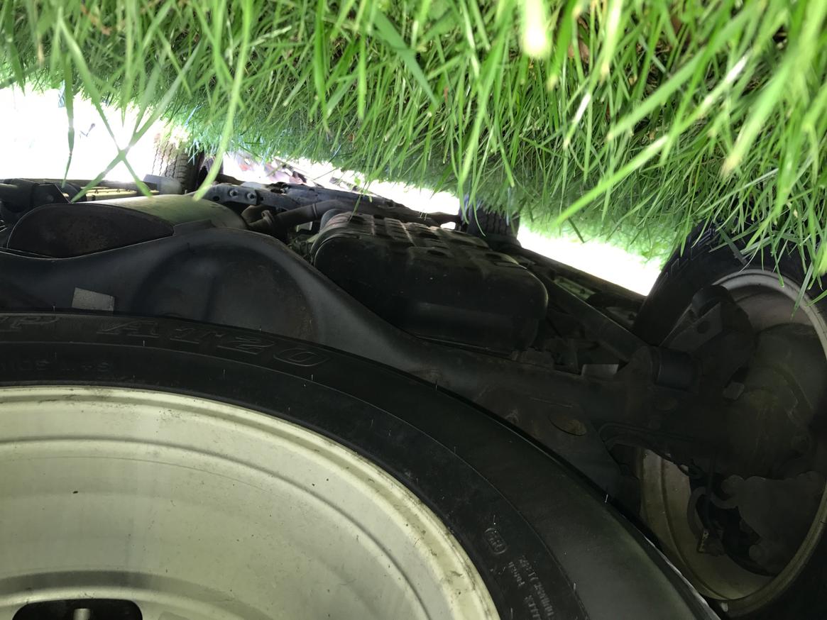

Here's one.

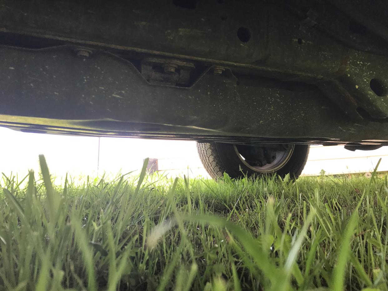

Another. It's only letting me upload one at a time damn it. Just hope they're not trying to hide it with spray paint.
Looks like its been painted and or well maintained.
Stab it with a screw driver in a few places and go from there but it looks pretty good to me.
Agree - I would not buy many vehicles, only based on photos.
- but judging on the photos, its worth a personal look & crawl underneath...for thorough inspection

It look great to me, never would know it was from up north, check it out very well in person in case the photos don't show any issues, especially check the passenger's side of the frame where the AC condensation drips down on the frame, that seems to be one of the major rust areas when rust becomes a big issue on northern frames.
