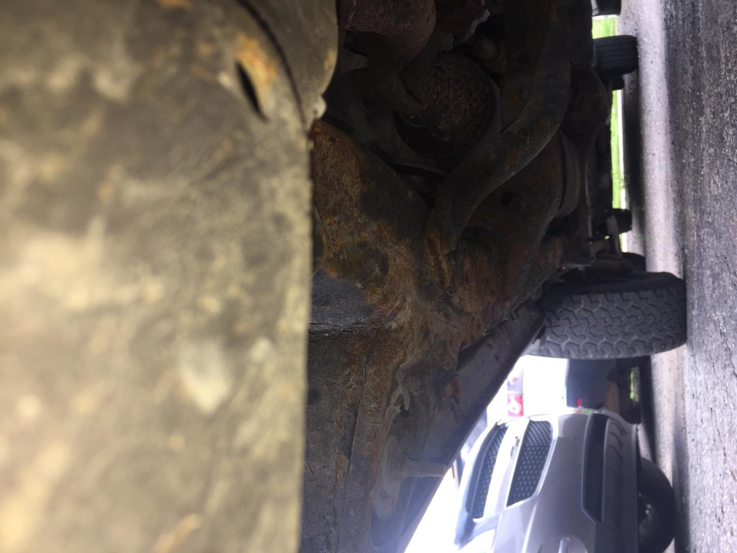

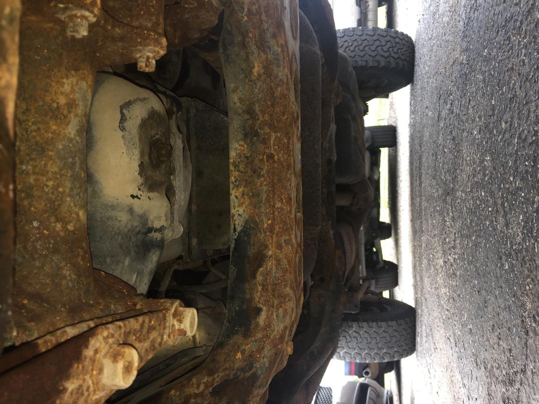

How about this? I live in Michigan.

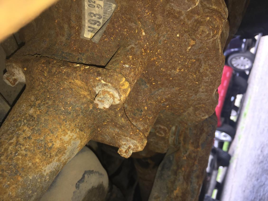

Here is mine.... 06 144k miles.... What do yall think??? Sorry for terrible pics!!!
Is that a crack in the crossmember above the LCA alignment bolt? Front skid probably has rusted bolts also, common problem, have to use antiseize when installing them after an oil change. Every used Toyota I've bought has had at least one skidplate bolt non-functional.
The AC drip is usually on that side.
Not a crack, just fluid. lol

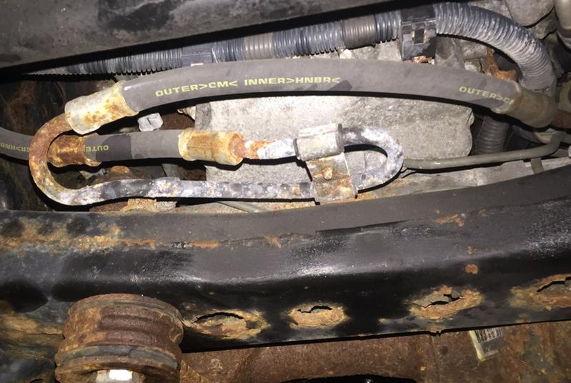

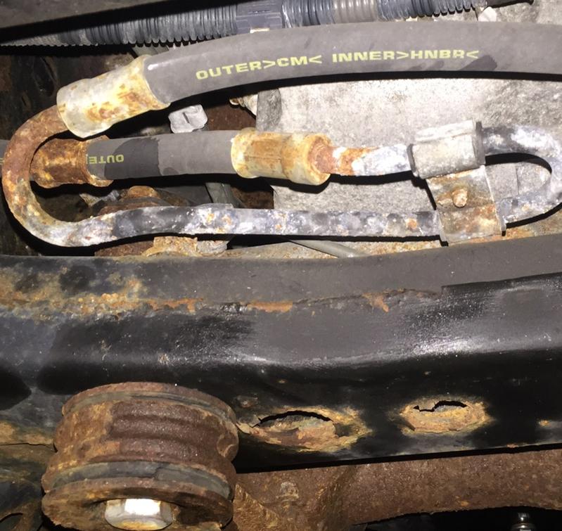

Hi, All! New comer here. Sorry to bring up this old post, since I am not sure where to ask these specific questions regarding skid plate from my 4gen v8 4wd runner.
Long story short, I don't know when the skid plate got removed. Maybe during the oil change a couple of years ago. I plan to get a new one installed in dealership (my garage doesn't have sufficient room to work on it). But I found some pipes underneath are quite rusty (pls see the attached pic). They are near oil filter, and I assume they're supposed to be covered by skid plate.
My questions are:
1. do you know what are these pipes for?
2. are they in bad shape?
3. is it better to have those pipes replaced before adding a new skid plate?

Chances are the skidplates were taken off because several bolts were snapped off and are now lodged in the holes; it will be a royal pain to drill them out, but is necessary to get new skids on.
1) I believe the pipes are for power steering and AC, but don't quote me on that.
2) I don't think they look to be in particularly bad shape, mine are worse, although they aren't great.
3) Not really. Skidplates are 8 easy to access (on a lift, not too bad on the ground) bolts; that shouldn't be a consideration as to when to replace those lines. It's like saying, "as long as the tire is off, what all should I replace on the suspension so I don't have to go through the trouble of taking the tire off again later". If there's reason to replace them now then do, otherwise don't do it just because the skidplates are already conveniently off, they aren't hard to get off/back on again.
cool. thanks a lot for your inputs! I will just add a skid plate for now.

That is the higher pressure line for the power steering, and I could only wish mine looked that good (which is why I know what it is, because I’m planning to change it this fall). I would definitely consider changing though, even though it’s not as bad as mine because if it blows because of rust, you will be left stranded, or risk burning up the PS pump. They seem to be available and somewhat affordable on RockAuto just as an FYI...
