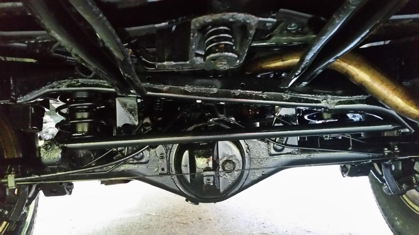

Used diesel oil FTW. Best protection and its free and looks great.
