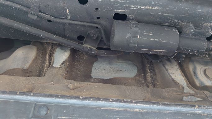

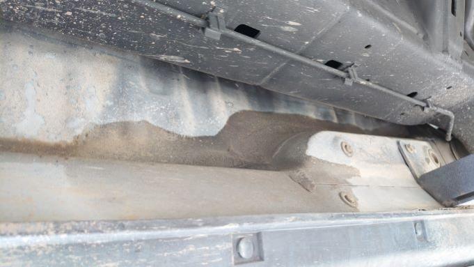

Im bringing an ‘05 back from CA to NY next month I was planning on doing Fluid Film. The only rust I’m seeing on mine is on the exhaust, but probably nothing serious since it’s been in CA it’s entire life. Is there a reason you chose POR-15 over Fluid Film? I’ve heard some say POR-15 is better if you already have rust? But are there other considerations? I want to do whatever I can to combat the salt.
