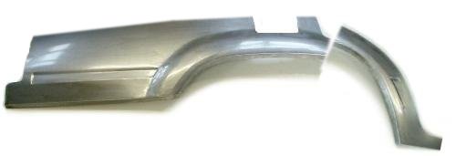

choochcharlie-albums-rust+repair%2C+1995-picture3160-drivers-side-rear-corner-all-way-through.jpg
I'm planning on cutting and grinding out the worst of it, and using POR15, as I have read on here. Never tried treating rust, and always had it come back.
Anyone have any photos or tips for the rear corners and that spot by the rear passenger doors?
you will either need to make your own , or find a good used one .. Toyota does not even have those repair panels avaliable anymore ..
toyotafiberglass.com has STEEL weld in "dog legs" .. but thats it ..
