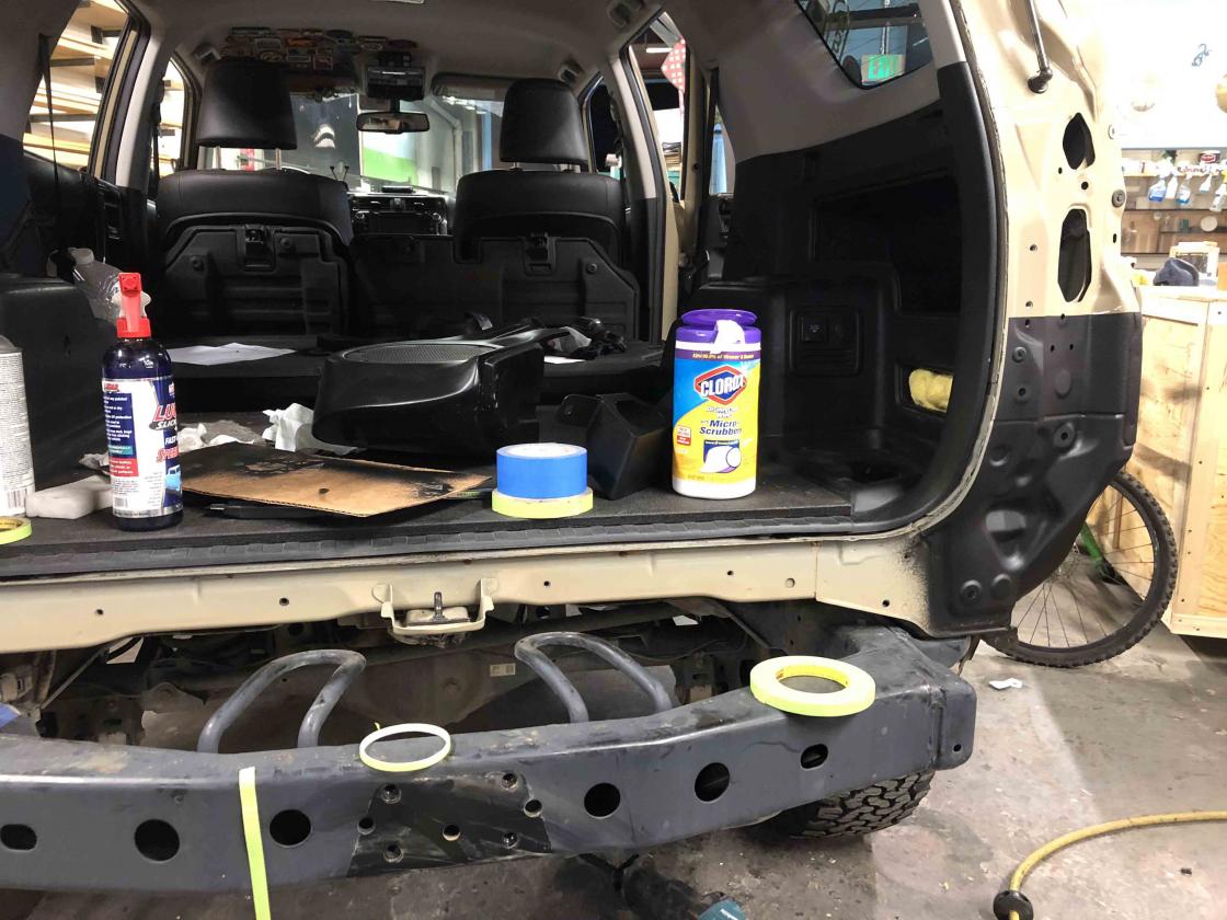

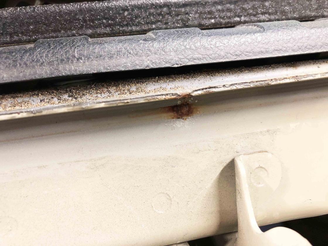

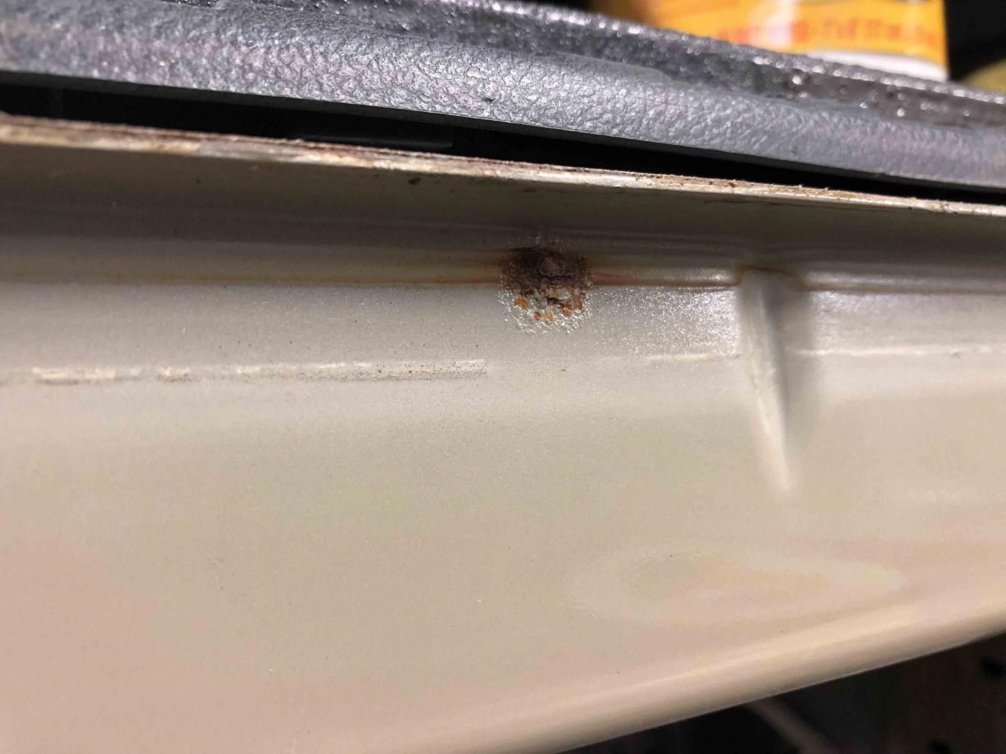

I am in the process of installing my C4 dual swing rear bumper. I was cleaning the hard to reach areas from 3 years of road dirt and came across these small but pretty bad areas of rust. It is troubling to me since this truck has only been on the road for 3 years and lives in SoCal.
I do not believe these are a spot weld area but I could be wrong.
Has anyone seen these spots rust?
Thank you for the help.

You should have a 5 year 60,000 mile warranty in regards to paint and corrosion. I would take it to the dealer and see what comes of it. Who knows, there might be more in other areas that you can't see. Surprising considering that it's a California vehicle, do you spend a lot of time in states that salt during the winter?
surface rust like this is excluded from the warranty, it's actually a "corrosion perforation warranty" and only rust that perforates (i.e. goes all the way through) is covered
Good luck OP trying to get Toyota to handle surface corrosion on a modified 4R, with a hacked bumper. I would try and bust the rust yourself with a cpc compound, wire brush and rattle can.
Have you been on any beaches....has you your rig been through any salt water? It's good that you caught it now. I'd take care of the rust myself, maybe under coat that area.
I was thinking about that today. Never driven on the beach, camped for 2 night near the beach in it's life.
I had the same thoughts about Toyota. I'm thinking to at least get it documented with Toyota so I have evidence of it if something else pops up.
I will wire brush it down and get some nice primer back on it then under coat it.
Also wanted everyone here to keep an eye out in that area. It's just under the weatherstrip.
I agree. Toyota looks at large tires and thinks it's modified.
Good thing I took off the bumper to find this. All I did was take the bumper cover off, no hacking was involved.
I find it laughable that some of you think simply driving down a beach can cause this or come to expect it to be a possibility. I have owned numerous Toyotas, all of which have driven the beaches of Texas many times over the course of years and never once have I encountered anything remotely like this. Unless you are purposely driving through the surf there is no reason that one could come to expect rust simply from driving down the beach. Now you should thoroughly clean the exterior and chassis of your vehicle after having spent any significant amount of time on a beach, but simply visiting one a few times doesn't lead to rust under normal circumstances.
I only drive mine in the salt and snow here in Utah, so I can only imagine what lurks underneath. My rock sliders were completely rusty by the end of the first winter. :rain:
There is a lot of misunderstanding and misinformation about rust. That is likely rusting from the inside out. Rust doesn't penetrate paint - it's coming from underneath the paint, from the other side.

Having spent my entire life in the Rust Belt, I beg to differ. When you get a stone chip that compromises the paint surface, you most certainly can get rust from the outside. It can progress under the paint from there and get pretty ugly. I would say that the rust the OP has shared is that kind - probably started from a metal clip holding the weather strip on.
You are correct in that the most destructive rust comes from the back side though. The reason this is true is that by the time you see it, it's too late.
