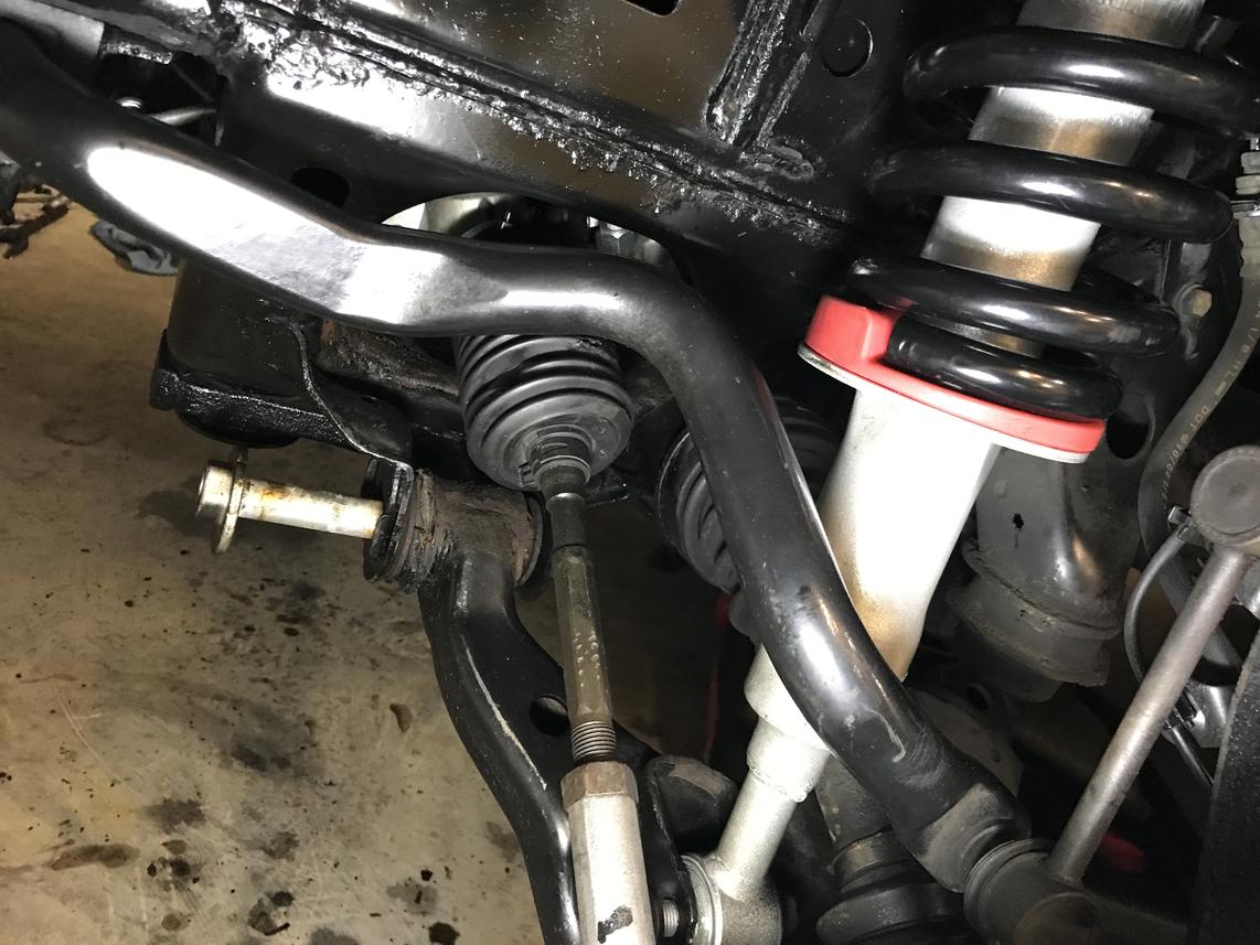

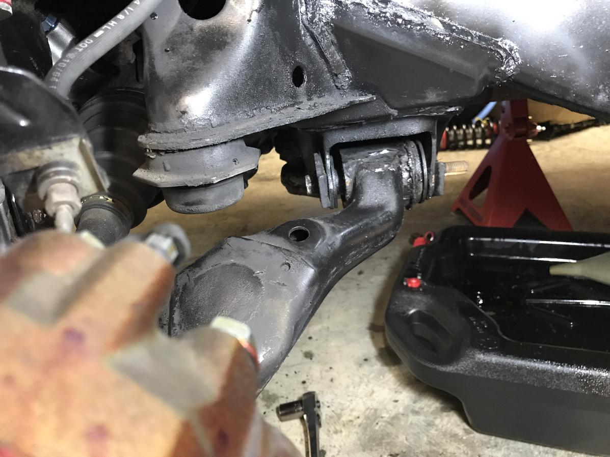

It has been a nightmare with this truck. Just finished changing the power steering lines and rack from rust and breakage. Front rotors also seized and repaired by me. Now I went to install a rancho quick lift, I discovered my Lcas are frozen and won't budge for me to place the struct and shock combo. The front bolts came off but the back camber bolts won't budge. What are my options? I want to cut the bolt and sleeve it sits in but that's a lot of metal to cut through. Should I keep hammering the bolt till it comes out then cut the sleeve? I was going to trade the truck I originally but now I have spent some cash and gonna keep it. It has 136 miles, 2005 4wd sr5. Thanks

Me personally speaking from experience, just sawzall it out. If they're frozen and not budging, then that's the only way to go. I've tackled mine with heat & air hammer, BFH, etc. and had no luck.
very common, probably the biggest PIA with these trucks. go to home depot, get a few diablo blades and cut it.. torch out everything else. buy all new OEM hardware and LCAs and dont think about it again for 100k miles. Use obnoxious amounts of anti seize.
Sawzall sucks balls, takes way too long to cut through. I used a 6" cut off wheel on a 4.5" angle grinder. Yes, this is SUPER unsafe but it took a whopping 2 min to cut those f'ing things off. Wear your PPE, have a cooler full of ice if you chop your finger off and need to take it to the hospital!!

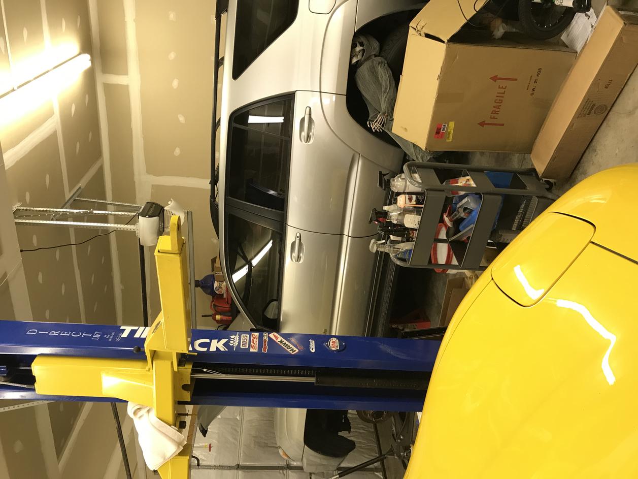

Since nobody asked, why is this rig on a floor jack when there's a 2 post hoist available?

Just use the sawzall and get some quality blades. Those bolts are hardened steel and tough to cut through.

sawzall will have it all done and on the floor in 10 minutes, then buy new bolts for it

Generally it is a frozen ajustment cam that requires you to remove that lca bolt. When you get the alignment done.
For the shocks you can pull the 2 bolts at the hub side, lca.
Support the upper control arm so it doesn't hang by the brake lines.
Be careful not to damage the abs lines.
One thing that hasn't been mentioned in this process. When you cut the bolts with a Sawzall, use plenty of oil while you're cutting. There are specific oils made for cutting, but 20 weight motor oil works way better than nothing. No one in industry does any serious drilling or cutting without drowning the cut in a continuous flow of oil. Cools the tool and keeps it cutting, rather than heating up and getting dull.
