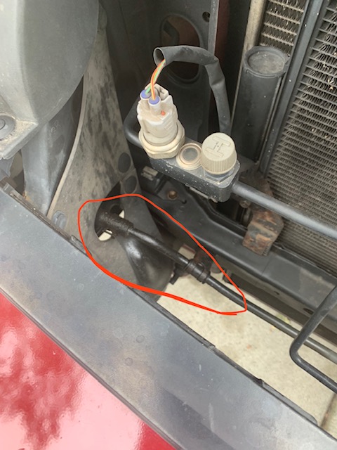

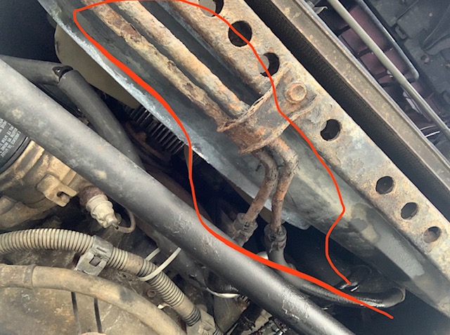

Found these lines in rough shape, assuming both are transmission lines? And was wondering if anyone had any part numbers and recommendations moving forward to tackle this problem thanks

The first pic, under that front crossmember are transmission cooler lines from the passenger side of the transmission, to the driver side of the radiator. You can replace those with flex line from the transmission output hardlines all the way to the in-rad cooler

Yep trans cooler lines. I recently discovered the same issue on my 2007. Ended up taking it to a shop because I’ve not had the time to DIY.
If you or somebody else is looking for this part #, it is 3290760061
I ordered it from parts.toyota.com which will show you the closest dealership to pick it up from - or you can pay for shipping.
After I ordered online, I was able to pick it up in 2 days.
Cost: $42
Dang! I just had this part replaced and I purchased it from the Naperville Toyota dealer for $125 and $92 for install at dealer. Mine were in the same condition as the OP.
Didn't know this website existed and that I could order from this site and then pick it up at the dealer.
