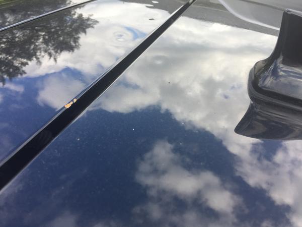

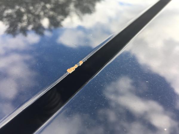

Ok, I want to use Rust Reformer on a spot on the paint job of my 4R. I've used it on the hitch receiver and the frame. I'm pretty impressed with it. It reacts with iron oxide (rust) to create iron tannate, which is black and inert.
BUT, Rustoleum's FAQ page says to not paint over it with water-based paint. According to my searching, Toyota's Black 202 is "waterborne" paint. So then, I looked at Corroseal, because it does the same thing and is water-based. The Corroseal FAQ page says it can be used with water-based coatings not subject to tannin staining. It also says water-based coatings may require an oil-based blocker in between.
That got me thinking...
My 4Runner is black.
My Rust reformer is black.
The iron tannate left when this stuff is used is black.
...I don't think I need an oil-based stain blocker to keep the black touched up area from tannin staining. Maybe I would if my truck weren't black.
I'll apply two coats with a Q-tip and then touch up with a Toyota Black 202 pen and report back. :cheers:
