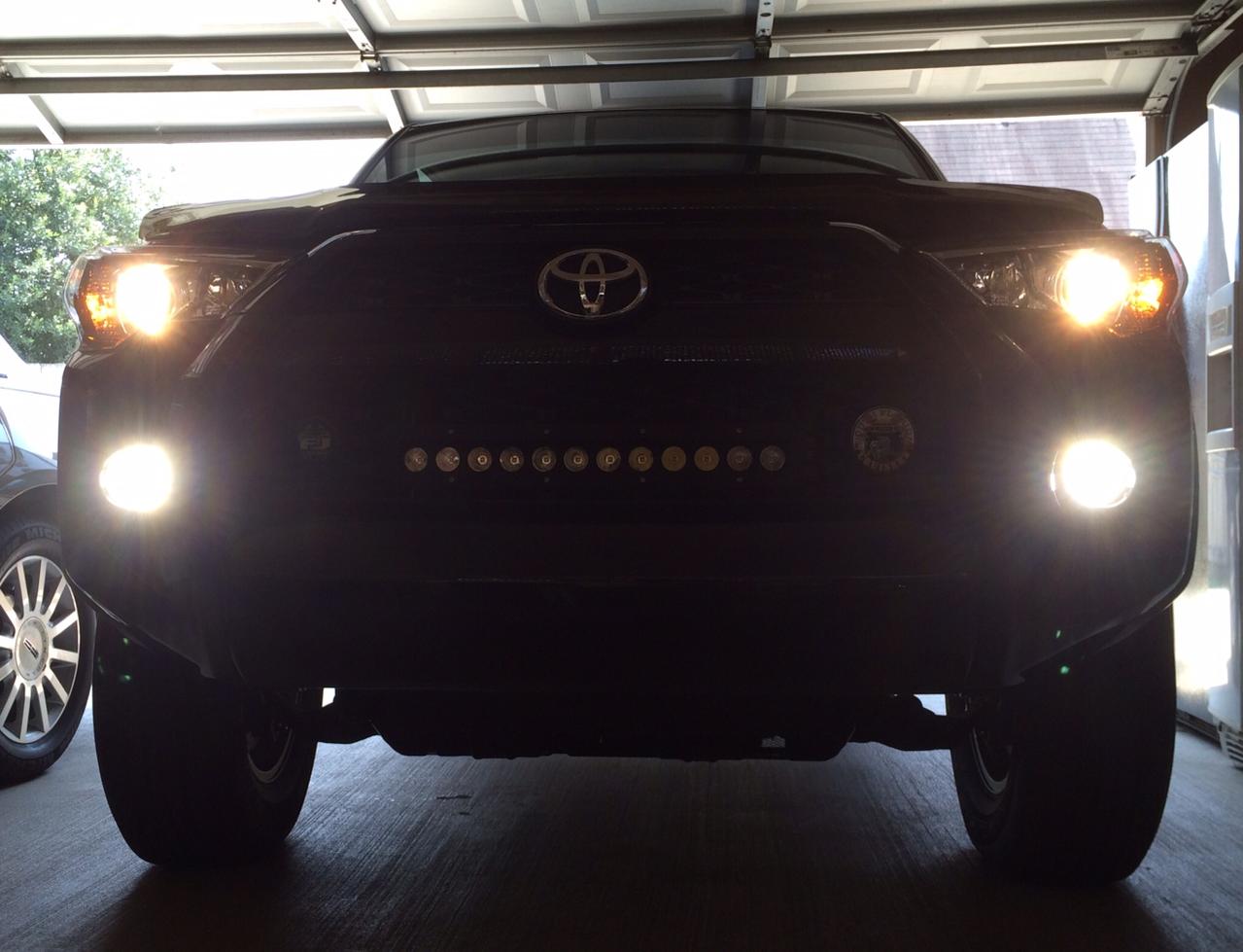

Installed Morimoto XB LED Fog Lights
Direct Replacement LED Fog Light Assemblies for 2014 & Other 5th Gens

Installed H11 Morimoto Elite HID System
For full description, refer to link:
HID upgrade, which one to go with
August 2, 2014
Installed 9011 HIR Bulbs in High Beam Sockets (2530 lumens ea)
H11-H9 9005-9011 Headlight Mod

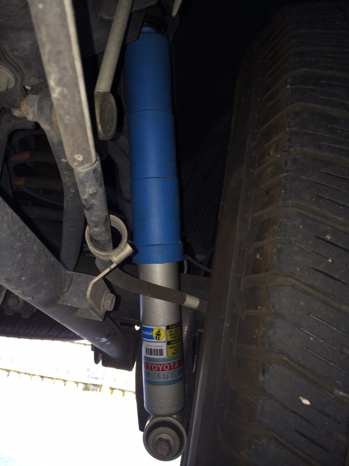

Purchased Parts for Upper Strut/Coilover. 2) 90948-01100 Shock Cushions, 6) 90080-17215 Flange Nuts, 2) 90948-02205 Lower Cushion Retainers, 2) 90948-A2003 Upper Cushion Retainers, 2) 48609-60100 Sub Assembly Support… Items purchased for Install of 6112 Bilsteins.
Ordered Bilstein 6112 Series Shocks (46-227294) & 5160 Shock Pair (25-227661)
March 19, 2015
Rec'd Bilstein 6112 Series Shocks (46-227294)
March 25, 2015
Rec'd 5160 Shock Pair (25-227661)

Installed 5160 Shock Pair (25-227661)
April 7, 2015
Installed Wheeler's Front SuperBump Bumpstops & Bilstein 6112 Series Shocks (46-227294) & Aligned Front End

Enjoying the 6112's & 5160's.
Ride is nice and soaks up the harsh bumps and handles nice on the road and off road.
So much better than the OEM Tokico's and even better than the TRS/Bilstein Off Road Suspension I have previously installed from a FJ Cruiser.
I can't compare to 5100's but understand no comparison there as well.

What notch did you end up with on the 6112s? Also, looks like you kept the rear stock springs? The 5160s give a bit of height?
Sweet rig!
The sliders look great. I have stock Trails that will be replaced by these... Nice!
Sweet rig!
Thanks!
3rd notch on the 6112's gave me 2" lift in the front.
No spring change in the rear, and no height difference with the 5160's.
