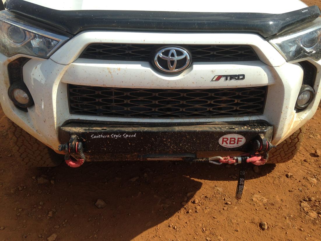

Nice. Kevin is good people. I spent a good 45 minutes talking with him at the Jambo last weekend, got a decal to put on my bumper, and he remembered me from the bumper installation last October.
