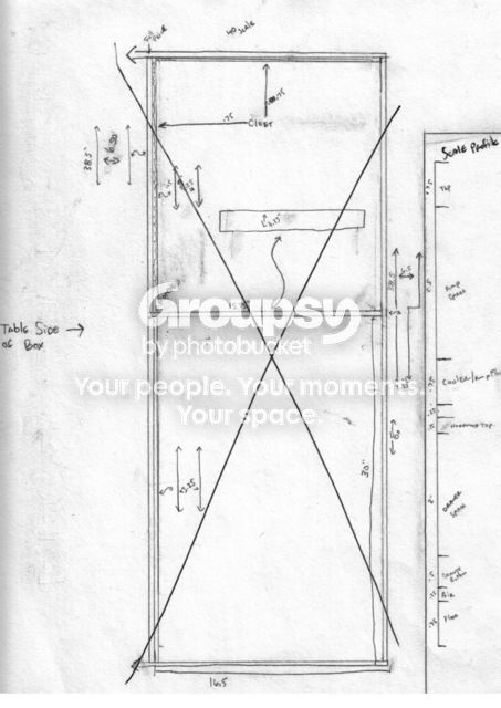

As I had the drawings going, I ran across an Igloo cooler at SAMs that I ended up buying so my dimensions changed a bit, as the cooler was longer, wider, and taller (LOL). It is Igloos version of a Yeti or Pelican.
Here are some photos of the progress, I apologize that I had a gap in the build where some photos that could have been taken weren’t.
First Concept:
Generic space usage
I planned on having the Amp elevated so the drawer/table would slide underneath, but once the new cooler came into play I had to relocate the amp all together.

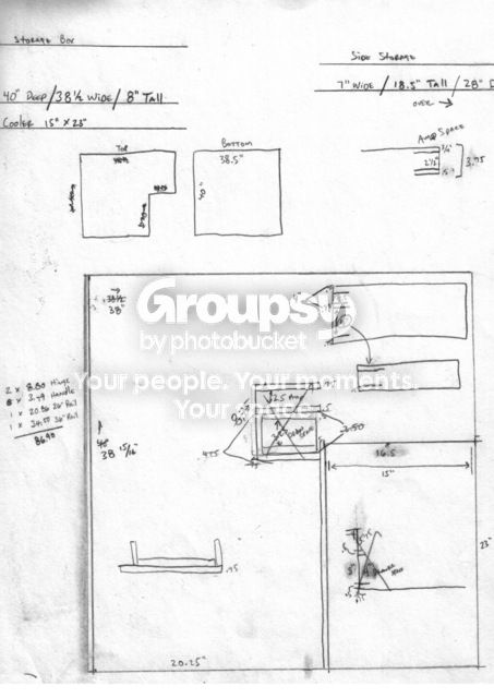

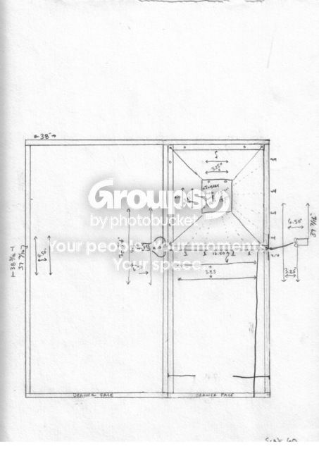

Second Concept:
Drawer/Table Profile:
This profile was to the 1/8” due to needed 2” drawer height and still keeping it as low as possible so mu cooler lid will lift.

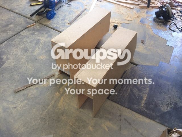

Build Photos:
Here is the photo gap…I didn’t take any of the cut and assembly of the side boxes.
