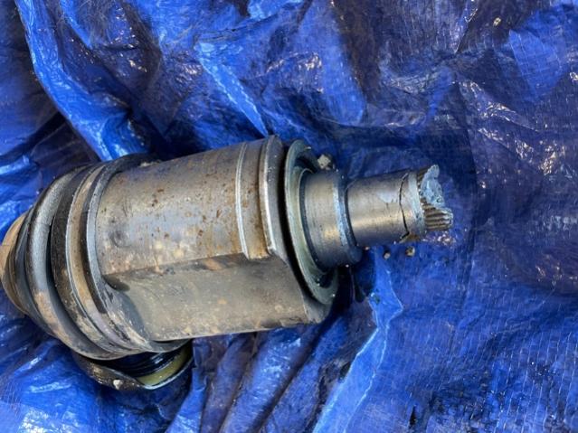

After breaking off the shaft of right side CV inside the diff I think I'm finely ready to do a SAS, even got the wife to agree. Got a lead on a Dana 44 that's ready to go.
So my question is, who has used any complete (or complete as possible) SAS kit that's available and would recommend it? My sons and I will be doing this job ourselves in the garage. So I'm looking for a complete as possible link/coilover kit.
