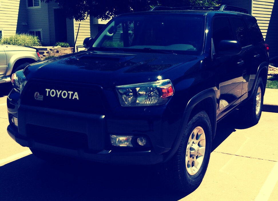

fun quick project. finished mine last night.
