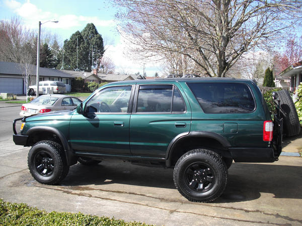

So I'm thinkin about pulling the trigger on some savage sliders with kickout. Does anybody know if they play well with the black SR5 Flares and more importantly the infamous front mudflaps?

Heres a pic of the flares/flaps i am curious about.
Thanks!

This is what I plan on getting. Strange. I have an sr5 but bigger flares w/o the cuts in the doors.... I wonder if mine were switched early on....
The limited style flares were an option on the SR5, or as you said they could of been added/swapped later on. My runner didn't come with any flares from the factory and then my dad put limiteds on soon after buying it.

I have the Savage sliders (no kickout though), with the SR5 fender flares. The rear flares needed trimming, even with my non-kickout sliders. I can't comment on the front mud flaps, since I never had them. But my assumption is that they would need some trimming as well.
Here is a photo of how I trimmed the rear fender flares:
As you can see, I cut the flare just enough to clear the sliders. It seems most people just hack off the whole bottom section of the flares.
It looks like you'll have to do some cutting. I have a '96 Limited and had to cut the front and rear fenders. I know you have a SR5, but it looks like your front flap and rear fender stick down quite a bit. Nothing a cheap dremel can't fix.
I agree about the cutting. You'll have to make a decision if you want the Savage sliders on there. They're 68" long and welded at a 20*angle from the frame pipes. IIRC, you should have 2.5-3" clearance from the tires in front and back (depending on tire size).

Nihkon, thanks for that pic. It really lets me know where the rear flare ends up. Full chop with kickout but thats ok, i dont mind losing the rear. The front is what i care about most. i'm speculating its probably a no-go on the flap.
Im torn, ive always been a function over form guy, and that favors ditching the flaps. BUT, here in the Pac NW where it rains (a lot) the flaps really do keep a lot of road spray and mud off the sides so...
I dont wheel a lot, maybe 6 times a year and nothing super technical, ill definitely use the sliders but not nearly as much as the flaps.
Maybe its time to reconsider my options, ive heard the 4xinnov sliders are a few inches shorter and might work better, they have a kickout too but dont come all welded up like the savage do.
From what ive heard stubbs will spec them perfectly based on what flares you got but i cant justify the $500 those would cost.
