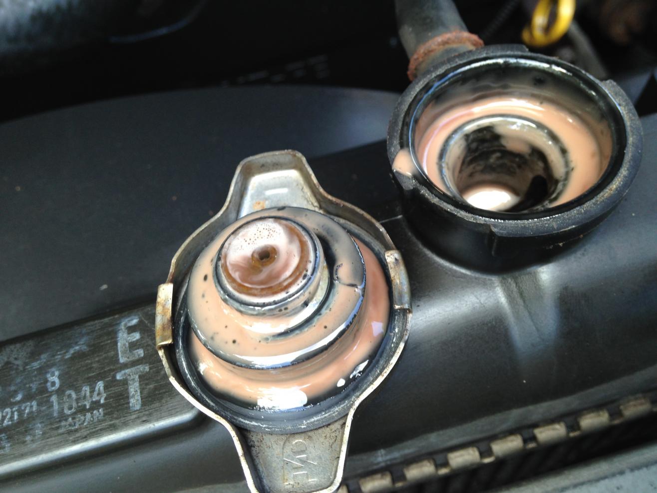

Pink milkshake victim here... I know I know... I said to my son we'll need to swap the rad on this because blah, blah, blah... And sure enough before we got to it, it happened.

Have you tried flushing it yet? If it didn't get driven too long after the radiator failed and it still moves it will probably be able to be saved at least for a few more miles. My brother is still driving a 99 that we flushed out 2 or 3 years ago. I just picked up an 02 that was taken off the road immediately after the radiator failed, still had forward and reverse and seems to be alright after flushing it. When I pulled the drain plug hardly anything came out. I looped the cooler hoses, poured in a quart of diesel fuel and ran it for about 5 minutes. When I drained it a nice thin pink mixture poured out. I filled with dex III and ran it again then put the output cooler hose into a 5 gal bucket and poured in ATF while running the engine. Filled it again, added a Seafoam trans flush/conditioner and ran it for a while. I then pumped it out again and refilled it with fresh ATF. It is now pretty clean and works perfectly. When I get the timing belt finished and install the new radiator I will dump in another Seafoam, drive it a little then drain and refill it one more time. I will also replace the filter once I have determined that there is no more PMS residue in the tranny. If you have ATF in the engine cooling sytem, drain it, remove the thermostat and flush it with a garden hose. Break the center out of the thermostat and re-install it. Fill the engine with water and Simple Green or Purple Power and run it for a while. Drain it and flush it out with a garden hose. If it seems clean replace the radiator, clean the overflow jug, install a new thermostat and fill it with fresh coolant.
4Runner does not move. No forward or reveres.
I wasn't in the car when it happened. My son described it as he felt the trany start to slip and drove a couple of hundred feet to a stop sign then nothing. Radiator overflow threw up all over the engine bay.
