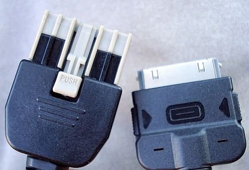

David,
I know you already purchased the t1809, however I found out that the part number IS in fact PT546-21062 and it will work with the t1814. Both ends are 32pin connections but the one that plugs into the back of the head unit is a little more "boxier" than the "rectangular" size of the iPhone/iPod connection that we are all used to. However, what I am finding out is that some of the iPod/iPhones either do not work with the cable at all or they work but just don't charge the iPhone/iPod. If this is the case you will need that extra part, it is called Schoshe or something. I still want the t1814 but I don't know if my iPhone 3GS will work with this cable. I dont care if it doesnt charge it but as long as it works on the music side of things I will be happy. Here is a pic of the cable:
