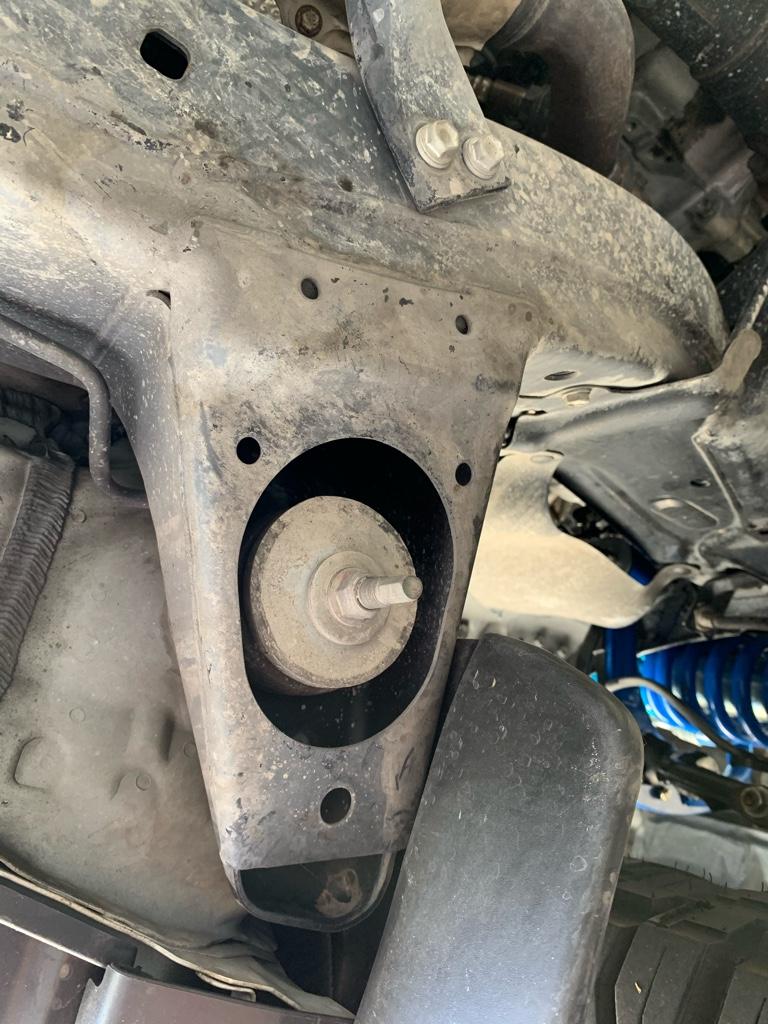

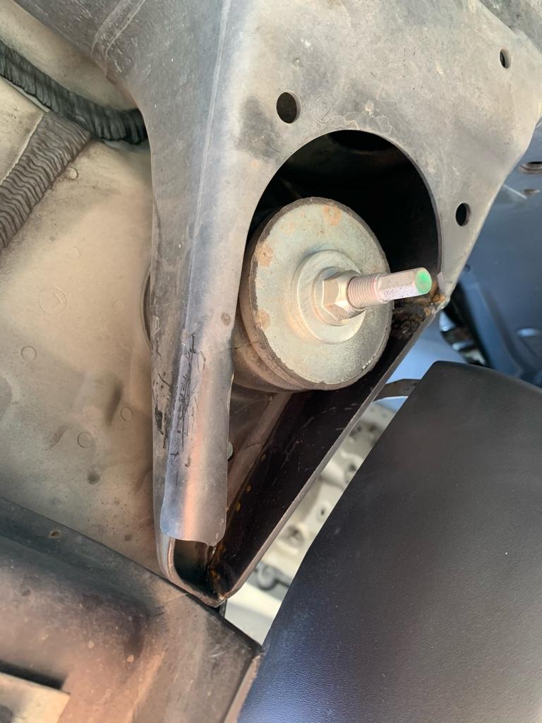

Here’s a comparison of stock body mount vs bmc. You can see how chopping gives you that much more space. The bmc picture also has a cut out on the flaps.
Oem body mount
Body mount chop
Mud flap cut out
That's a very different BMC, why did you leave the length of the BM and not cut the end off back to the bushing? That is where most all of the rubbing occurs.
These are not my pics. It’s a local guy who got bmc and also has -38mm wheels w/ 285/70/17. He claims no rubbing at full lock reverse. Only the stock bm is mine.

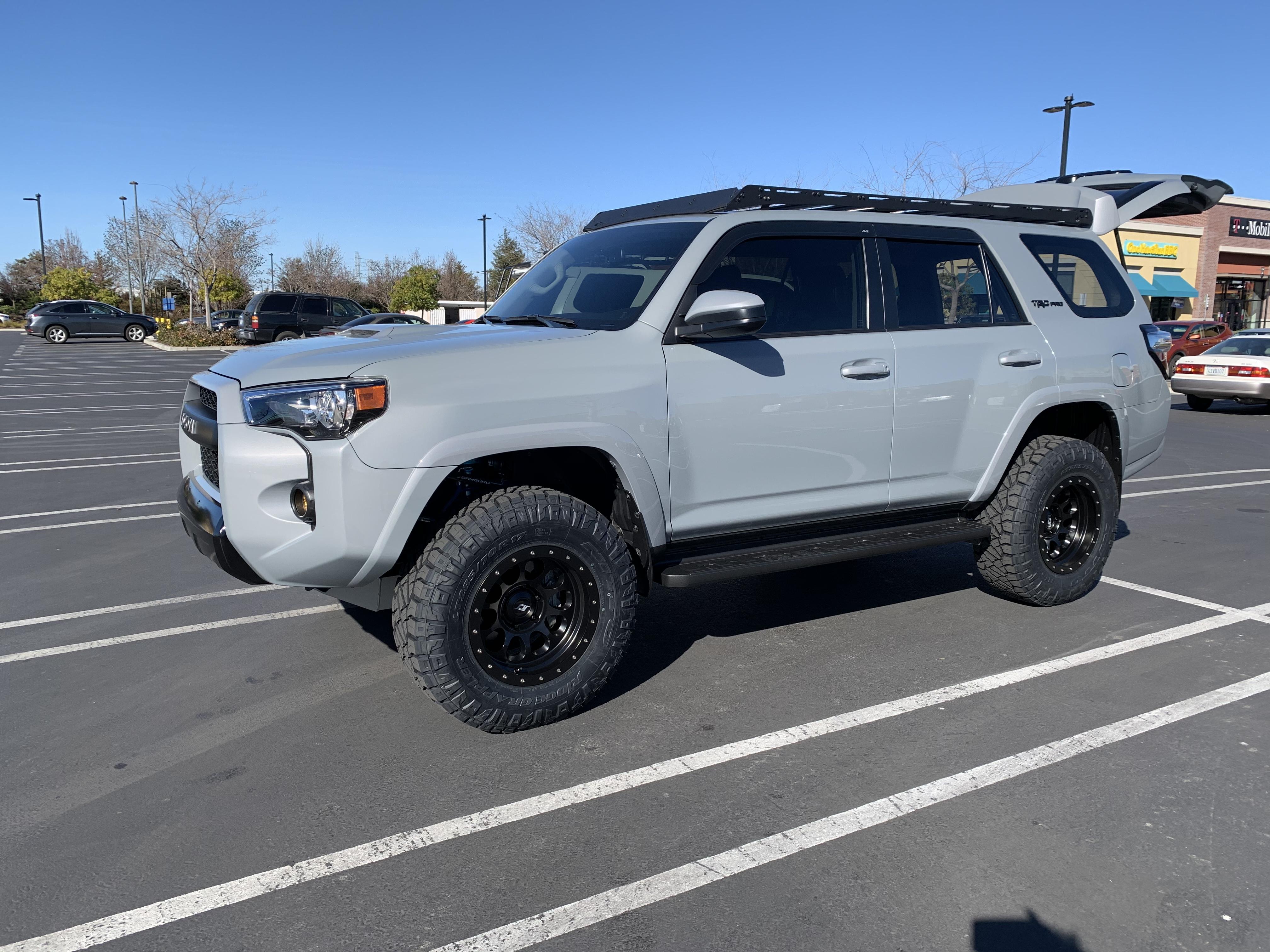

Ok, so here is my feedback on -38s and 295/70/17 on my '18 TRDP
Swapped out my TRDP wheels and 285s and moved up in tire size, here is what I've experienced so far
Mods:
1" level spacer up front
Removed mudflap

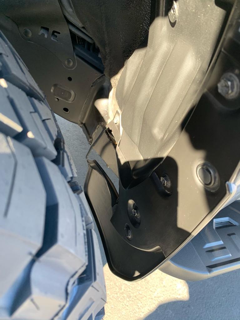

Fender Liner Mod
Normal driving is a relatively no issue, the only rubbing I have is on the front bumper, just need to trim it 1/2" and it'll be fine. No rub on the BMC at full lock (no articulation), but it just barely hits the rocker valance at a very specific point.
Again, this was just driving around town and normal driving conditions.
