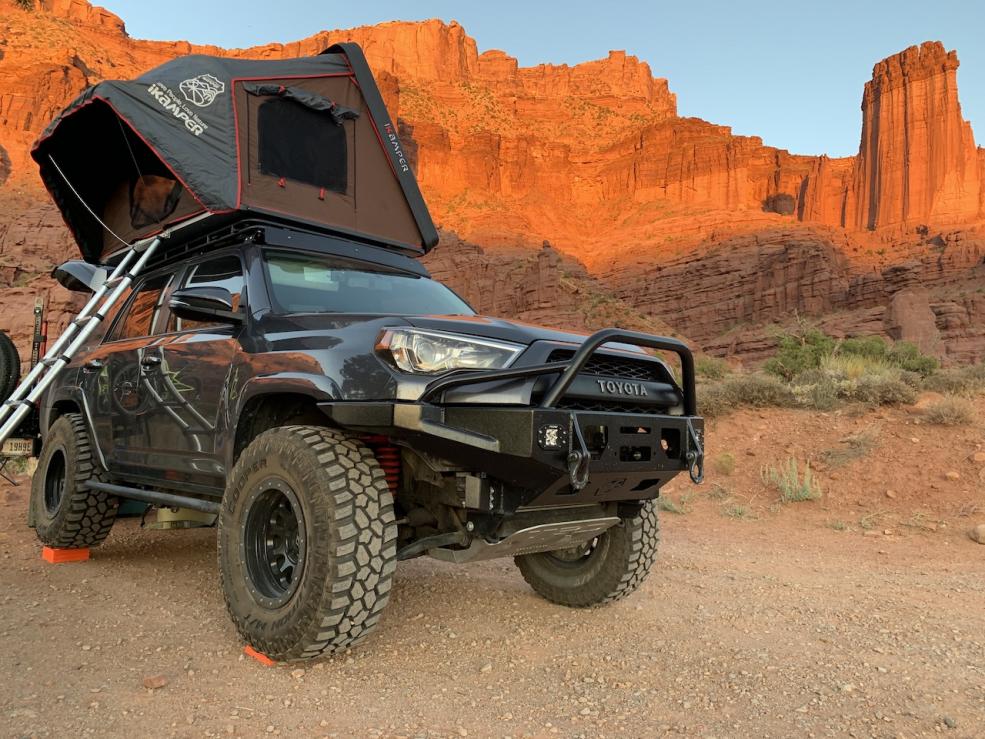

SCS ray10 with -38 offset
Very nice! What did you do to fit 35's?
Cut everything! BMC, trim plastic/fender, more aggressive BMC, trip plastic/fender again, relocate windshield wiper fluid reservoir, new front bumper that allowed clearance in the front, -38 offset to keep tires off of the UCA's, UCA's to offer better caster, 1" BL, etc. And I am still touching on aggressive turns/offroading on the BMC plate and fender so probably more cutting in the future. 35's make you work for it :)
