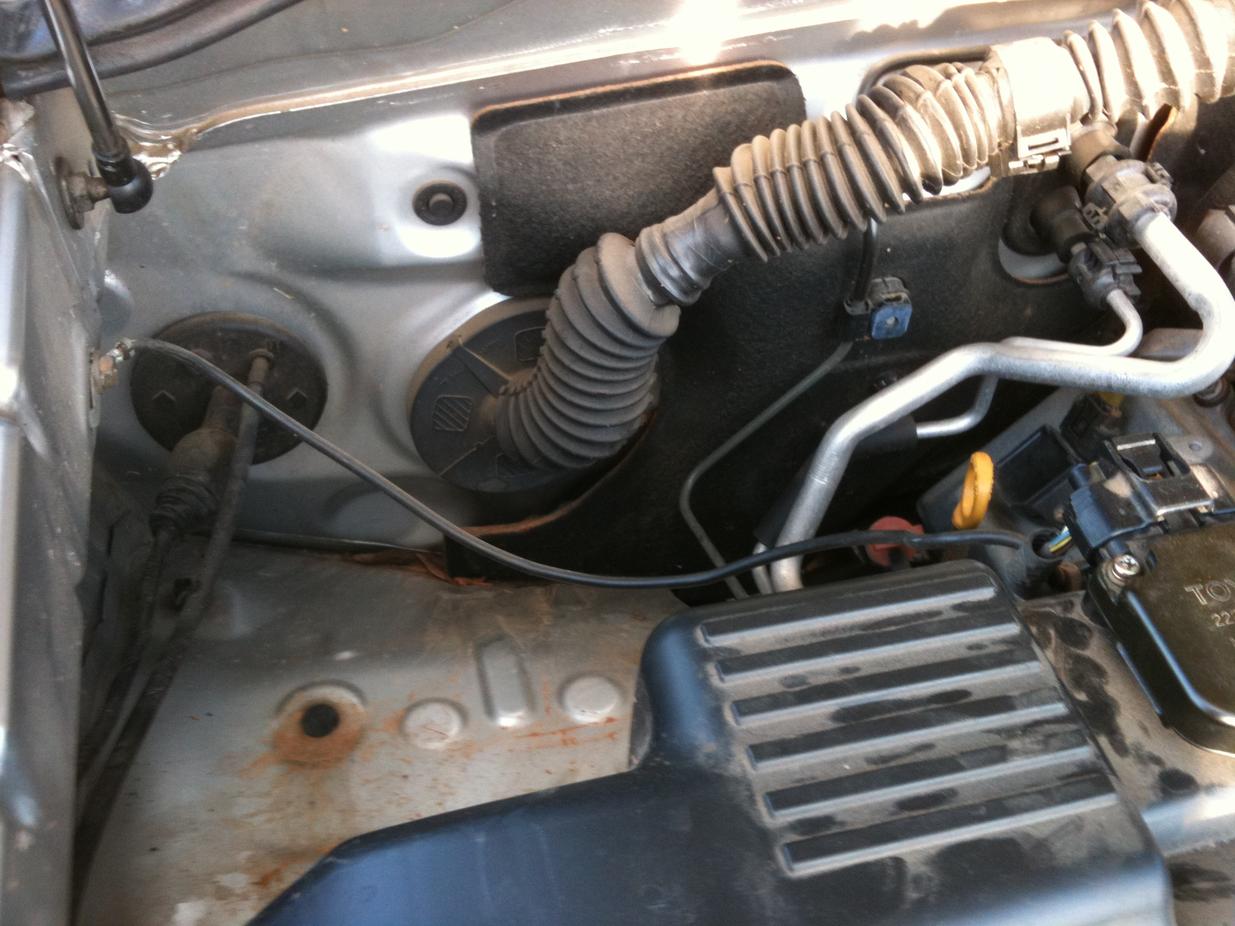

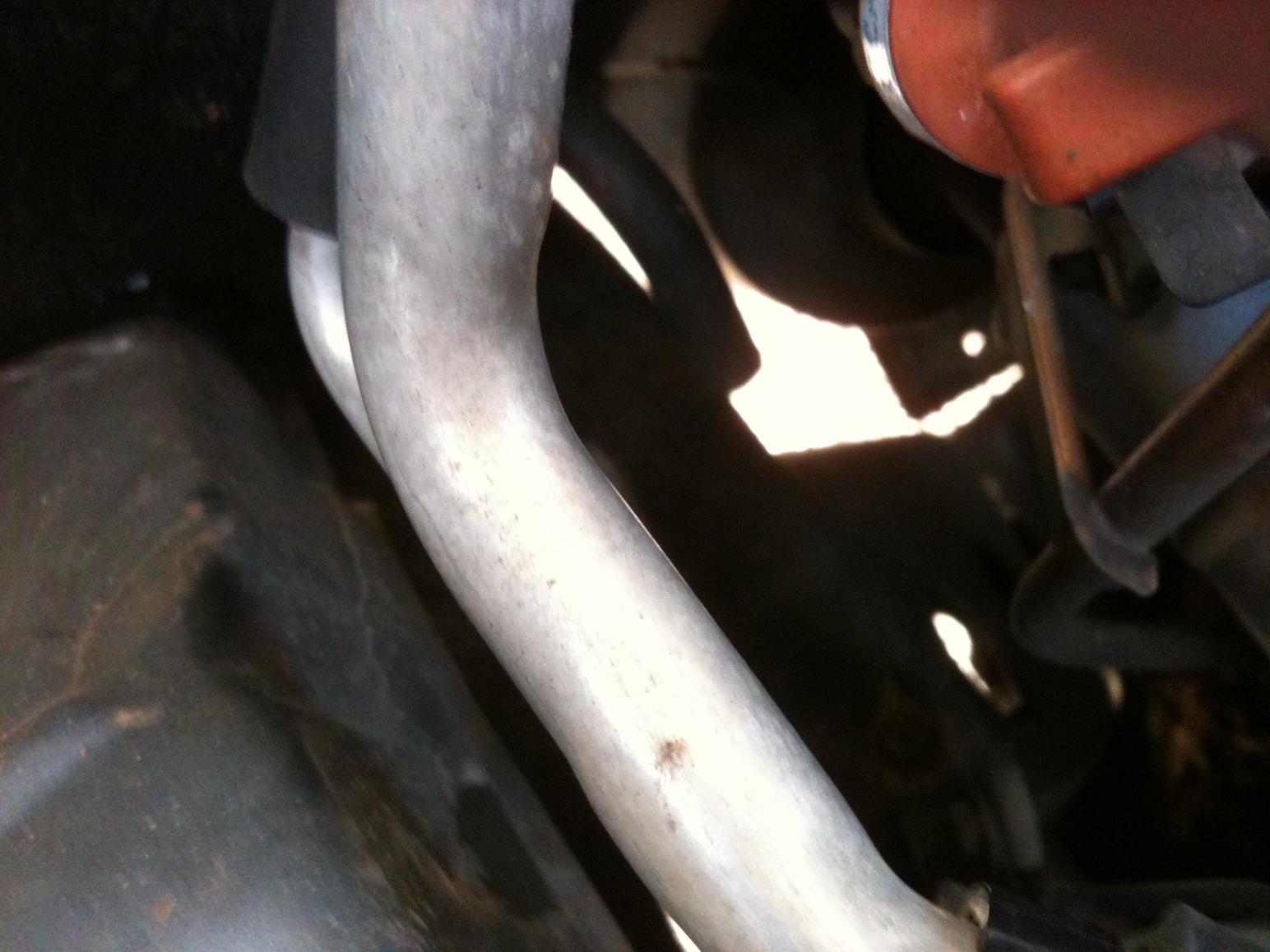

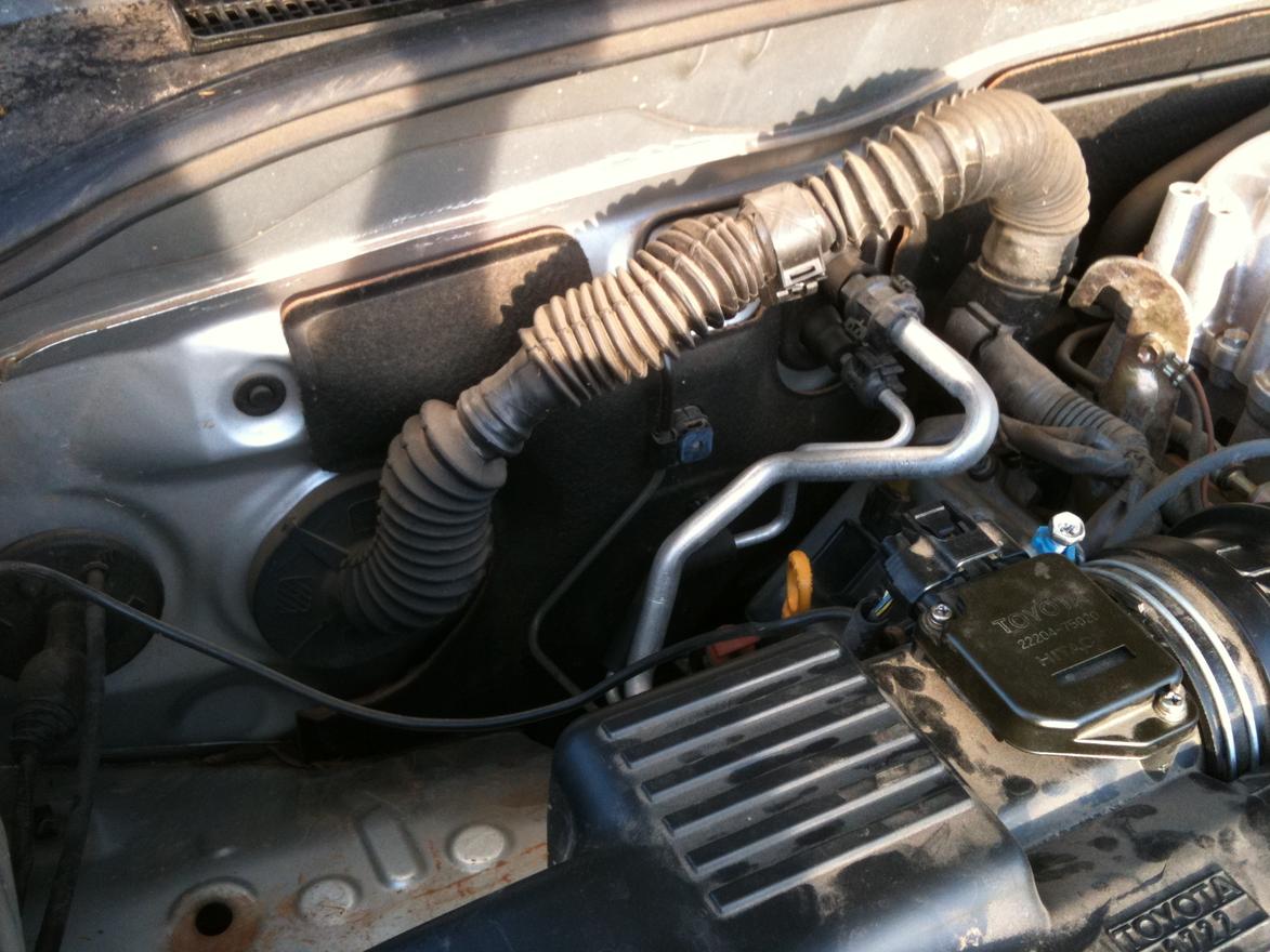

I took some pictures under my hood of a hose I found dangling near the oil dipstick... what does this go to? Look at the 3rd pic. It looks kind of like a breather hose, but no breather plug is present. Maybe it fell off or maybe it's supposed to be like that.

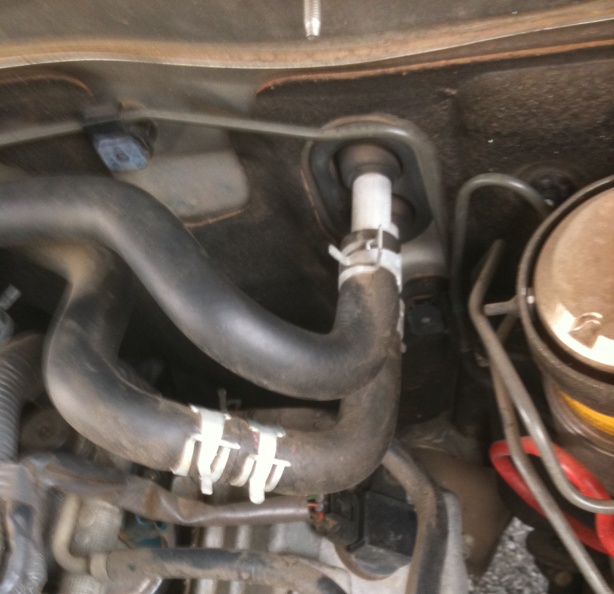

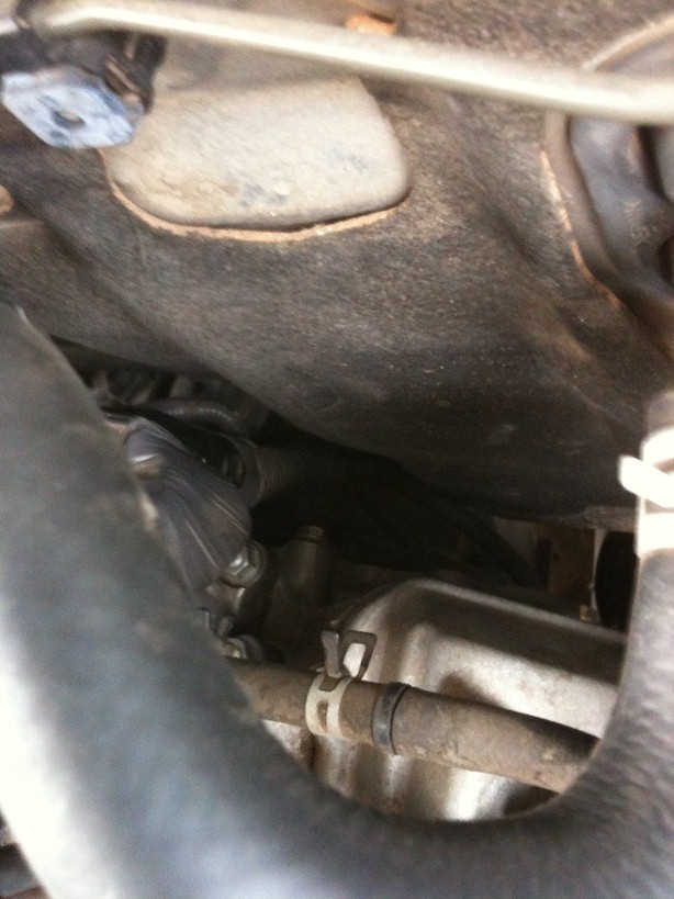

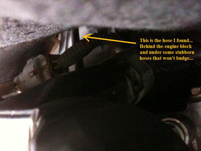

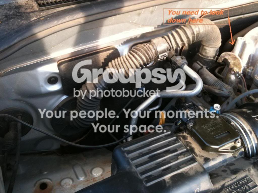

Well after countless efforts to find these breathers, I think I have them in sight. Although I see a hose that I believe is one of the breathers, I can't get my hands to it. I stood on top of the engine and unscrewed some bolts that I thought would give me access to it... no luck. Also tried reaching it from underneath... which didn't give me enough space to reach that high. I'm about burnt out on trying to extend those bas****s!!

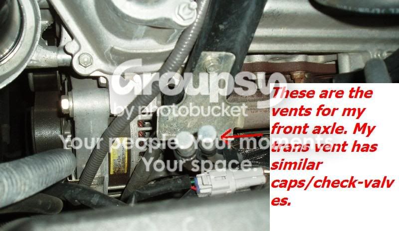

The breathers are very easy to locate (if they aren't missing) they are located about mid hood on the driver side of the engine, look for the L bracket that is mounted with two hoses w/breather caps. I found them in about 1 minute of looking.
The Rear diff breather is located on the top side for the diff. If you remove the spare and go under the rear end it's pretty easy to spot also.
V8's only have one breather on the drivers side engine bay, which is the front axle. I got the rear diff already... the transfer case and transmission breathers are what I've had trouble with. I can see 1? of them, just can't access it. It's in the very back of the engine bay, about a 1 1/2 ft down. I gave up on extending them until I can get my truck on a hydraulic lift or something.
