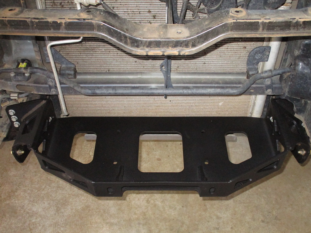

Here's the SDHQ kit. Same as the prior version, except they sent me the directions for a Tacoma by accident. Didn't really need the directions since I've done this before! The powdercoat also appears to be a more matte finish than the semi-gloss from the previous model.

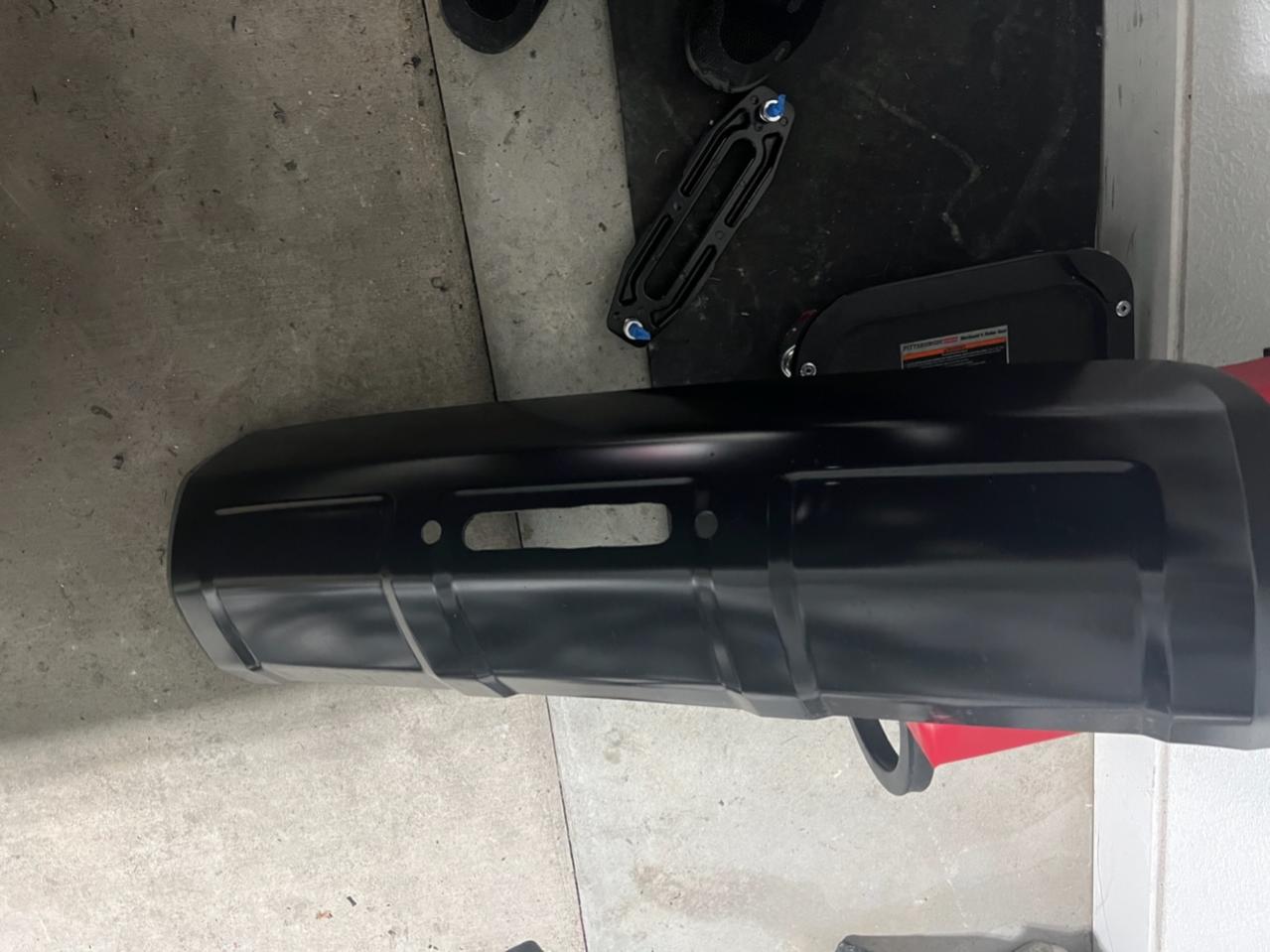

First step is to remove the front bumper skin and then separate the fascia, easy to do. Watch the video linked in the first post of this thread. By now I can remove the bumper blindfolded and in about 3 minutes!
Remove the aluminum OEM sub-bumper with 8 14mm bolts. When you do, keep the steel outer ears. We'll use a piece of them again since the ORP install has one glaring issue!
Starting install:

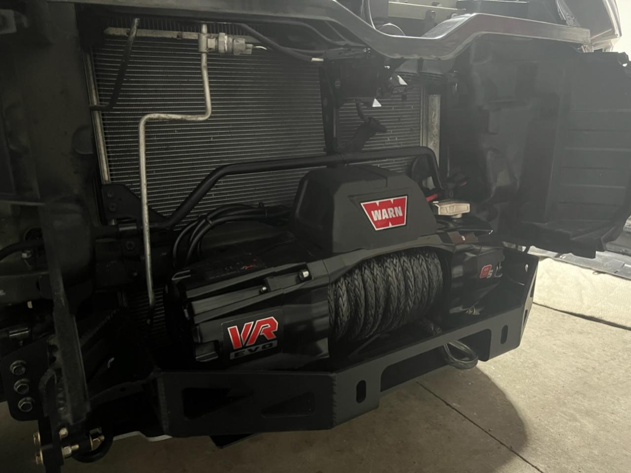

Winch (minus control box) bolted in:
It's a little tight... but the clutch does clear the line:
You also have to bend the AC line slightly:

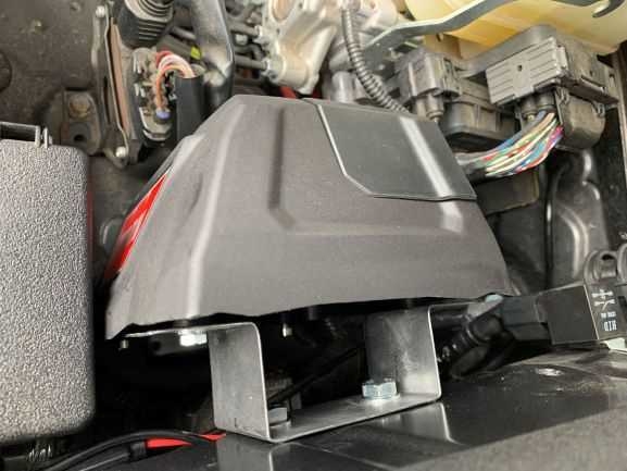

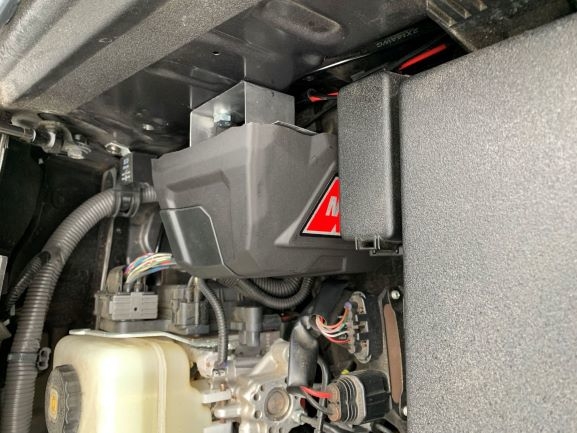

So on the 2017 SR5 install I had a LED bar above the winch that interfered with the control box, so I had to move the control box. On this one, I don't have that LED so technically there is enough room for the control box on top of the winch. Only problem is that the PS line (I think it's the PS line) runs right through there. I decided to raise the control box an inch to clear the line. First I wrapped the line with a bit of old motorcycle innertube:
I replaced the bolts with longer ones (I believe they are M4x30) and put a 1" spacer over the two front bolts to space the control box up. I used a old Tacoma front mudflap, the ones that go in front of the front tire that no one knows the purpose of, as a rubbery baseplate to keep the control box from banging around since it won't be bolted down on the back.

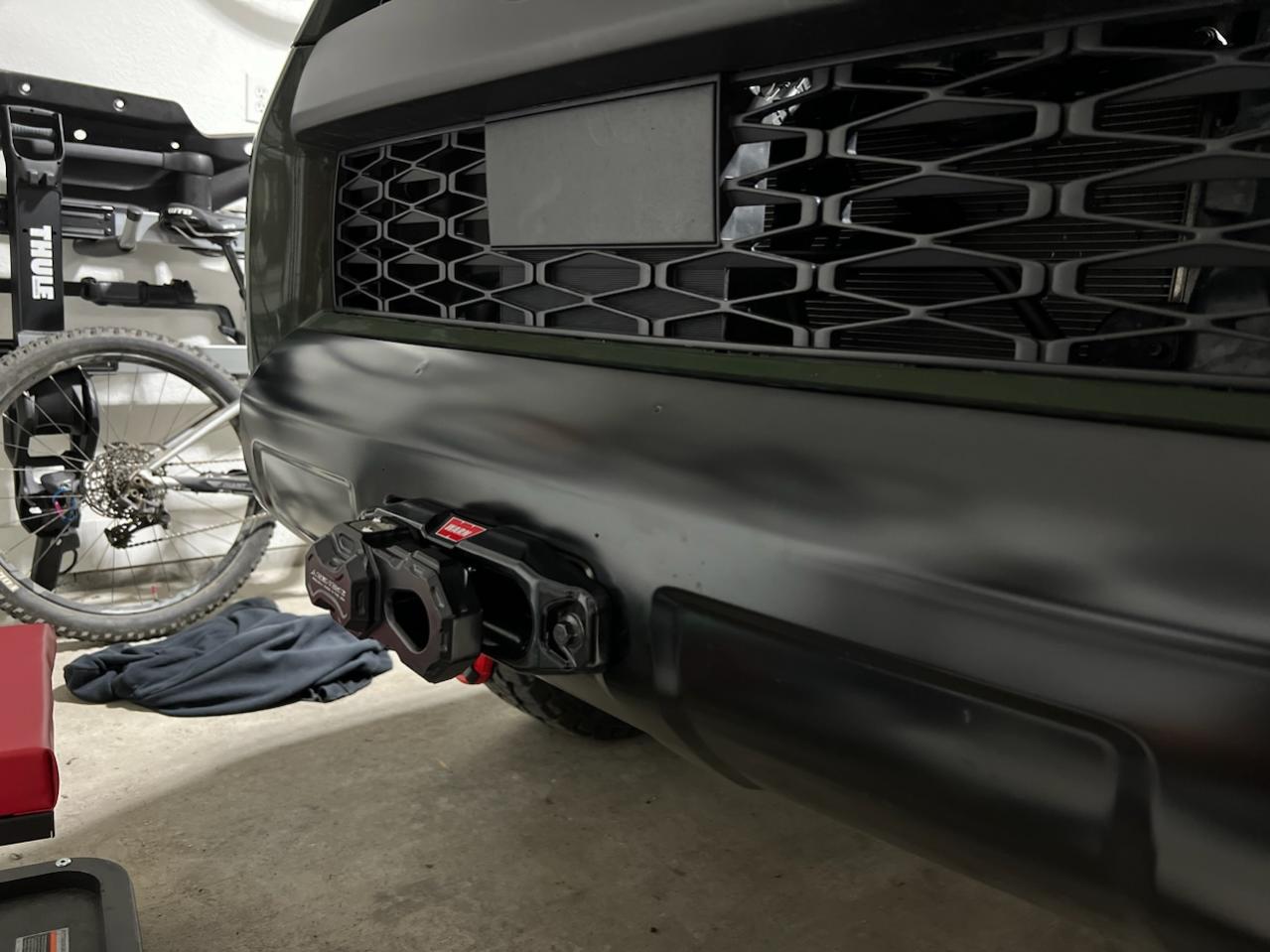

Okay, remember above I said there is a glaring issue for ORP installations (or Trail / OR / PRO)? The issue is, if you want to have the fairlead on top of the bumper skin, instead of in the bumper and trimming the skin around it, you have to bolt in spacers under the fairlead to act as a standoff between the SDHQ bumper and the fairlead. You cannot access the back of the SDHQ bumper to hold the nuts for the fairlead bolts in place once the bumper skin is installed. There is a poster above that has done it, I asked him about it, and his advice didn't work for me. I honestly do not see any way to get an arm in there.

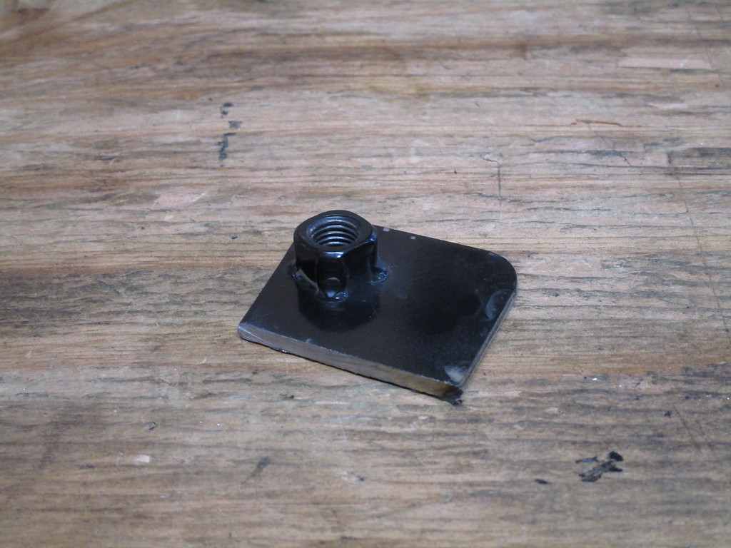

So... I cut off the ends of those OEM sub-bumper ears pictured above. The ears have M10 nuts welded in, and by cutting off about 1.5" of the ear you get a nut with a square backing, that you can drop into the SDHQ bumper. When you tighten the fairlead bolt into that nut, the square backing catches on the bumper and allows you to tighten the bolts.
I painted them before install (shown unpainted):
This is how they will interface with the bumper:
And this is how I'll hold them in place as I'm seating the bolts: grease!

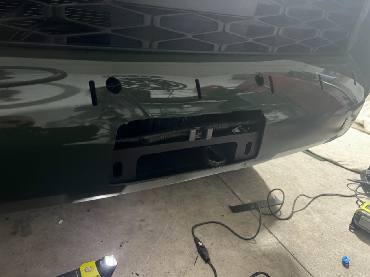

Starting the trimming. This is the part that tears up my gut. You screw this up, it's time for a new piece. The OR / PRO models you can cut the bumper skin in a big rectangle since it'll be covered but you better get the fascia cut right!
This is one ugly cut! Luckily no one will see it after this!
Fascia trimming. I made the holes significantly bigger (in increments) after this picture was taken:
I used M10 bolts for the fairlead and used three 1/2" nuts as spacers (the bolt drops through them and doesn't thread into them).
Home stretch now! Reinstall the fascia to the bumper skin, reinstall the bumper skin to the truck, bolt up the fairlead:
Spacing from above. Pretty flush; I'm okay with it. Better slightly too far off the bumper than too snug against it.

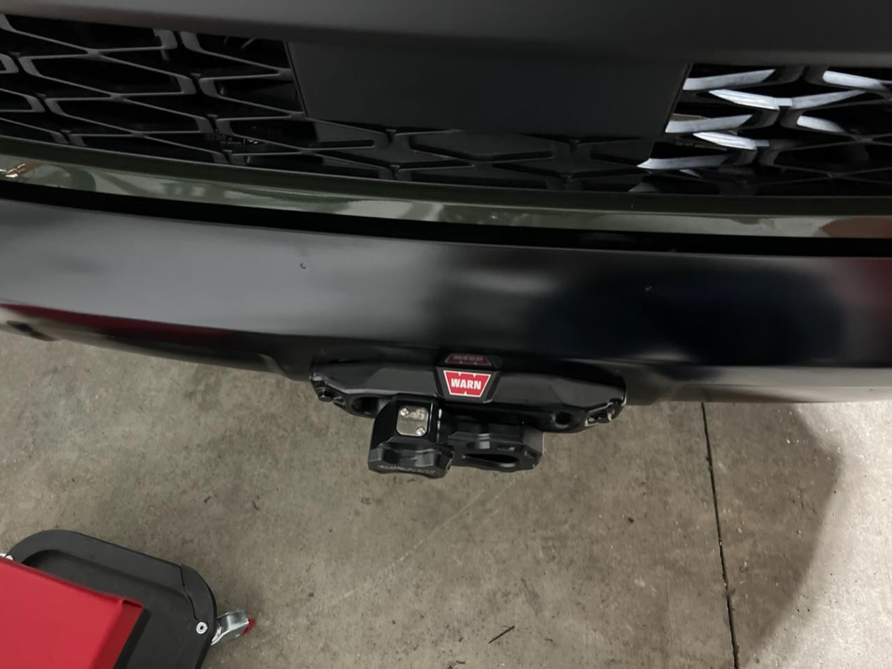

Installation completed with thumb nut to + battery terminal, wire loom on all exposed wiring, 1/4" panel plugs to cover the license plate holes, and Mile Marker thimble:
Smaller gauge red wire is under the nut (not thumb nut) and controls my HAM radio.
Ended up not really in love with the MM thimble, so I went with a Factor 55 Flatlink bought from SDHQ with the forum discount!

Here is my control box inside my engine bay.

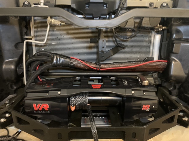

Just finished installing the SDHQ mount and Smittybilt x20 10k on my truck over the weekend. Install was fairly straightforward minus figuring out what to do with the control box. I have the same light bar setup as [MENTION=132734]MeefZah[/MENTION] and followed his lead by mounting the controls to the light bar bracket.
I'll try to get a few pictures of what I did with the front plate and fairlead when I get home later this afternoon.
Any chance you could post what you did with the control box? I have the same setup that I'm installing.

Just got mine installed. Thanks for the advice, the SDHQ mount is sharp, and you can’t beat no lead time. Only issue I had was with one of the welds on the mount that had spilled over into the area the winch sits. Ended up having the grind down the weld about 1/4” to get the winch to bolt up.

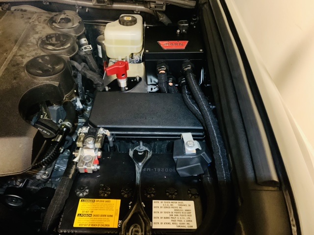

I modified a waterproof aluminum box for the solenoid and wiring and mounted it in the engine bay. Also was able to fit a 500A battery disconnect on the tray next to it. Based on the circuit length and amperage calculations, I went with 2/0 cable. These big cables ended up being a pretty major PITA. Crimping, routing, and general fitment is all just more difficult and time consuming with the big gauges. In the end I think the result was good, just don’t know if I’d recommend running anything bigger than #2 or #3. The winch itself comes standard with much much smaller wires than 2/0 anyway.

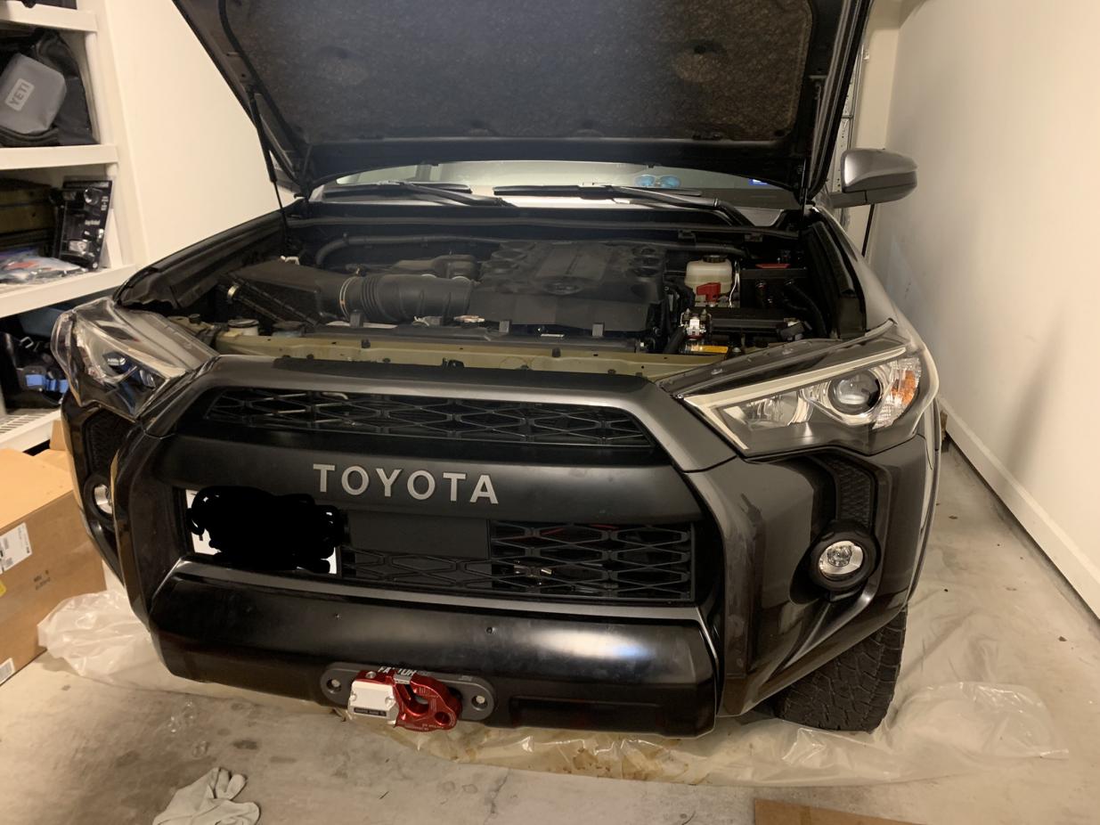

Installed one today in a 2022 ORP with Warn 8VR
Couple things
The template was no where near for me. I do have a 1/2” body lift, and I measured down a 1/2 inch but way off. Didn’t matter as others showed a big rectangle is all you need. I simply marked the holes where they needed to be for the fascia.
I made mine flush to the fascia. I did this using washers to space it out. It came to 13/16” worth
I moved the cooler line up and the winch fit with the control box just fine.
I was able to tape a nut onto a wrench and fit my arm down to tighten the fairlead.
