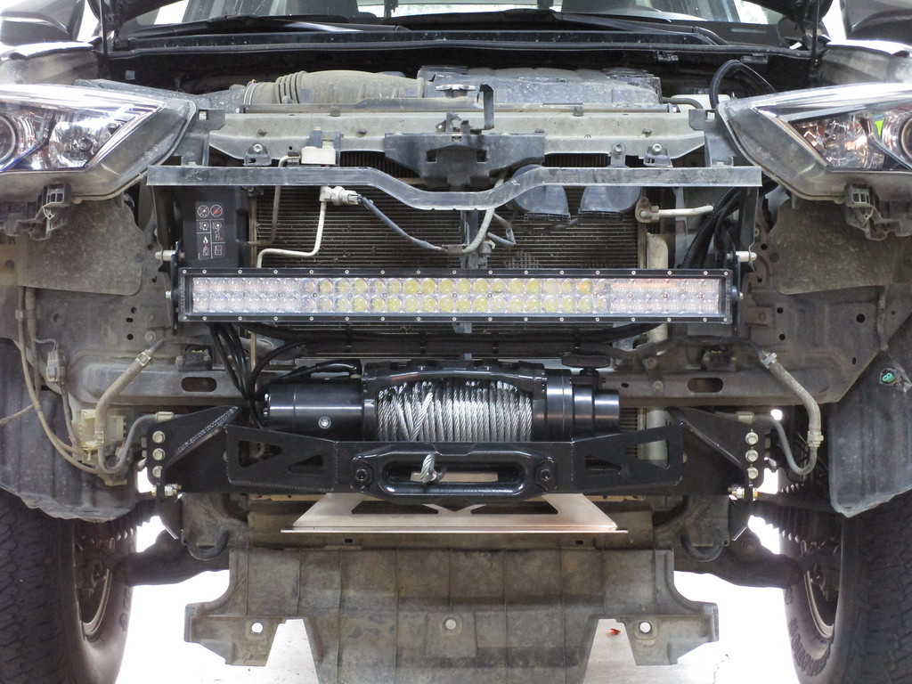

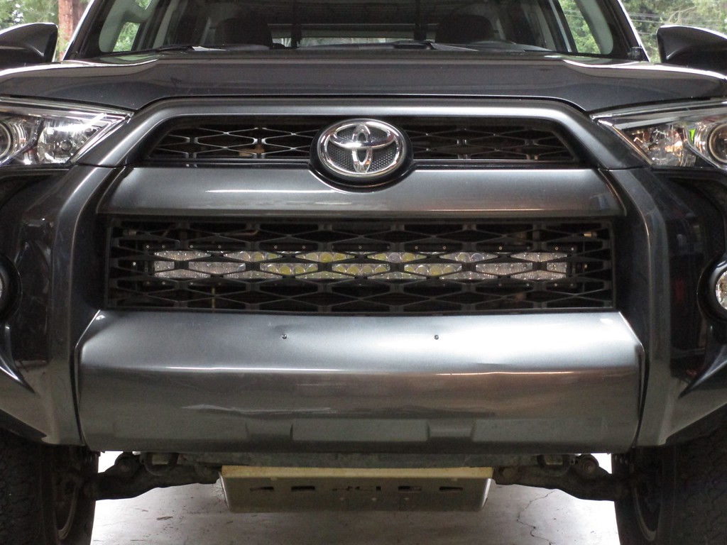

Prior to starting. I also have a CaliRaised LED bar that will need to be removed to have clearance to install the winch; it will still fit but it is in the way for the winch install. I also do not run a front plate. You may also notice the bumper around where the plate should be is a little swollen, for lack of a better word. I hit a sheep in BC last year and the plastic crumpled and then snapped back out. It wasn't worth fixing.

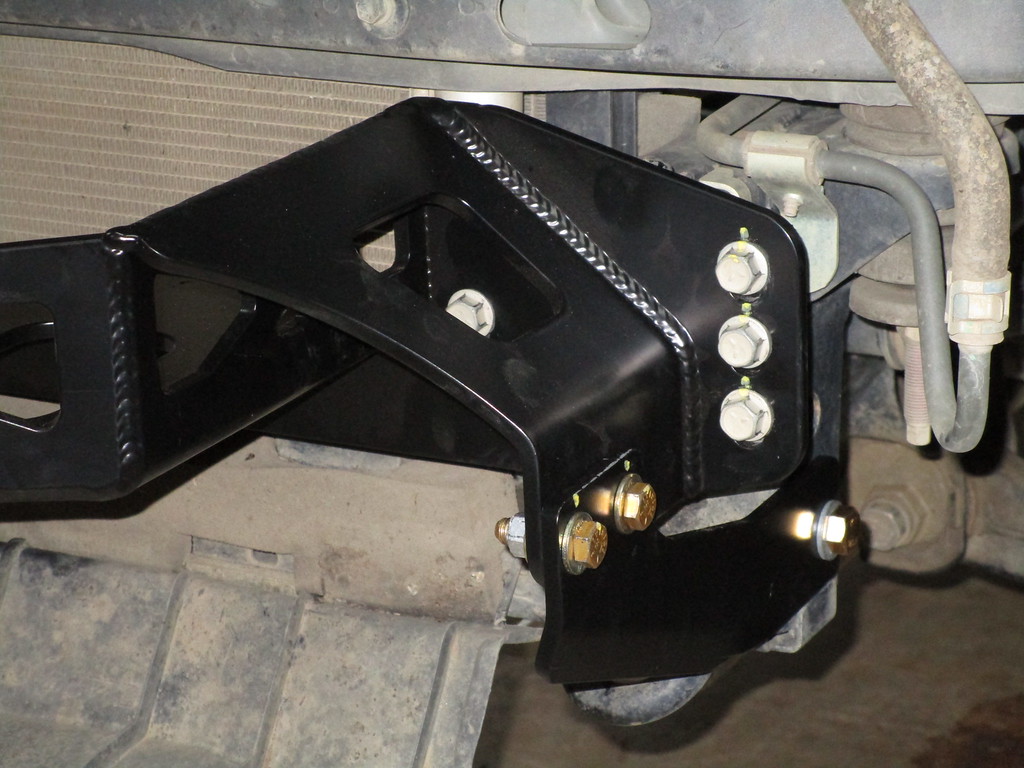

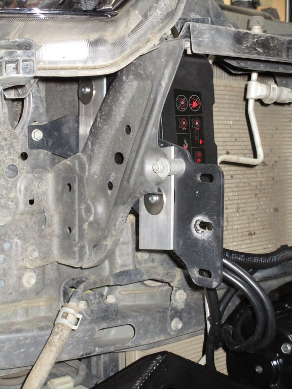

Next the OEM aluminum and steel sub bumper is unbolted with 4 - 14mm bolts (head size) on each side. The plastic skid plate hanging down is the bottom cover between bumper skin and radiator:
Then the winch tray is installed using the 8 - 14mm bolts you removed from the OEM sub bumper.
Side bracing; rearmost bolt goes into an unused and already threaded hole behind the OEM tie down loops:

Removed the LED, installed the winch, moved the control box to the inside of the passenger side CaliRaised LED bar mount. Power steering line DID NOT need to be moved and in fact made a great place to zip power wires to:
Close up of the control box / solenoid box on the Caliraised LED light bar bracket:
LED reinstalled, fairlead installed, optional aluminum bracing for the plastic skid between bumper skin and radiator installed to bottom of winch tray (comes with the SDHQ kit). If you use the aluminum bracing note that the rearmost winch bolts hold it in place. I didn't catch that and had to remove them to install this part and then reinstall them. Also, you will have to source a few bolts and some aluminum flat scrap to make mounts to connect the plastic skid to the aluminum bracing. That is the only thing that wasn't well thought out by SDHQ.

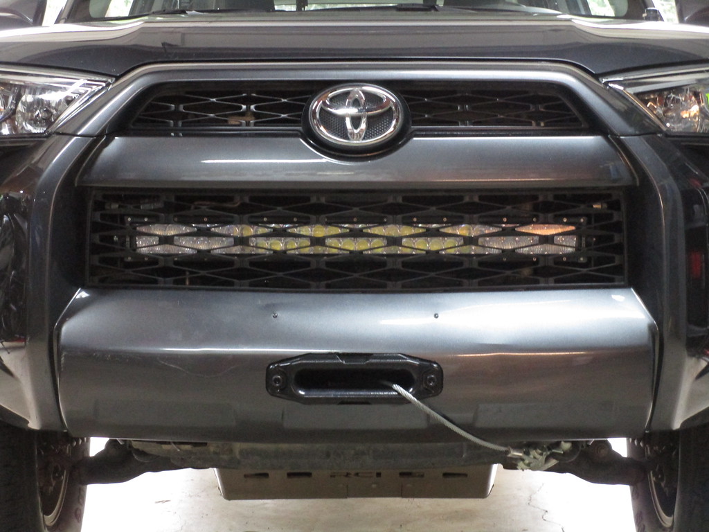

Template (supplied with kit) to cut the bumper for the fairlead. This is the inside of the bumper.
My fairlead was a little differently shaped than the template so I ended up marking the mounting holes, drilling them, then tracing the fairlead on the front of the bumper using the mounting holes to orient it, then cutting with a Dremel, and sanding. It's a mindfukk to cut the bumper but if you take your time it comes out okay.
Pretty rough at first:
Smooths out okay though:
Reassembled:

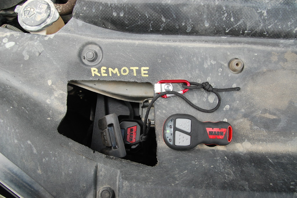

The clutch is accessible through the hole quite easily. I was worried that the LED would be in the way but it's not at all. Hard to see in the picture, but it's right there.
Remote plugs in just under the cover panel, easy to access:

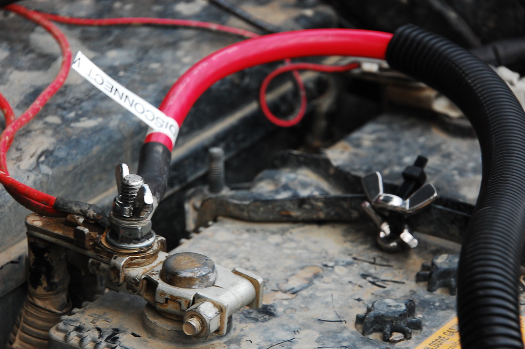

The VR-8 is prewired and you just run one wire to + and one to ground. I installed the ground but am leaving the power wire uninstalled unless I'm actually going to use the winch. I don't have an isolator so this way I don't have to worry about the winch accidentally activating. I added a longer bolt to the battery terminal and I bought 3 thumb nuts to secure the positive cable to battery when I am using the winch (1 in use and 2 spares, since I already can see the thumb nut getting lost).
I also added a Warn 90287 remote, which is pretty boss. $130 and you get 100' of wireless capability in a very small size. Sadly it can't be left permanently installed but it does plug right in with no need to synch it every time. I added a 'P' clip as a tether for it so it wouldn't get lost if I accidentally leave it installed.

Excellent write up. I've been considering the SDHQ mount but couldn't find any posts with anybody who had one. What was the Dremel bit of choice to cut the bumper?

you should use some weather stripping to clean up your cuts, other than that good job on the installation instructions.

Thanks. The bit was just the high strength cut off wheel.

I considered that. I still might. It would involve pulling off the bumper again because there isn't quite enough room to do it as it sits, so right now laziness has prevailed.
Dammit, it really started bothering me. I used the excuse that I needed to check the torque on the bolts to help justify pulling the bumper off again.
You were correct, it is much better this way.
Nice, that looks great! What did you use?

Thanks. Just door edge trim. Dropped it in a bucket of hot water for ten minutes to soften it up to bend the hard corners and used a hair dryer to mold it on after the bumper was reassembled.
