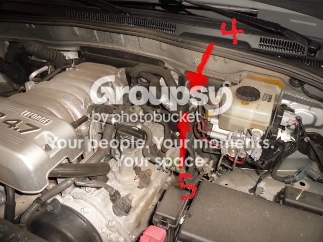

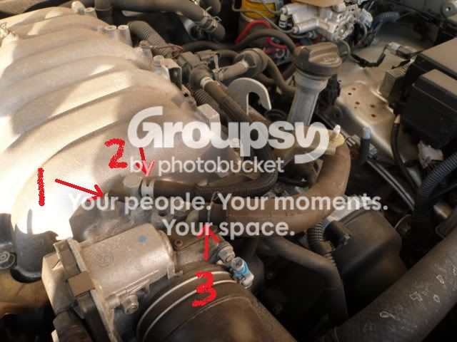

Maybe it will be easier like this
Wich one you guys use when seafoaming your 4.7L ?
1 - 2 - 3 - 4 or 5 ?
Thanks

I used # 2 when I had my V8 also but I did not get a lot of smoke like people say. I figured it was because I put Seafoam in the tank every other month and I run premium gas.
I have not done it to my V6 but I still put it in the tank and use premium.

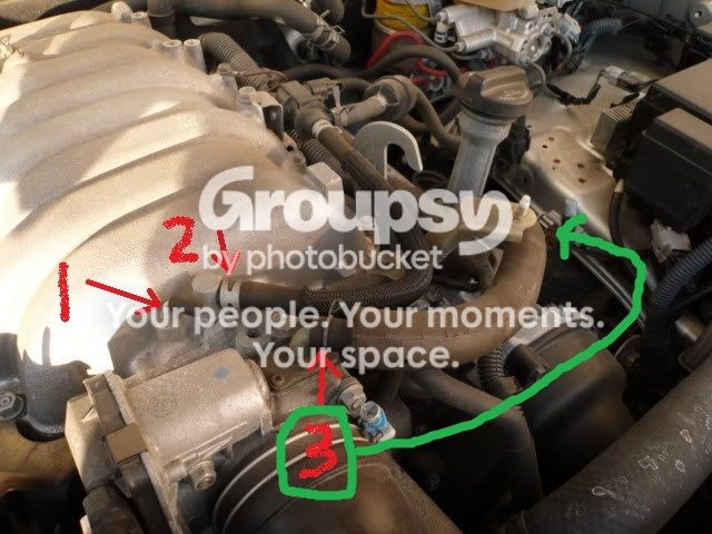

I use the other end of #3. 1/2 bottle in the vacuum line and 1/2 in the tank. I let it soak for 10-15 minutes, take it out on the freeway for ~40 miles, change the oil, and lastly disconnect the battery for 10 minutes to reset the ECU.

I did go as recommended with the other end of hose #3 and there was a pretty hard suction there.
I did as shown on many youtube video ... 1/3 in gaz tank, 1/3 in motor oil and 1/3 in the vacuum hose !
I did see immediate result the motor was more ''prime'' and the sound has changed a bit. for 10$ a can and 30 minute total to perform it was a very good investment ! will do more often
Thanks again
if ever that can help somebody else in the future
As recommended by UteRunner I used the othe end of hose #3 from the picture with good results
