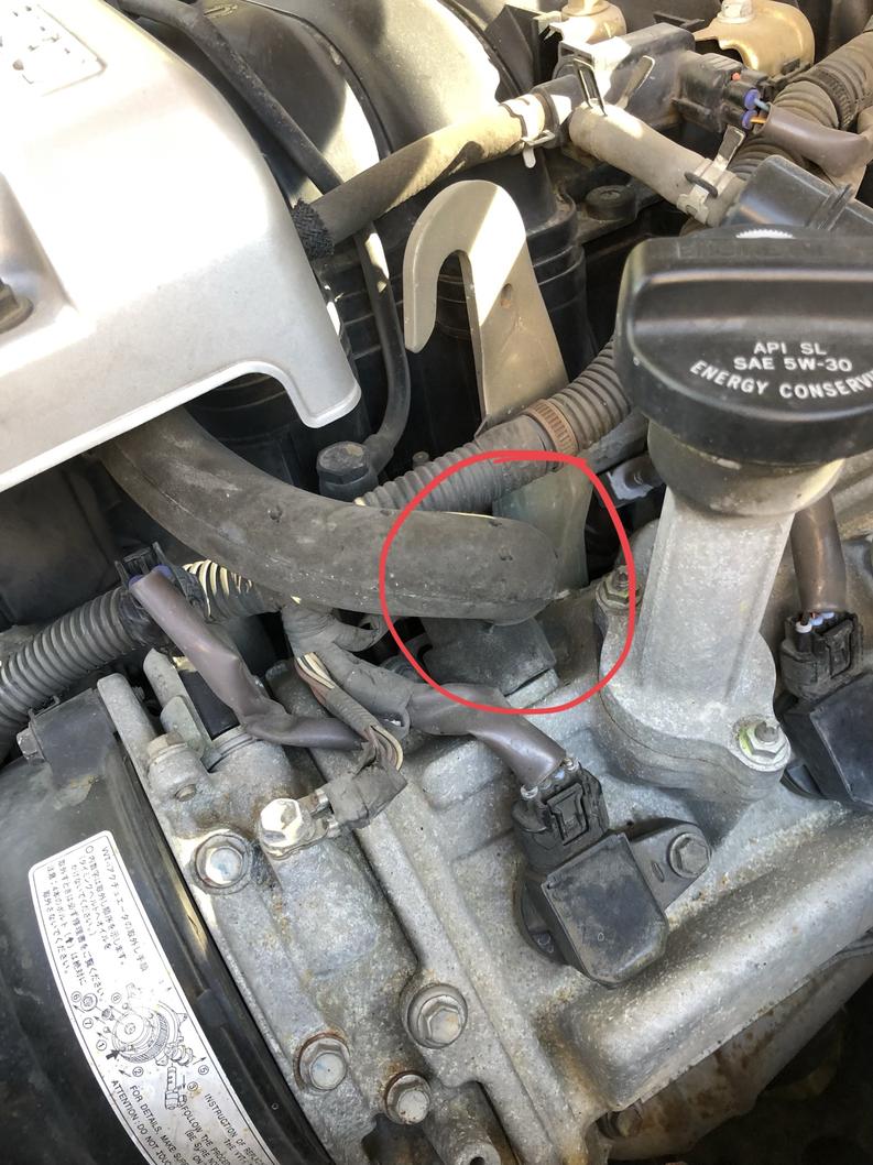

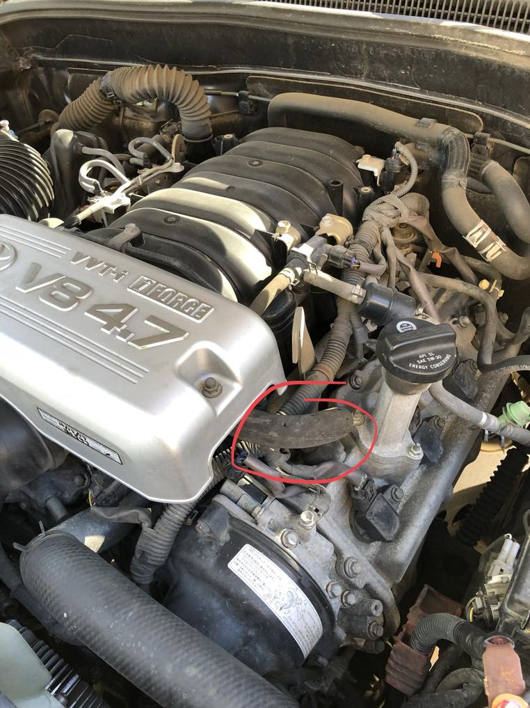

I put mine in this vacuum line. That is the only major one that I see on the vehicle. I just popped it off while the car was on and let it suck up the sea foam then shut the car off for 10 minutes. It’ll have some trouble starting up since there is that additive in it, but once you give it some gas you’ll see all that seafoam coming out through the exhaust. It worked like a charm.
