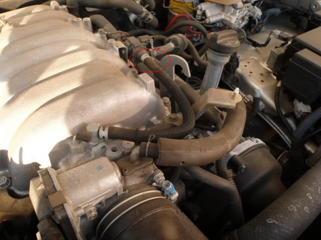

Ok I have run seafoam in many vehicles but all of them had brake booster vac lines to run it through the intake. What is the best intake line to run it through on the 4R V8?

even though you kicked me while i was down i will help you. the intake point is on the front of the manifold on the left hand side. Crank the engine and put your finger over it (about the diameter of a straw) and you will feel the vacuum

I love Seafoam! Might have to do with me being a Rotorhead... lol But the stuff works well enough to warrant use here and there. In reality you just need a vaccum line into the intake maifold, I ussually use the PCV Valve Hose as its big, easy to get to (on most vehicles), but on the 4.7L it happens to be easy to find.
Your PCV Valve is located on the valve cover to the left of the oil filler tube, its a large foam covered hose, just pop it off and use that. Another option is using the long hose that is off the top nipple of the intake manifold (its the only vaccum line on top of the manifold, hard to miss), just follow it to the lil solenoid ontop of the P/S disconect it and use that. (remember to reconnect it when you are done and before driving off.)
Big thing to remember (I figure you already know but I wanted to state it for everyone) when using Seafoam or any other fuel injector cleaner via a vaccum line you will need to manually accelerate the vehicle to a high idle or at least another thousand rpm. Don't be afraid to rev it high some because you don't want to stall the engine and flood it. (Though there is a method of using Seafoam that you intentionally flood the engine, but the OP is not using that method) I also reccomend some spirited driving afterwords (and yes by spirited driving I mean drag race that bad boy!) to burn off the excess. I like to use about have the bottle in the vaccum line and the other half in the gas tank.

After watching videos on seafoam and seeing people completely fog out the neighborhood I figured I'd give it a go. So I bought a can of seafoam and drove to an empty parking lot to try it out.
I pulled the vaccuum line shown in the photo, it had suction and was going into the intake so I figured it would be OK.
I followed the directions on the bottle, 1/2 in the throttle body, 1/2 in the gas tank.
RESULTS: Not even 1 puff of smoke, no difference in drive quality. Maybe I did something wrong IDK. Seeing as my 4runner has 90k miles I figured I'd at least get a little bit of smoke but nothing. It did idle down a little bit when I added the Seafoam for about 10 seconds but other than that nothing happened.
