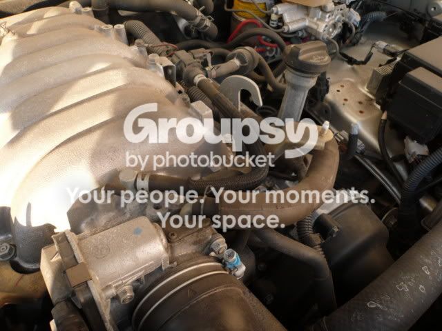

Picture from the thread:
Engine2.jpg~original

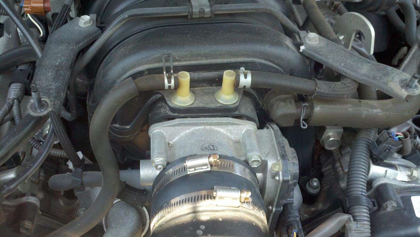

When I opened up my hood, I found this and I'm not quite sure where to induce the SeaFoam:
Pull the hose off the PCV valve (on the driver's side valve cover) and use that one for the seafoam.
Take a few more pics of your engine bay. I would like to see what is going on there.
It is slightly different because your 4Runner is an '05+, starting in 2005 Toyota began using an updated 2UZ-FE engine with VVTi, as you can see, there is a redesigned intake plenum, throttle body, ect. its not too much different from the older engine, but some hoses are in different places, ect.
The foam wrapped hose underneath the hose that comes off the white nipple from the throttle body is your PCV valve hose and will be best to use.
can someone annotate his picture with the correct hose? I've been wanting to do this but haven't figure out which is the vaccuum hose?
blackworksinc. said : The foam wrapped hose underneath the hose that comes off the white nipple from the throttle body is your PCV valve hose and will be best to use.
