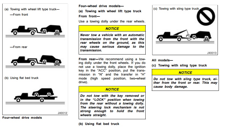

Owner's manual says if you can't use a flat bed to tow it from the rear and use dollies on the front wheels. If dollies on the front wheels cannot be used, then turn the key to ACC (leave it in while towing) and put the transmission into Neutral and the Transfer Case into High (2Hi).
Not sure if that helps really as they don't explain how you're supposed to keep the front wheels straight (make sure you figure that out, had a vehicle that was towed incorrectly and it snapped the column and ruined the steering wheel)? Here's a snippet of the 4WD Towing instructions from the Owner's Manual I made for you. :)

NO, and I really mean NO. Read the previous post, if you tow from the rear, you have to let the front wheels find their own way or you'll break the column lock! If you tow from the front, you must NOT leave the transfer case in high!
There are two suspension geometry factors that make the steering self center, SAI and Caster. Don't worry, the wheels will follow!
