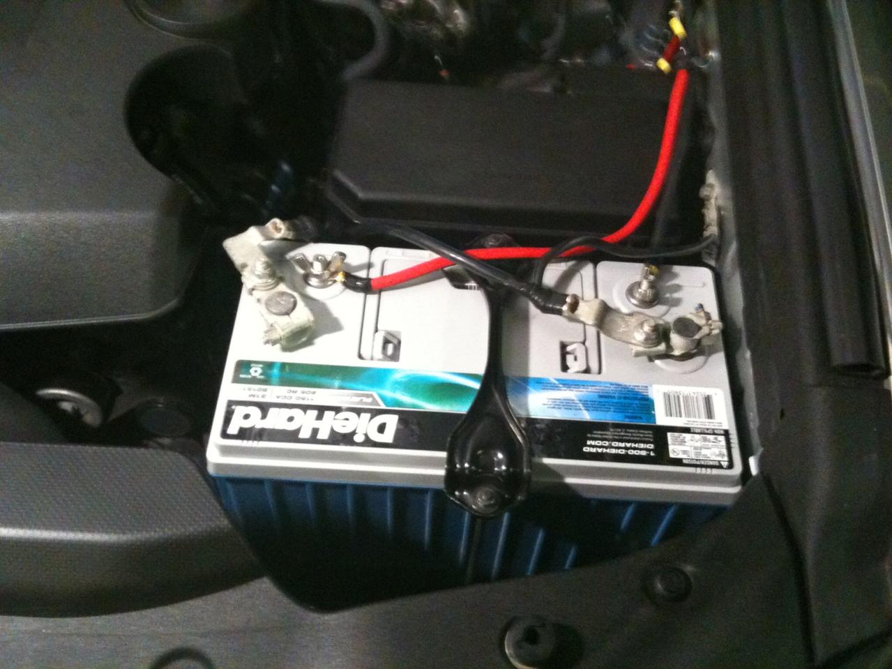

Hi all,
Here is a battery install to a Sears Group 31 Plutinum Series AGM.
I ordered and paid for it online...sand picked it up at the local store about an hour later.....very seamless and simple. At the time it was going for $217....so it was a nice savings, and I'm sure it'll be back there again.
Here's the linky..
Sears: Online department store featuring appliances, tools, fitness equipment and more
First I disconnected and removed the old battery..

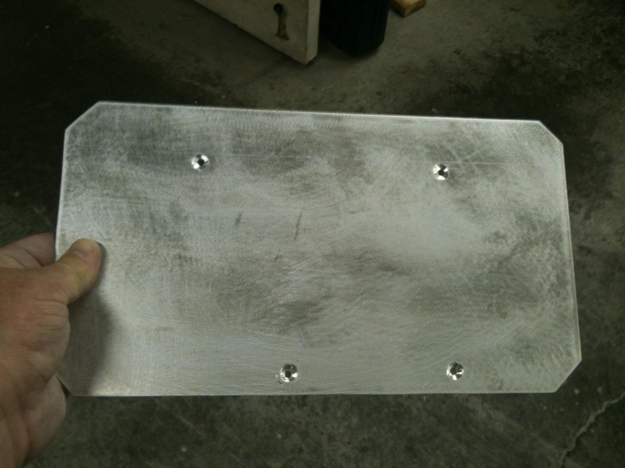

Next I cut an 1/8" thick pc. of aluminum the size of the battery, I trimmed the corners on a 45 degree angle for a nicer fit.

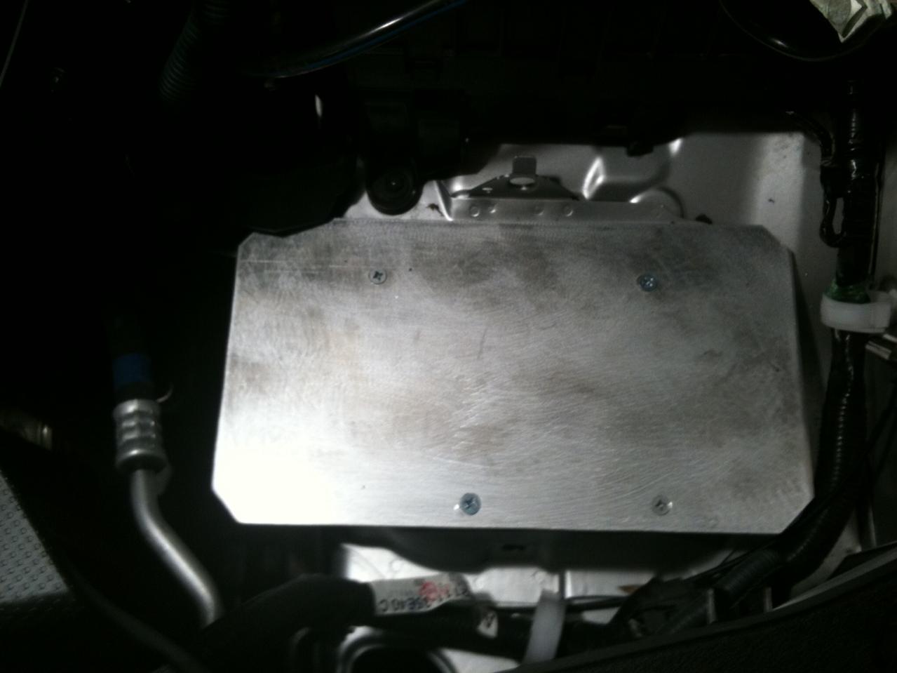

I predrilled holes and countersunk them, fit the tray with self tapping #10 x3/4" flat head screws.
Then I added some rubber, self adherring flashing that I had, to provide some cushion, and help prevent slipping.

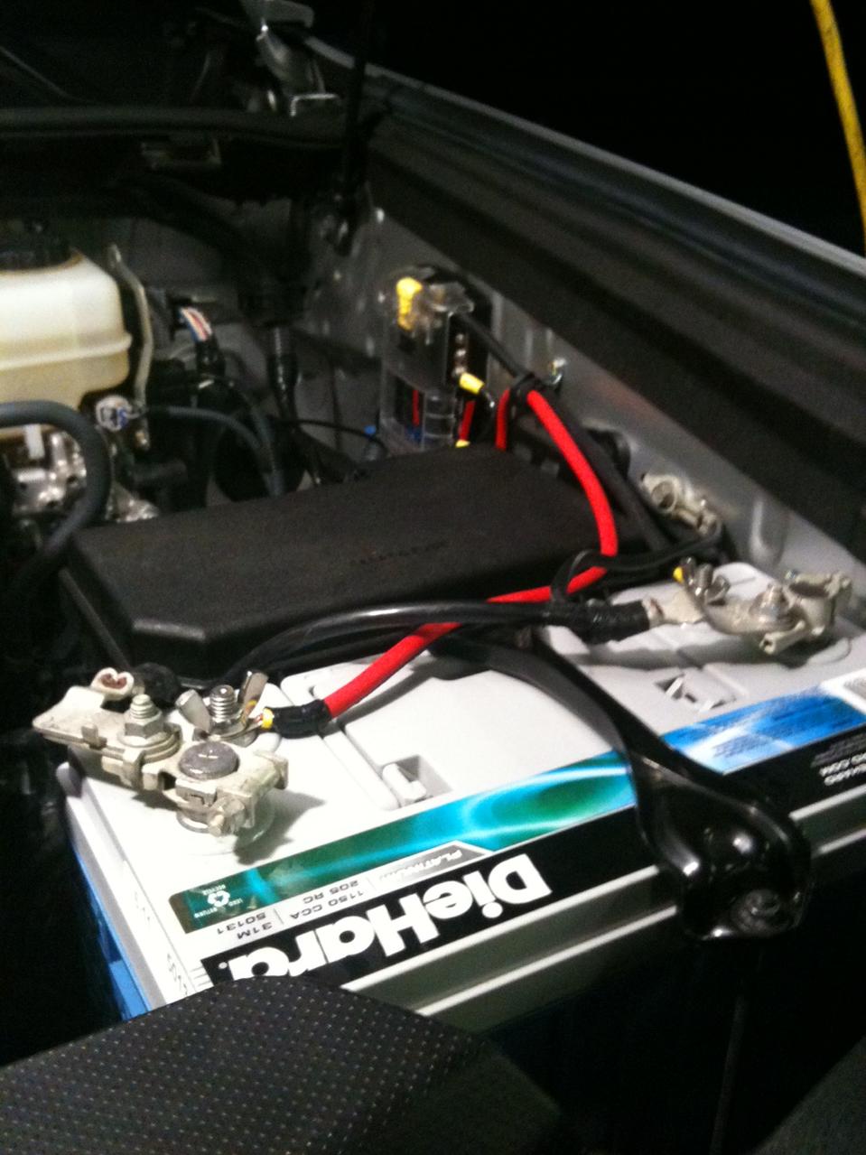

I then re-installed the terminals...they were a bit short, so I bent them stright, and cocked the terminals a bit to side...all things fit and work...don't ask me how in the hell that happened.
Upside to this battery is that it has some nice wing nut posts, for adding extra wiring for goodies down the road...in the last picture you can see the Blue Sea 6 circut ST blade Fuse Box. I went to Autozone, bought a pair of 6#
jumper cables for $21, cut off the ends, and used that to the Fuse Box from the battery...piece of cake.
I did run a 10# wire to rear for fridge plug, so it's nice to have an "always on" socket in the truck. I'm a big boy now...I can manage my own power,,:bash:

Looks real professional. Tomorrow you are going to heat-shrink the bits with electrical tape right?:toilet:

1. You have been using this setup (tailor made battery tray by yourself)? Since you did not use any aftermarket battery tray. Is that secured to have this heavy monster under the hood during this period of time?
2. Have you drive any off-road or bumpy roads, did the battery lose out of its original position?

So far so good with the homemade tray and tons of off roading...no movement at all.

It really was just a piece of 1/8" aluminum cut to fit and drilled to fasten down. I simply cut a patch of rubber roofing for a bit of padding, and to prevent it from moving. The hardest part of the entire install was bending the terminal to get it to reach....it's very close.

how did you mount that bluesea fuse box? do you mind sending some pictures?
