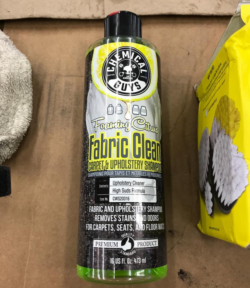

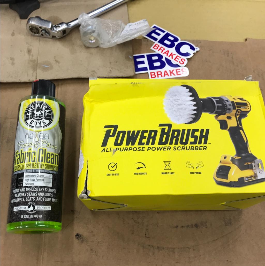

I recently cleaned the lower seat cushions front & rear as well as the rear carpet and used a spray on foaming fabric cleaner from Chemical Guys with a fabric cleaning brush attached to my Dewalt drill.
After using the brush attachment on the seat I used clean microfiber towels and removed the foam and dried the area cleaned.
Repeated the process 2x in areas that were more heavily soiled/stained.
Very satisfied with results.
