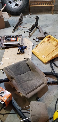

I hope you got some progress done, I stripped a pair of cloth seats not too long ago.
I suppose you could do it in a vehicle if you removed the console and unbolted the seat to maneuver it around in the car. As previous members have said it would be much easier to remove the seats from the car itself. If you want the service manual procedures just reach out to me (I've got the 2002 Service manual), or I can walk you through it.
