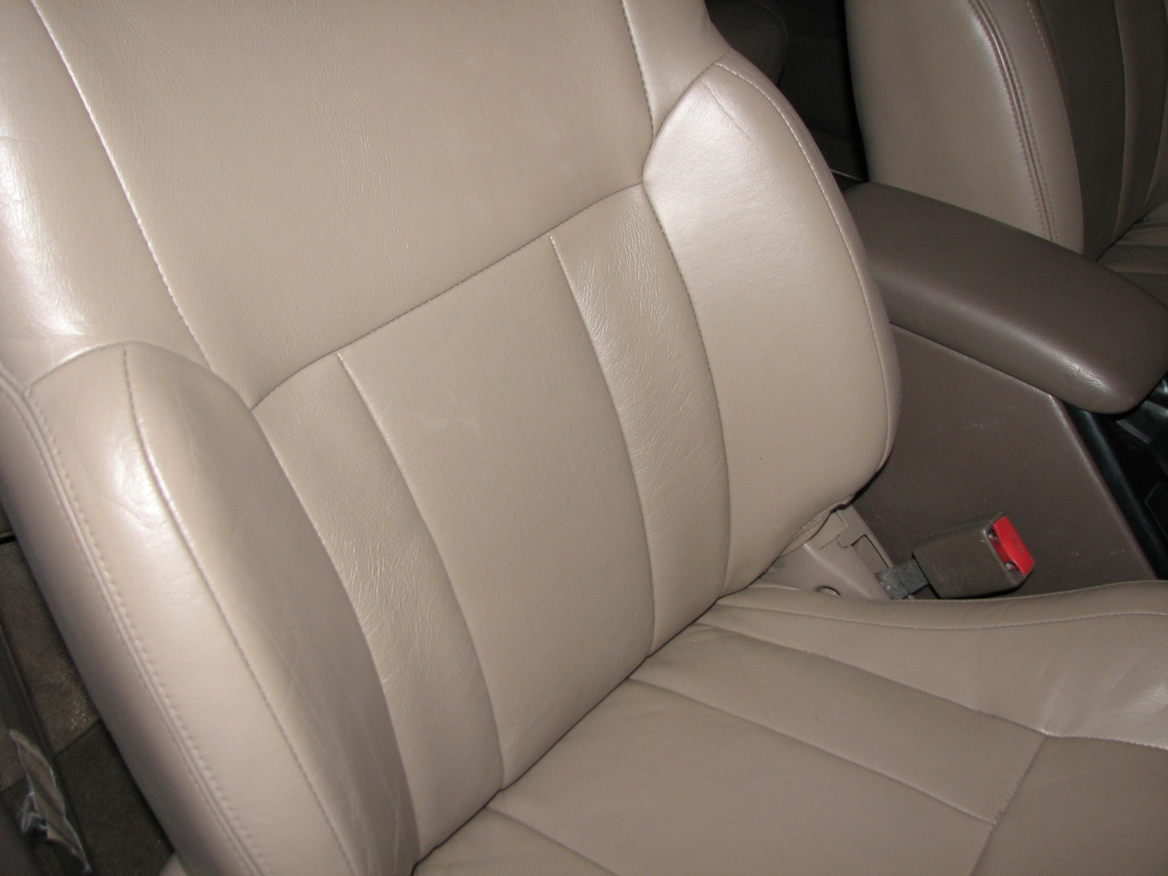

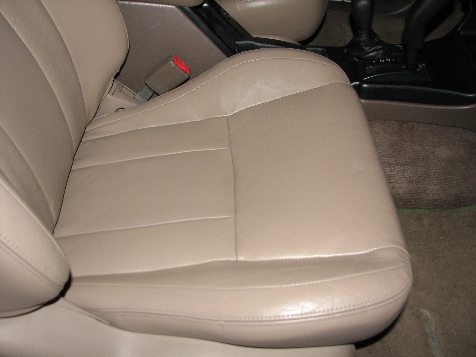

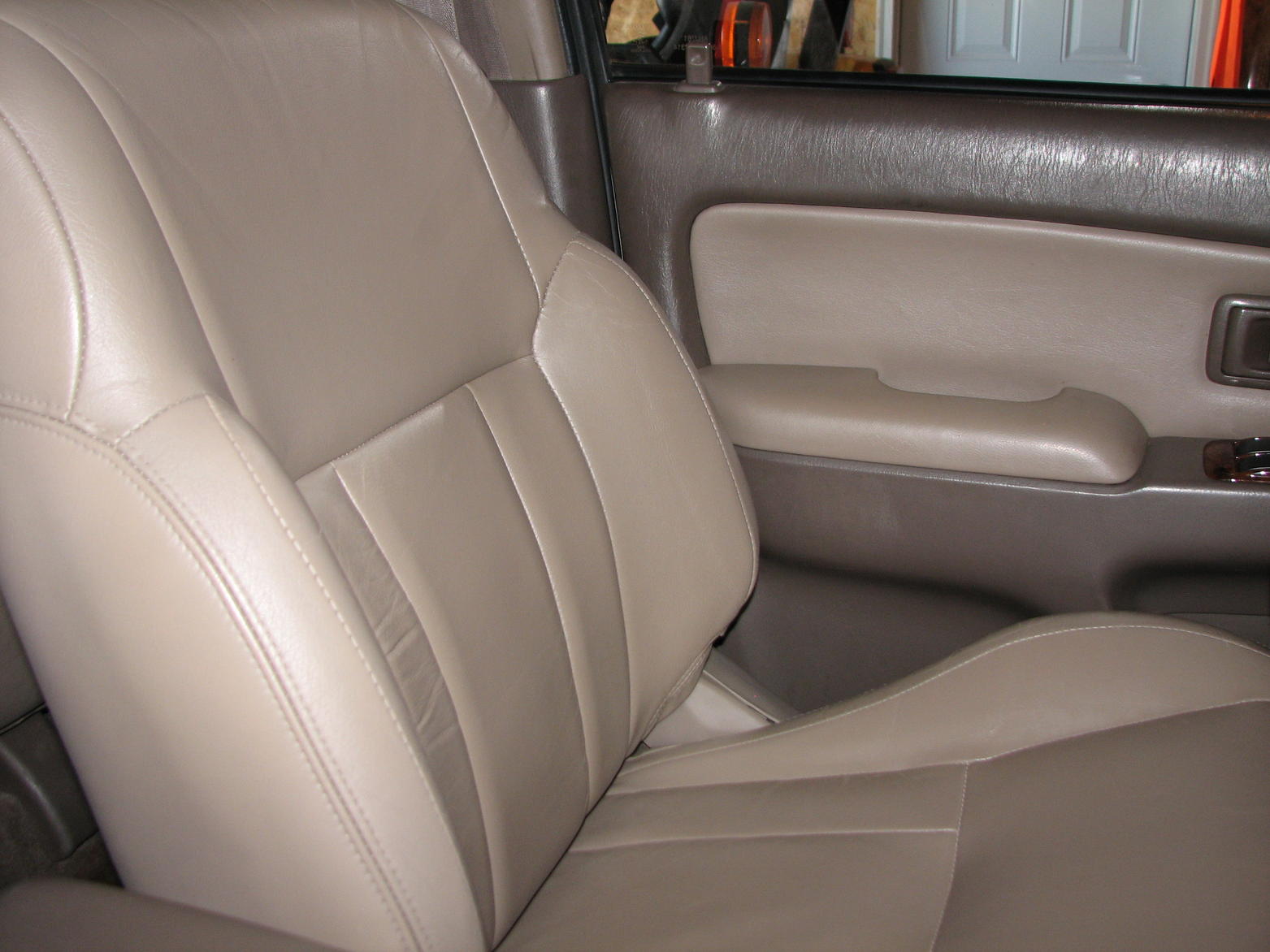

I took my time on my 96 limited with eyesore leather seats. I used a product from Leatherworld to patch the cracks and repair tears. ABS matched the dye perfectly. Photos don't do justice...the color matches perfectly. seat 003.jpg

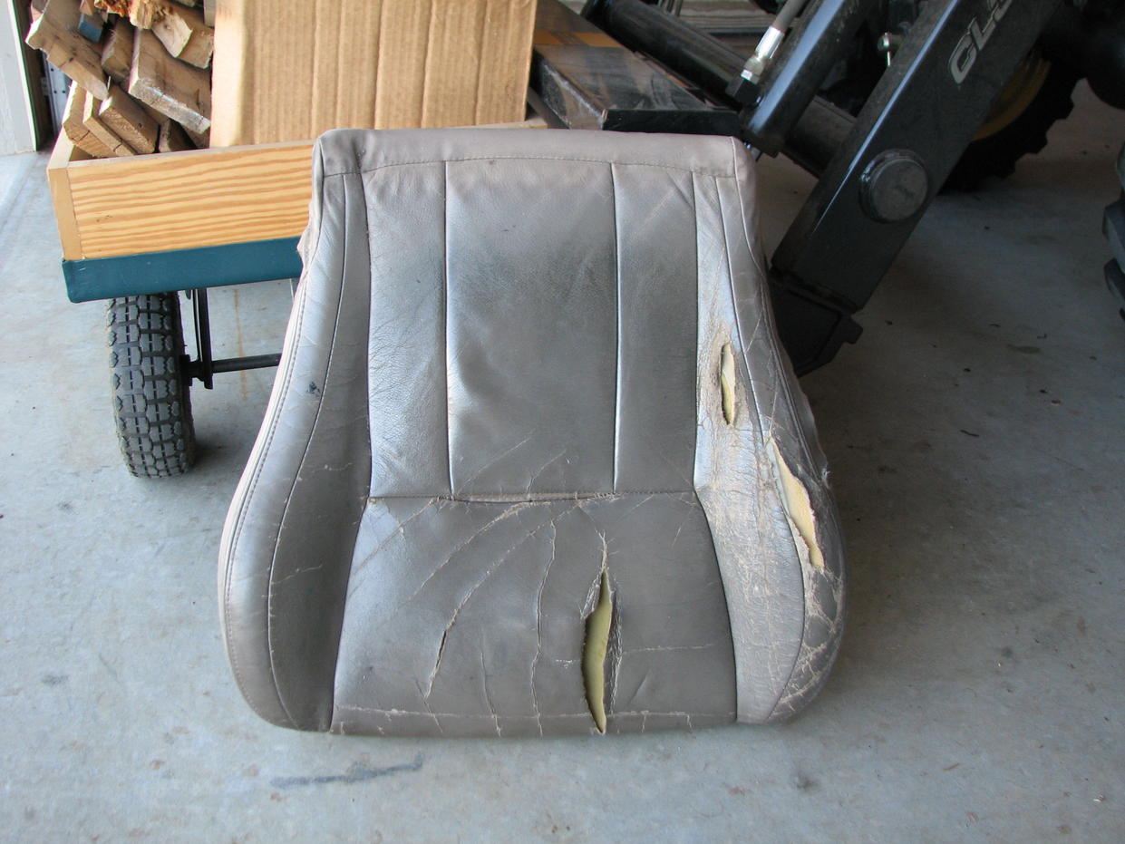

I will do a write up this aft. Didn't take any pics during process, but I have one before photo of the driver side cushion.

It's a '96 so you can imagine what the seats looked like. I'll include a pic of the driver seat cushion. I used the Subpatch material and adhesive as well as a jar of the leather filler from Leather World Tech. I also went to a fabric store and bought a curved ( surgical type needle )and heavy thread.

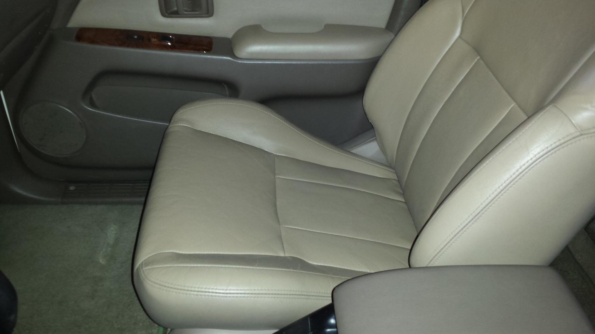

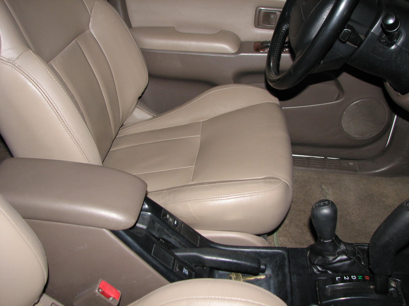

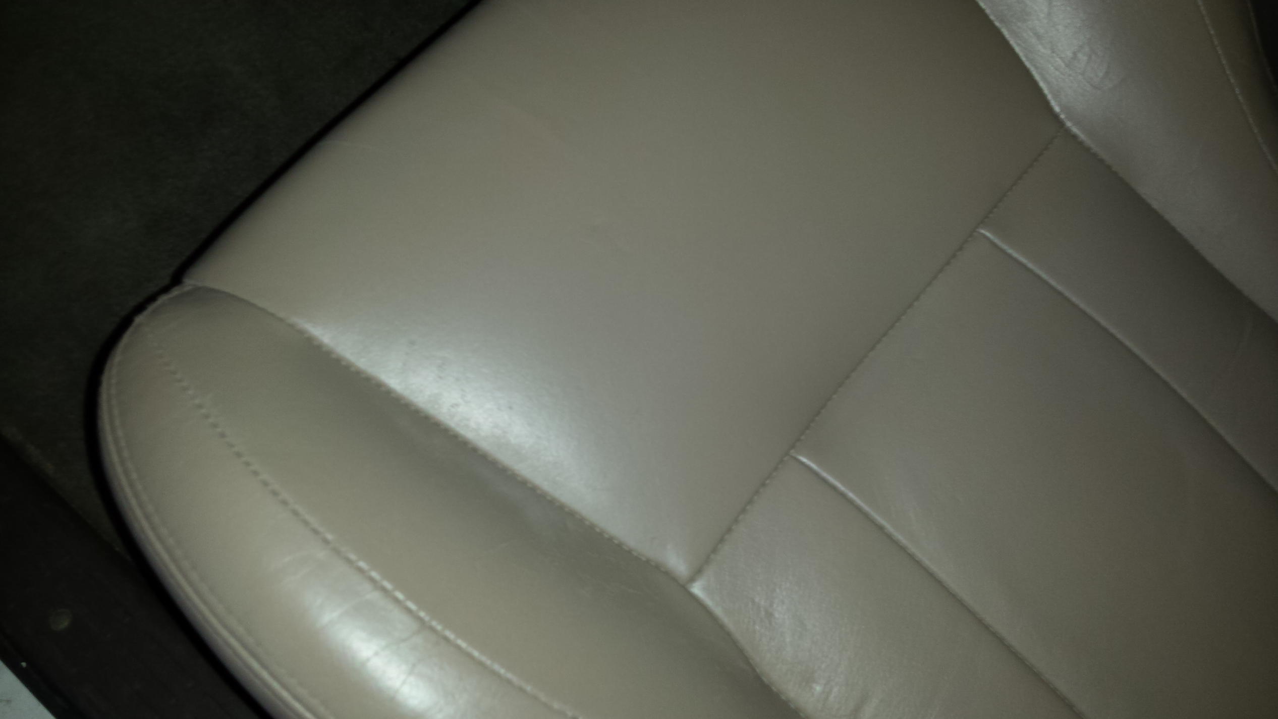

I removed the driver cushion and took the leather cover off to re-sew some of the stitching. ( A lot of hog rings to cut off to get the material off the foam cushion. I used copper wire to re attach ). After sewing I placed the cover back on the cushion and glued in the subpatch material where the leather was torn and then glued the leather to the patch.Then the long process of filling the cracks. I probably did 4 or 5 coats of filler sanding between each coat...be sure to let dry thoroughly before sanding. This is not my DD so I took my time. When I was satisfied with the look, I just used the dye I had matched at the automotive paint store. They put it in aerosol cans for me. I used a trigger sprayer attachment on the can. This project really came out great. We'll see how long it holds up. Here's more pics. As you can see the driver cushion had been dyed before..bad color match.

Wow, that's quite the restoration! My opinion on leather seats have completely changed! I avoided getting a Limited since I hated how the leather seats always tore.

This just didn't seem believable based on the last picture.
I'm officially in the "that looks fake" category for the moment.
I could believe that you removed the piece of leather or vinal that was torn and found a well cut matching piece, then sewed it up real good and used the filer material paste to make the seat look new again.
But what you describe is totally different which is why I'm very skeptical.

It's all real. The large tears I used the subpatch material and filled in with the leather filler putty or whatever you want to call it. Like I said, it took quite a while to do this. A lot of sanding to make the patched area disappear. BTW I'm a finish carpenter by trade, so I have some skills in the sanding and finishing areas. And as I also said, well see how this holds up. The leather filler is very rubbery when it dries, so it must flex. I reside in a very changeable climate ( well below zero in the winter and 90's in the summer occasionally ). I'll try and remember to post pictures in Dec. sometime so you can see how it's doing. I fully expect it to crack again eventually just from getting in and out, but I just couldn't justify dumping $600 to $900 in new vinyl or leather covers in a "96 I paid $2500 for just to drive for a winter vehicle. We live on 6 miles of gravel and it really takes a toll on vehicles.
