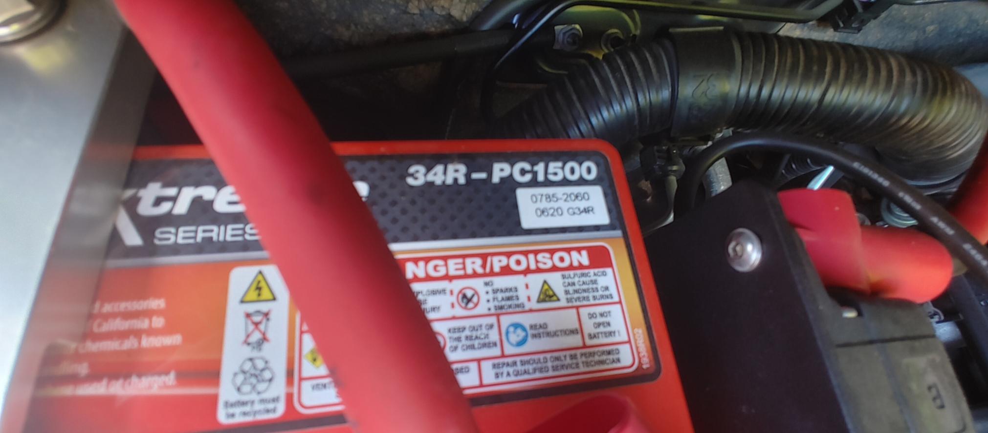

C4 Fab makes a nice box to mount a second battery in that location. You'd have to check their website to see what fits but something like a Group 34 fits in that spot as I had one there on my 4th gen.
As far as what else you need, I'd look at a Blue Sea ML-ACR for switching and then if you use an AGM, you'll need a DC-DC charge booster. Cabling etc. There's tons of shit written up about this as it's been a popular mod for decades.

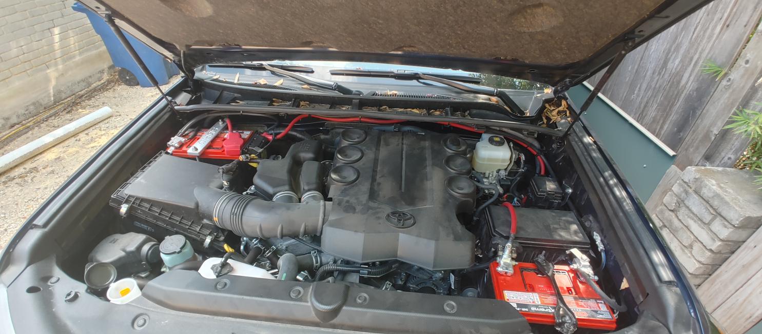

FWIW, I have the C4 Fab battery tray and am using a Northstar 27F AGM... I don't think anything even slightly longer than the 27F would fit; I'm using a Battery Doctor 150A battery isolator to isolate/combine the two batteries and a ArcLight voltage booster. I ran 1AWG between each battery and the isolator. and am using Blue Sea MRBF fuses at each battery. Current flows from the second battery to 2 separate Blue Sea ST Blade distribution blocks under the hood (a 6 outlet and 12 outlet, one on each side), a 6 outlet ST Blade block under the dash (through a relay to create switched power), and to a 12 outlet ST Blade block in the cargo area for power to all the relays in the back and all the outlets/rear powered accessories.
Since I have a fridge that lives in the truck and the truck regularly sits for a few days at a time in my driveway I'm also running a Victron 15A AC-DC charger and plug the truck in anytime I'm at home and have the ability to plug in a portable 120W solar blanket in the event we are at a campsite for more than a day or two (campground style)
