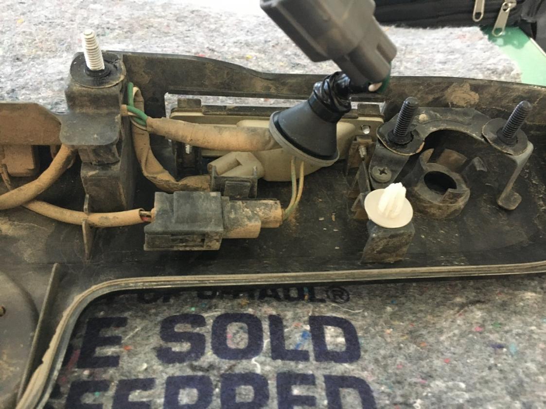

This part?
376142d1611955150-removing-rear-hatch-cover-b7169c9b-fad1-4c9b-b1bc-ddce00e4923e-jpg
Try this thread…
Removing rear hatch cover
As you can see from the pic, it’s a pretty simple setup and you should be able to fix it without replacing the whole assy.
It does take a little time to remove and you should be careful, especially with the lock. Might want to get some of the clips before you start since you’re likely to break a few. Also check if you need to replace the rubber switch cover. Hopefully they came up with a better quality part since 2010.
