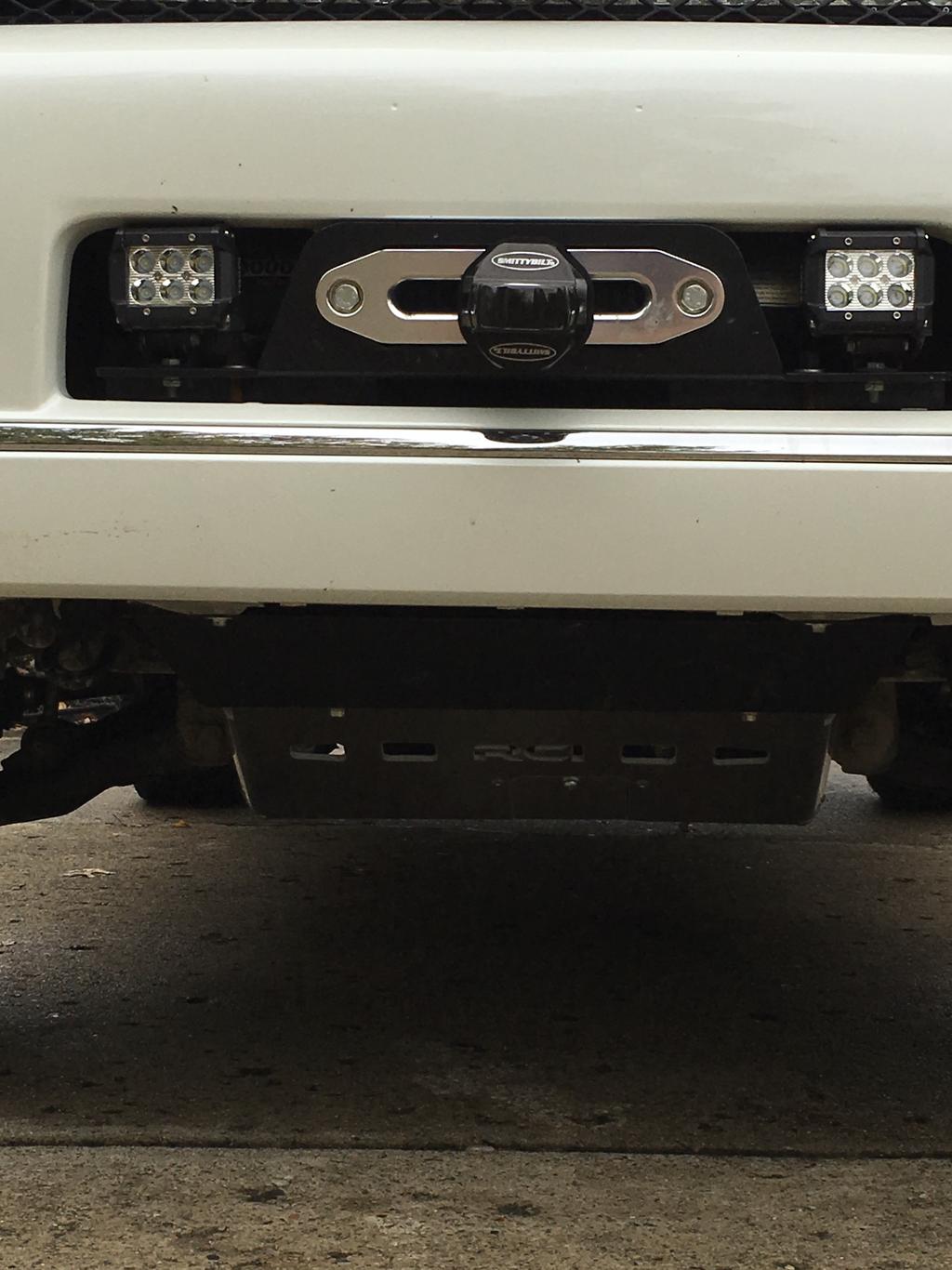

Get a thimble and all of your potential issues will be solved. No one is going to run off with it when it’s pulled tightly against the fairlead.
Edit: added a photo of my old setup for example.

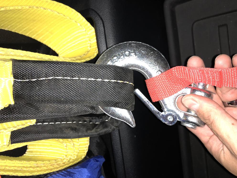

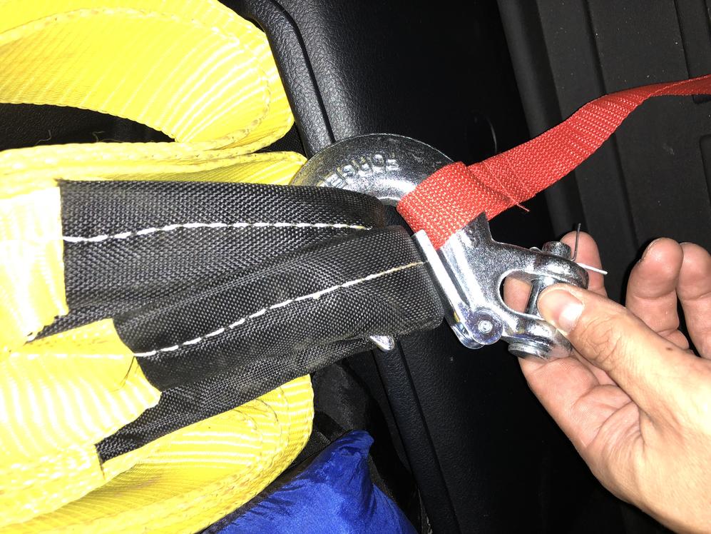

A lot of winch hooks are not large enough to accept two recovery strap eyelets AND allow the clasp to fully close. All it would take is a quick loss of tension, slip of the tow strap/hook, and you could have a hook and line flying back toward the winch when the line regains tension if the strap isn’t fully seated in the hook.
My thimble was never a pain to dink with. It took one d-ring shackle to hook to another vehicle, tree saver, recovery strap, etc...
Edit: pics for clarification. Turns out the hook that came on my Engo SR10s isn’t even big enough for one eyelet. Strap is a 30’ Smittybilt.

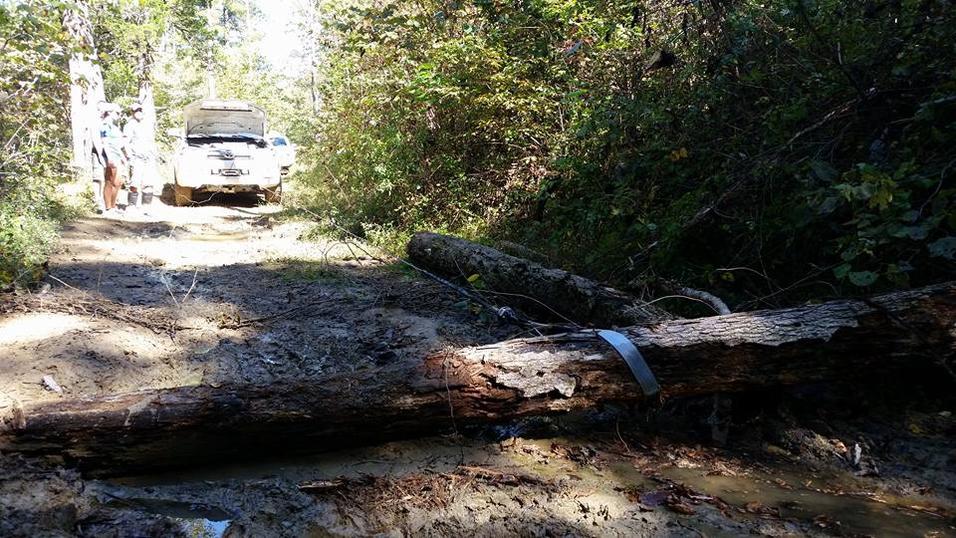

Lol this guy. Some people clean their gear after use, or don’t have to use it much because they choose a good line. In the event that there’s an obstruction or the slip of a rig, it gets used as intended. I used a thimble because I didn’t want a winch line pulled against my stock bumper.

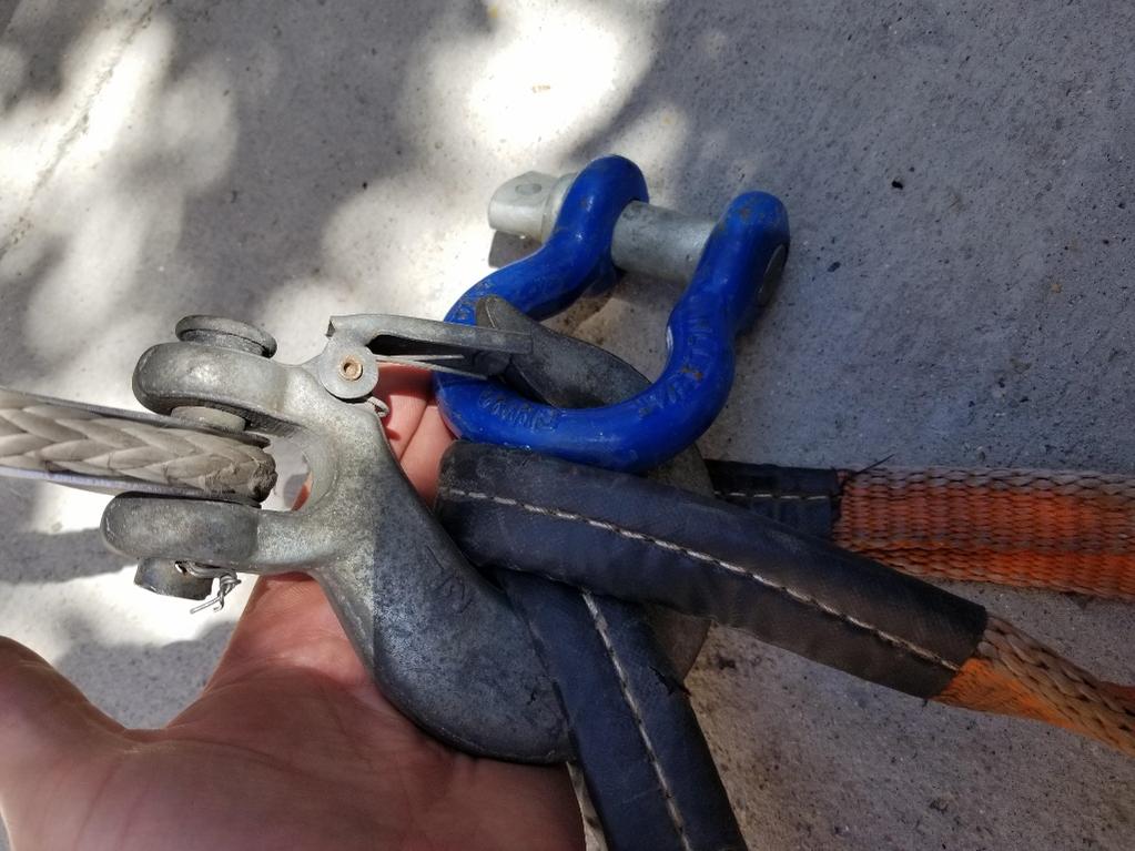

This is what a typical winch hook size is like. That's 3/4" bow shackle in there to boot. I kinda looks like maybe they accidentally put an ATV winch hook on there for you.
