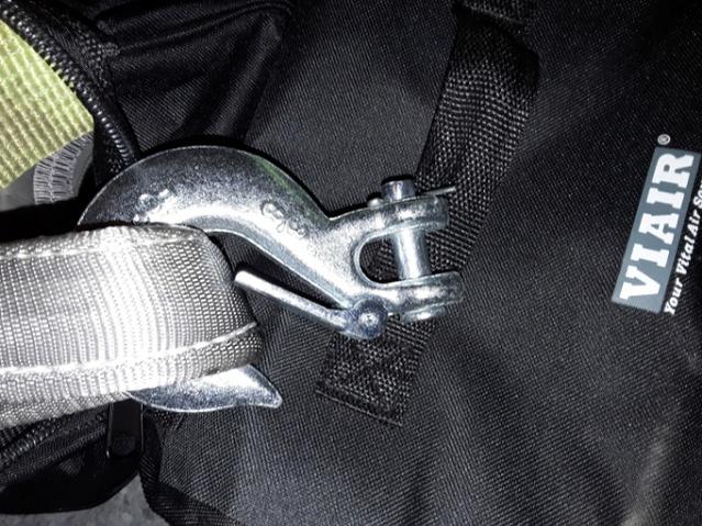

Are you like putting your straps in the washing machine? Mine current one is only a year old and has never seen mud. Just limited trail use as a rock strap when my tree strap is too short. It's never been attached as a tow strap.

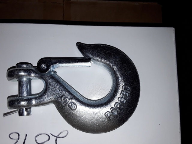

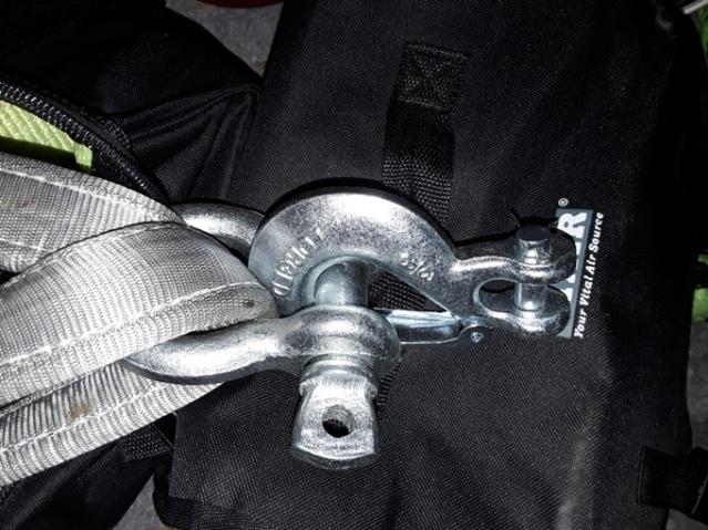

This is what a typical winch hook size is like. That's 3/4" bow shackle in there to boot. I kinda looks like maybe they accidentally put an ATV winch hook on there for you.
Mine has seen mud. I just wash it in a 5 gallon bucket when it gets dirty.
“Limited use” is a relative term. We can all tell who gets stuck more.
I kid, I kid. All in good fun.
In all seriousness, I believe my recovery strap is about twice as wide
Edit: Had to go back and look. It's 2" wide 20k lb recovery strap. What size is yours?
I think the difference is that my hook is a 1/2" and the one yours came with was a 3/8". There's a pretty big difference in size between the two.
3” wide 30k lbs. It’s also a 3/8” hook. Bottom line was it wasn’t fitting, so I spent $70 on a thimble. Bonus was I didn’t have a winch line rubbing paint off of my bumper.

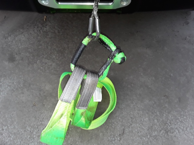

So you guys got me curious. I also have an Engo SR9 with the 3/8" hook which I never intended to use. It does seem a tad small. You could use a bow shackle but why add all that steel into the mix? I understand thimbles are all the rage but why not get rid of the projectiles all together and use a soft shackle?

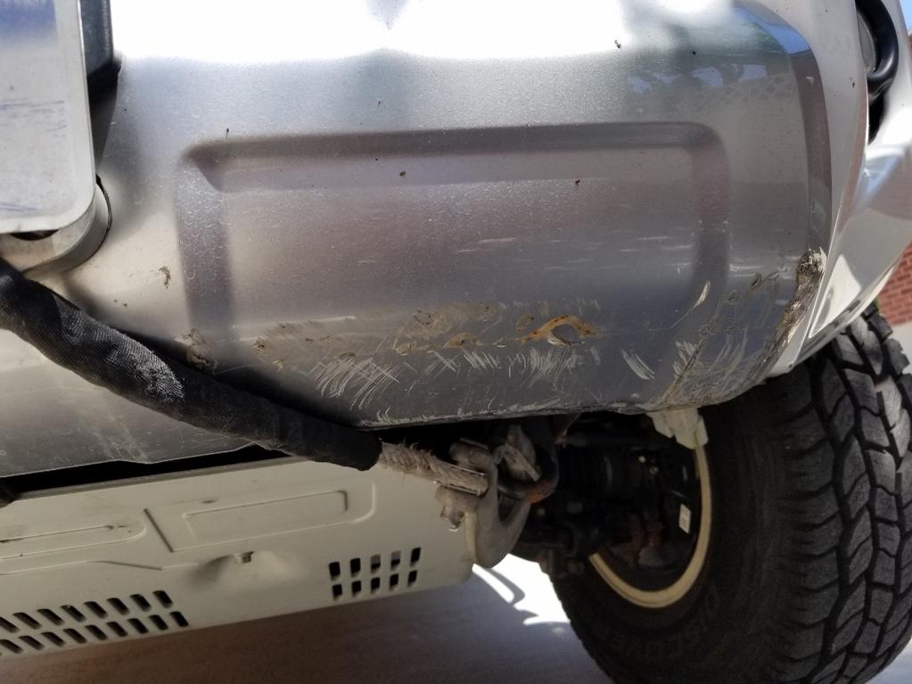

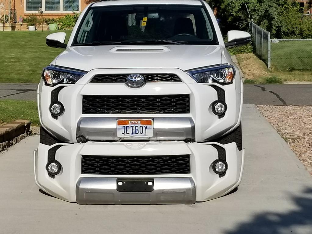

Edit: I had a hidden winch mount on a stock bumper, so if there’s an alternative to a thimble solution, I didn’t come across one. I needed to keep tension on the line and not rub or distort my bumper.

Dyneema rope is pretty flexible, but it does have a limit where it's compromised by bending too tightly. 8:1 is the minimum bending radius for 100% strength. So a soft shackle through the eyelet of the winch rope significantly compromises the soft shackle and also is reasonably likely to cause the metal internal ferrule to collapse. It would probably work - but it's not a great solution. An Antal ring would help. Something like this:

As far as hidden winches - I just run it around my bumper. But I don't much care about the bumper. It's already my second one. First one was replaced when it was hit by another car in the home depot parking lot. I already bought another new replacement bumper for when I'm ready to sell it that was an OEM takeoff and actually is a better match than the current Toyota oem replacement, so it's sitting in my garage ready to go. For ~ $100, I can't imagine a cheaper solution than just replacing the whole cover when I'm done.
As a side note the thimbles that use a pin to attach to a tube thimble on the rope seem really odd to me. Why add complexity and make it weaker? A proper thimble should have the rope go around the eyelet for a safety factor incase the aluminum fails. But the multi component pin style ones just add more crap that you don't need for no reason.
I've thought about the ferrule stresses with the soft shackle and will keep an eye on that but I would think the soft shackle would put less stress on it than a thimble pin?
