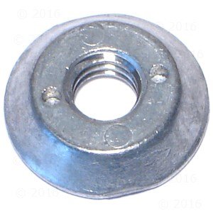

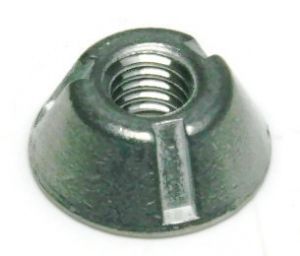

I'm looking for ways to prevent or slow down a potential criminal from swiping my light bar off my car.
I've researched a few items and just curious what others have used.
These look like great options for the style of mounting I have, what are your thoughts?

My buddy drilled a hole thru the bolt and added a small lock.
A couple tack welds is probably the best solution, but it is permanent.
Make it harder to steal....
On my Jeep, I TIG welded a washer on the end of several short pieces (about 1.5 inches of stainless tubing. Then I put the nut for the lights and winch inside. Most thefts don’t carry the right size socket. If installing a bolt, use a Allen head or torx head and fill the head with epoxy. You can pick it out, with the right tool. Again, anything to make it harder, but not as permanent as spot welding it.
