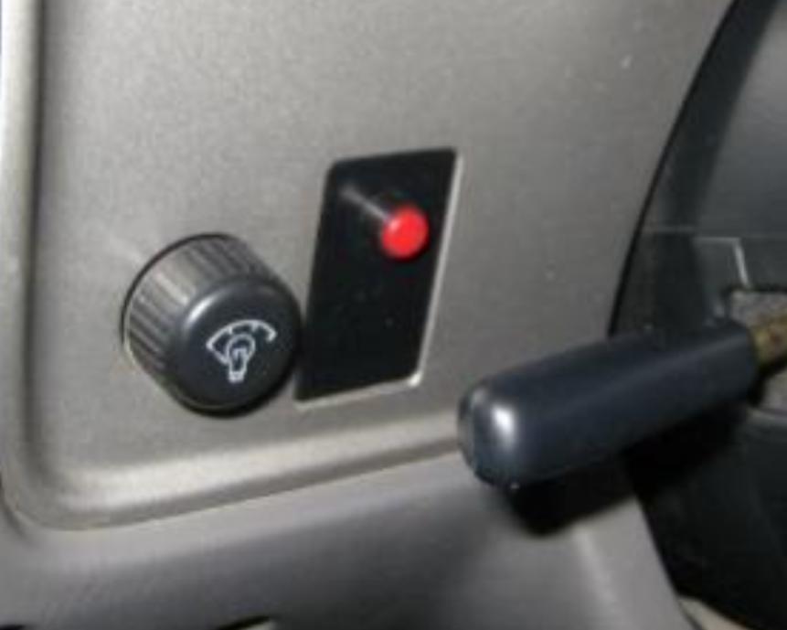

I have seen those results as well. And no, that's not the sequence I found before. We did try it though, we tried a ton of combinations. Guess we weren't holding our mouths just right :/ Honestly I don't think the magic answer a few years ago was even on T4R, seems like it was buried on some other more obscure site. Dug around on yotatech too with no success so far. I'm not back to the truck yet to take a pic but the button is very similar if not the same as image attached. It is spring loaded with an 'in' and 'out' position (armed or disarmed). Hope that makes sense. Now I don't recall which is armed and which is disarmed. When I ran into this before I didn't even know it was a button. Just thought it was a light. I miss the valet switch underneath dash like on the '94.

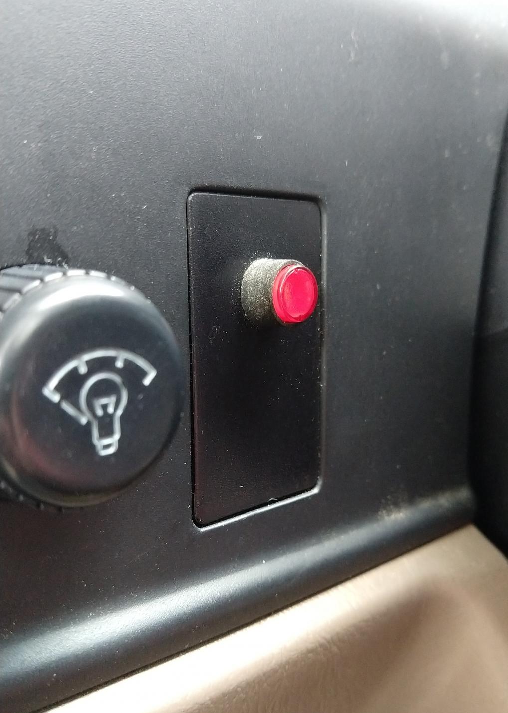

Thanks all. Late rely but we were able to get it started. Unfortunately, my daughter who was in the truck trying things didn't pay super close attention to what exactly she did that finally worked. She THINKS she pressed the button 3x while simultaneously turning the key either to ON or to ACC 3x, then it started. Frickin' weird. I really wanted to have a definitive answer for anyone else who runs into this. You can try this at least. We had of course disconnected & reconnected negative terminal. I also had a shop tell me they usually disconnect negative terminal, turn the key to ON, then reconnect negative terminal to bypass security. This did not work for us. Attached is a better pic of our button light. I need to find a fob that works.

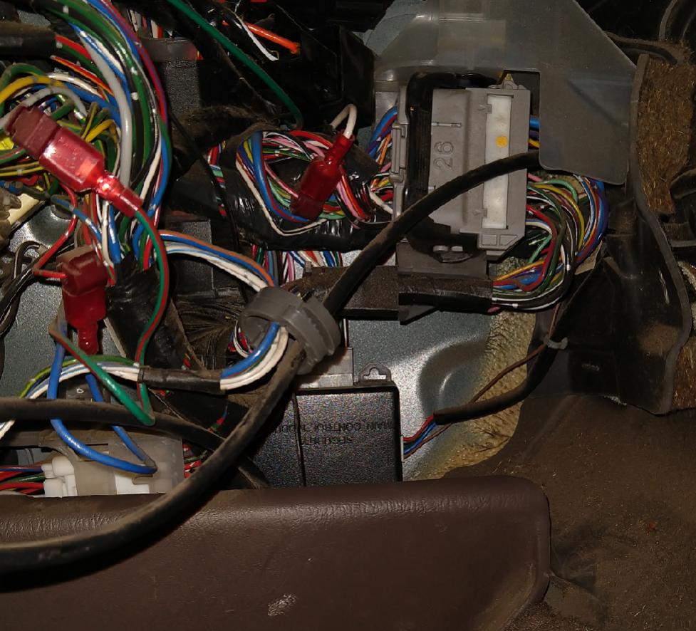

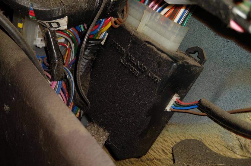

I ordered a key fob but can't seem to get it programmed (no surprise). Watched several vids and read instructions posted on different sites. Most seem to refer to a reset button on the main module typically under one of the front seats. I finally found what I believe is the main module. Not under a seat but hidden behind the top edge of a driver side panel under the dash. See pics. Anyone know what to do in this scenario? If I need to remove the panel for access to the module, what does that process look like? I've already tried the method where you insert key, remove key, go thru locking & unlocking doors, so on & so one. No luck.

What's with all the wire taps? Are you sure it doesn't have an aftermarket keyless entry/remote start system on it?
Actually, no, I'm not 100% sure this isn't aftermarket. It was in the truck when we got it a few years back. I'm fairly certain it isn't the VIP system as there is no VIP sticker on the windows. There is however a sticker that says PERMAVIN Security. I also don't see anything in the user's manual about security system so unfortunately it's looking more like it may be aftermarket.
You might try following some of those wire taps to see if you can figure out where they go. What year and trim do you have?
I just had Toyota dealer check original specs with the VIN. Maybe this info will help someone else as well. According to dealer: before being sold for the first time, the truck went to a distributor called Gulf States Toyota here in TX. They installed what is called "Security System Plus" (brand name unknown but could be PERMAVIN). Even though a Toyota distributor installed the security system before the truck was first sold, it is classified as 'aftermarket'. They gave me another part number for key fob, different than what they first told me since they dug deeper. If I find one and it works I will post the part number for anyone with this system.
Finally found this post after much searching and hair pulling!
I have the same alarm system and the 3x button pressing with the key switch to ACC/ON did indeed work. This was after days of being stumped, so to say that it was a relief is an understatement. Just wanted to add this for anybody else with this problem, this could definitely work!
