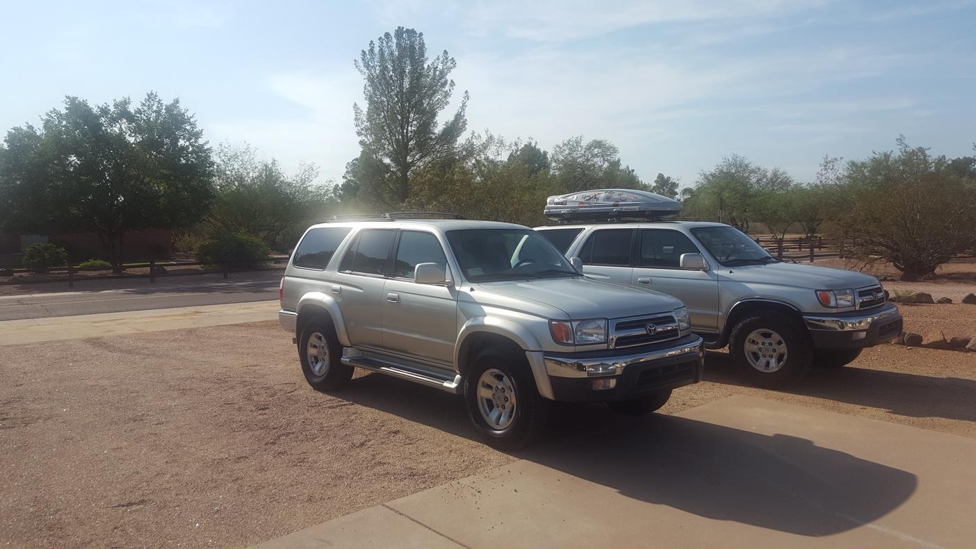

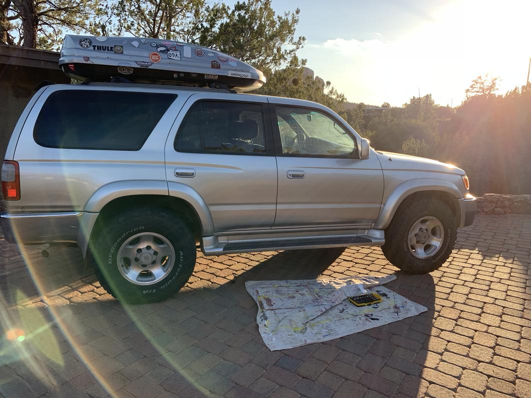

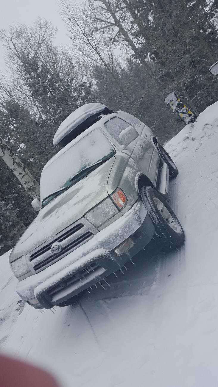

First order of business was to swap over the cargo box, BFG KO2 (265/75/16), and double din pioneer avh-200ex.
Here is my ‘99 on the snow covered mountain, a side by side of the two, and the 2000 after moving wheels and cargo box over.

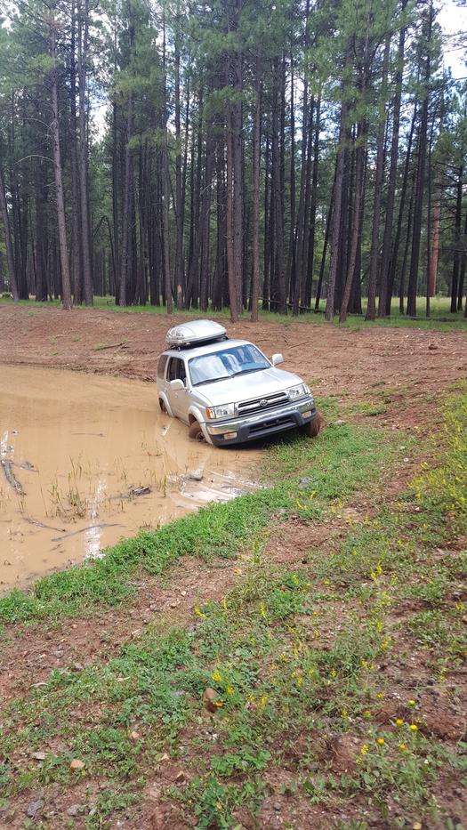

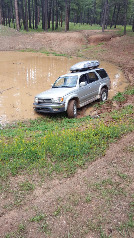

One of the first things I did was take her on a forest road through Flagstaff, AZ. Driving through the woods I found a stock pond and decided to play in some mud (w/ nearly zero knowledge of how to do so). I made a foolish attempt at riding the banks of the pond and the mud proved to be so slick that I slipped right into the pond. All of my efforts to drive out of the water were useless as the mud just sucked me in deeper. My BFG A/T tires quickly became slicks and I had no choice but to call for help. Ended up calling a buddy to tow me out with his FJ Cruiser. We hooked up a tow strap from my front end recovery point to his hitch, we both went 4lo and rev matched with his locker engaged. She came out without a fuss.

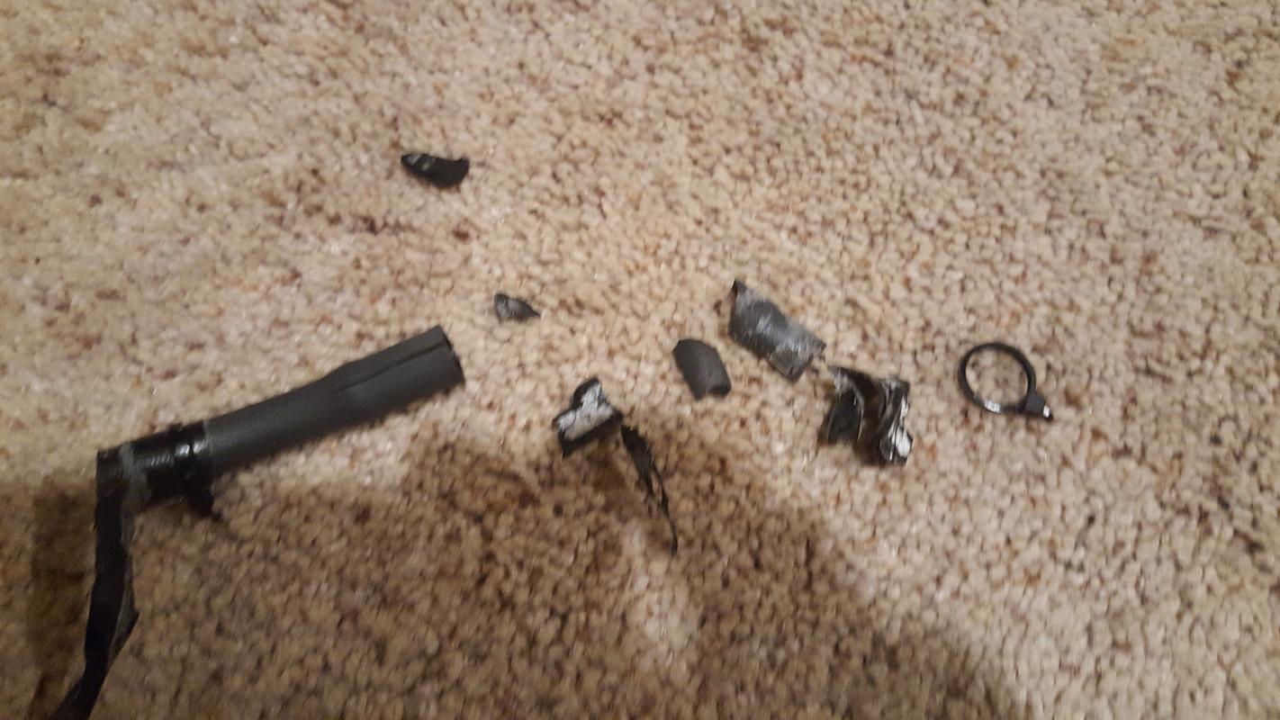

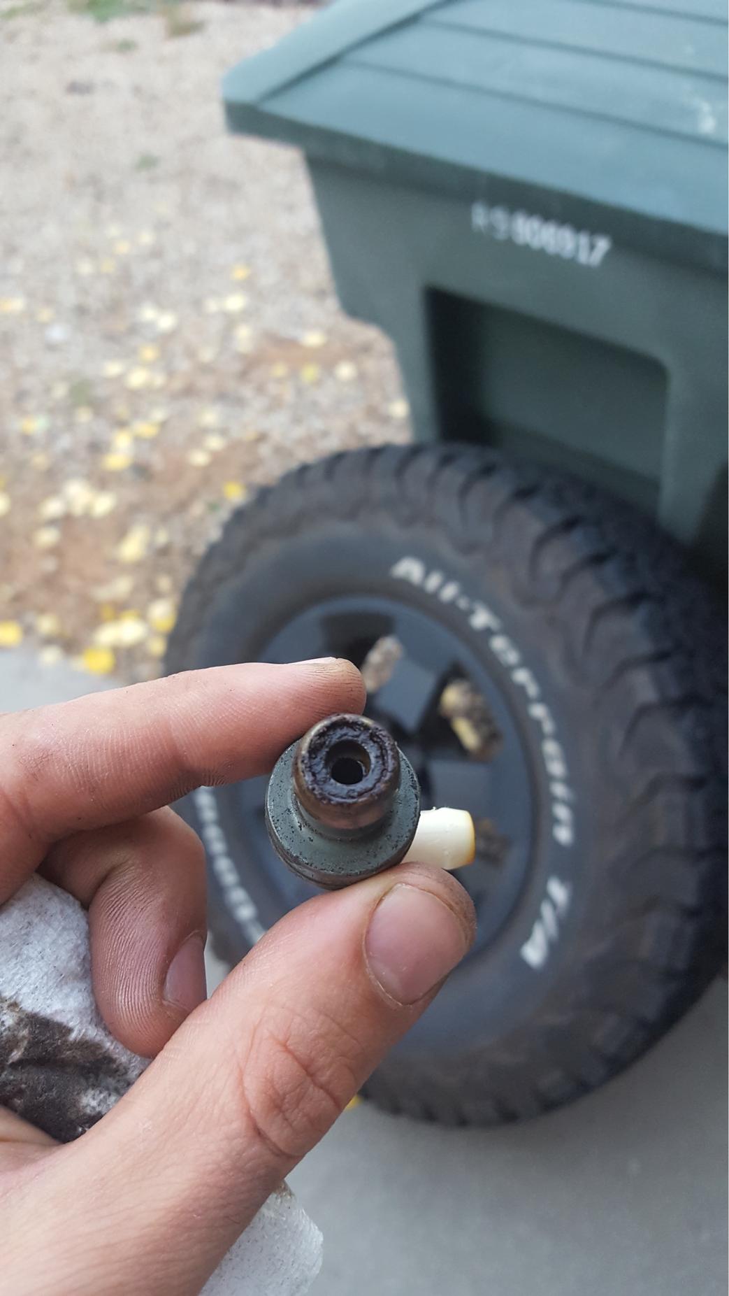

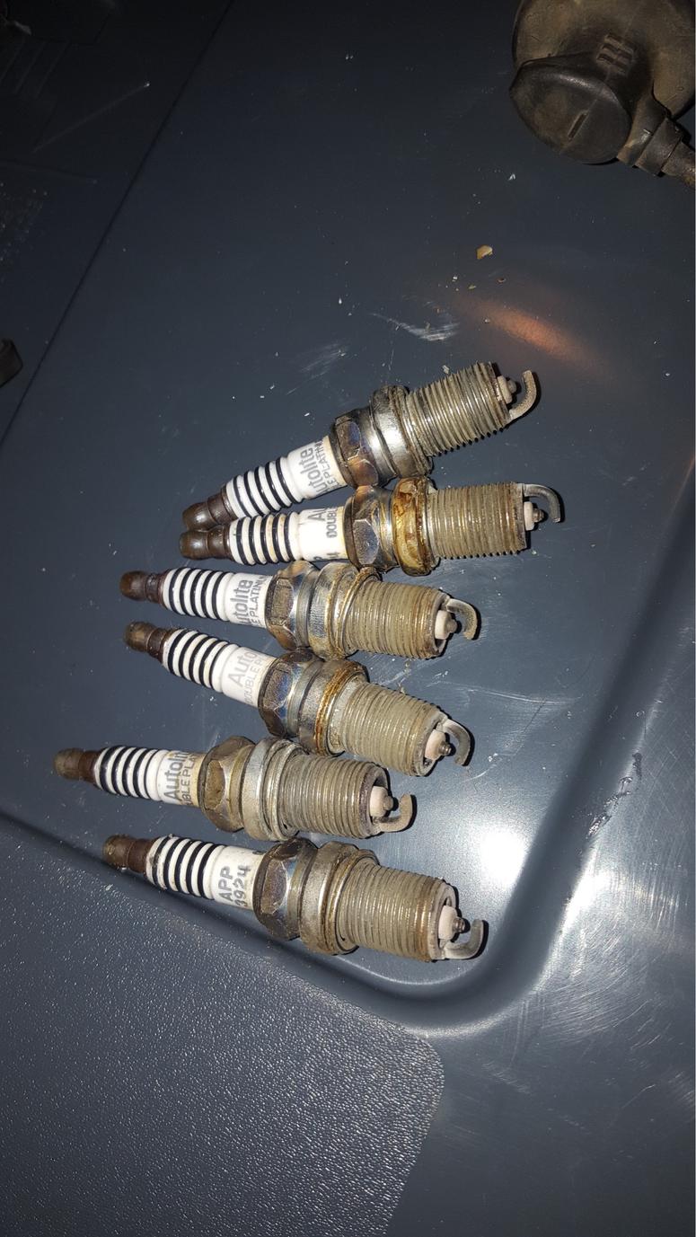

I went out and bought OEM spark plugs and wiring from the Toyota dealer. Thank God I decided to do this....not sure if the previous owner put these in on purpose or if a mechanic decided to put these crappy plugs in but look what I found in my motor...explains some awkward rpms I was experiencing.
I also decided to replace the PCV valve while I was at it. The valve was gunked up and the grommet fell apart as it usually does.

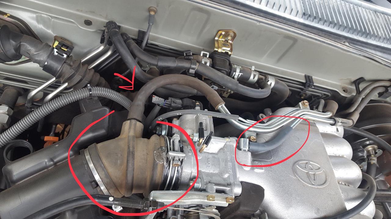

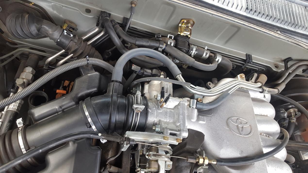

More work for the motor. Guys, you should inspect your hoses and boots around the engine. Air intake boot and 2 breather hoses replaced. I had used some gorilla and glue and dum-dum to patch some cracked hoses until parts arrived. Air intake boot was especially bad and causing some shudder in the engine. As you can see in the 2nd photo, the hoses are extremely brittle and completely fell apart when pressure was placed on them. Still need to order and replace a few more. All hoses are OEM.

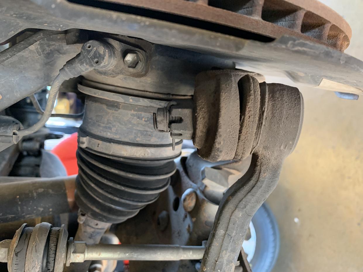

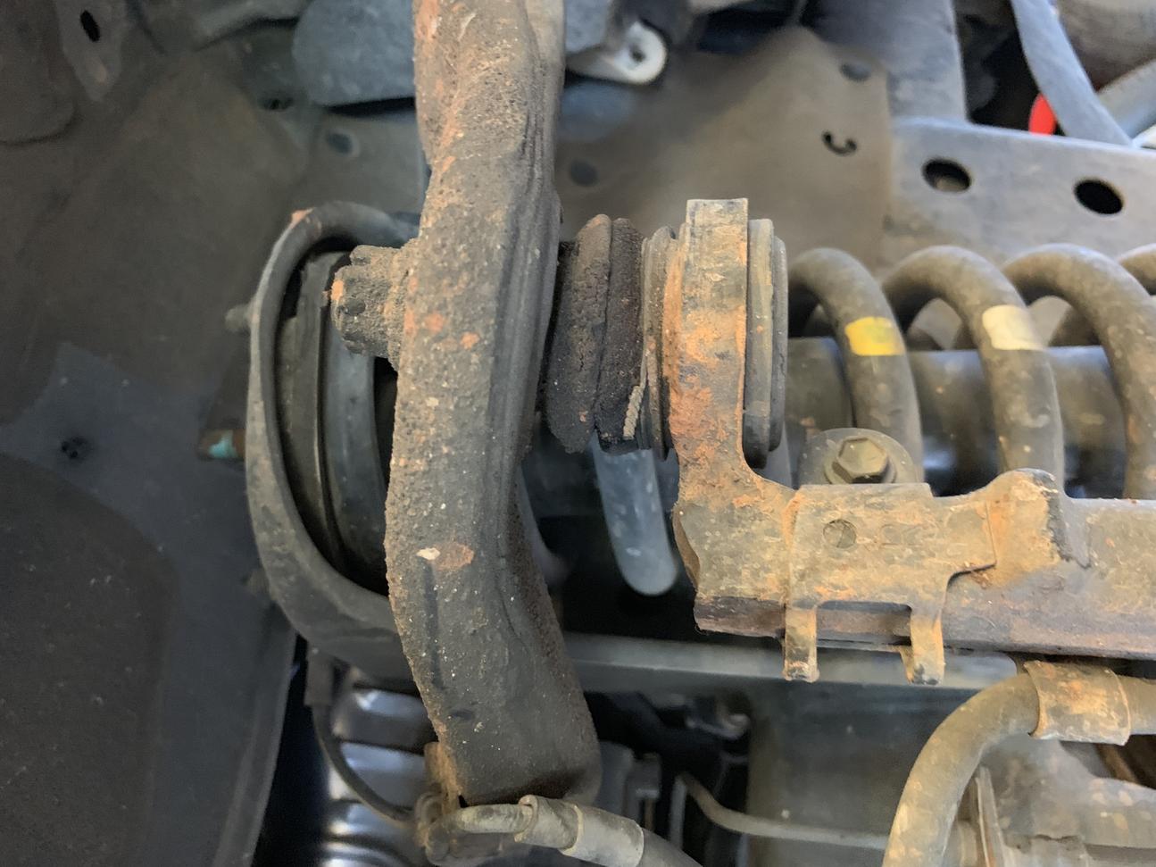

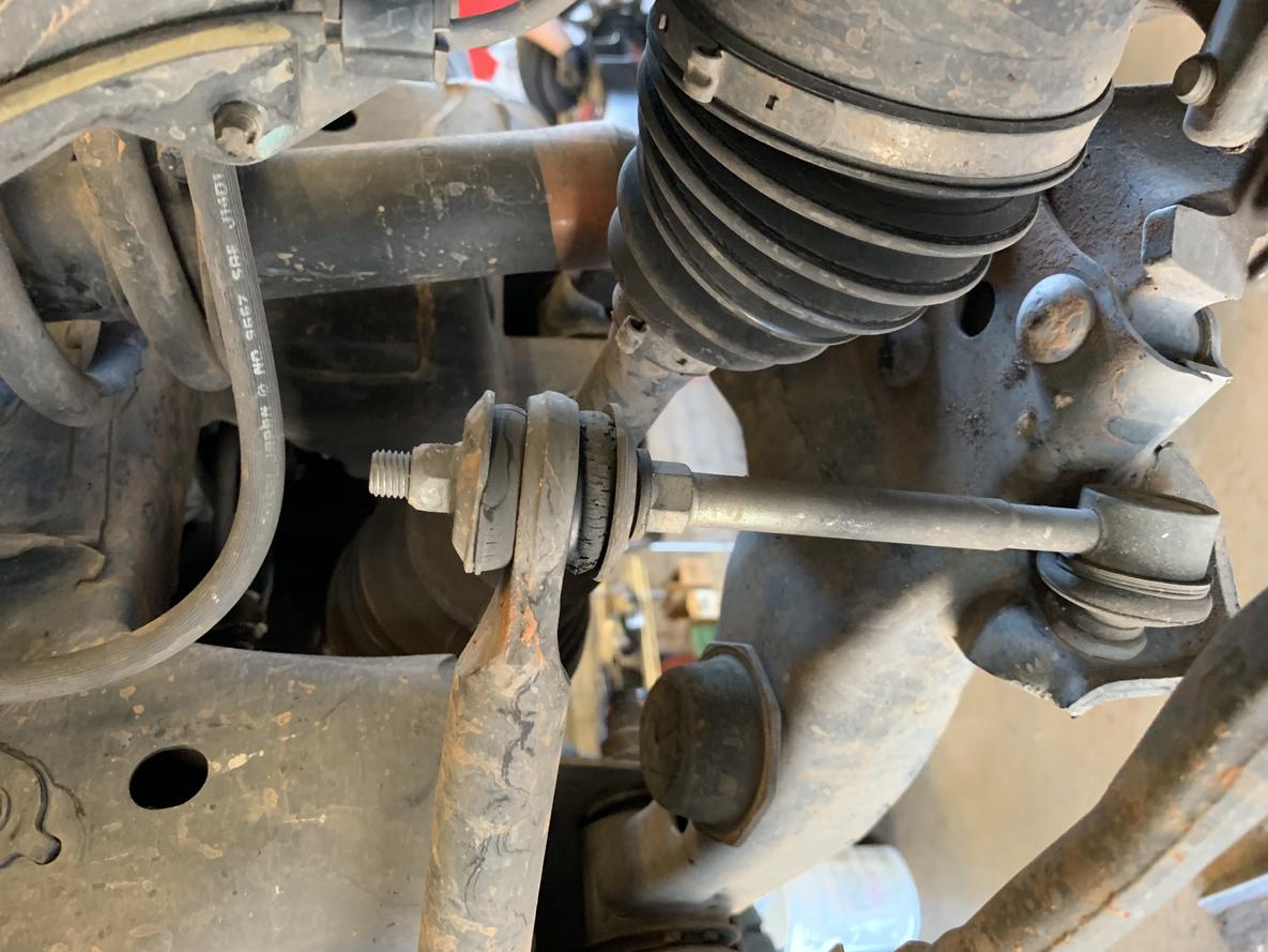

I took a few pictures while she was on the lift with wheels off. I am gonna need to order some parts ASAP.
PS the red is Sedona dirt, not rust.
Those bushings look like mine. Do you know if they sell a kit that replaces all of these bushings? How hard are they to DIY? Good luck on replacing these. The dirt will come off easy if you ca get a hold of a pressure washer.
Wish I got a 4Runner in AZ... I haven't seen anything that clean off a showroom floor. That engine doesn't look used! (other than the hoses and plugs)
I have buddies with rusted out 2008 trucks.
I am not sure there is a kit for the parts. I am slowly accumulating all the front suspension parts I need and plan to get the tools and do it all myself with the help of forum write-ups.

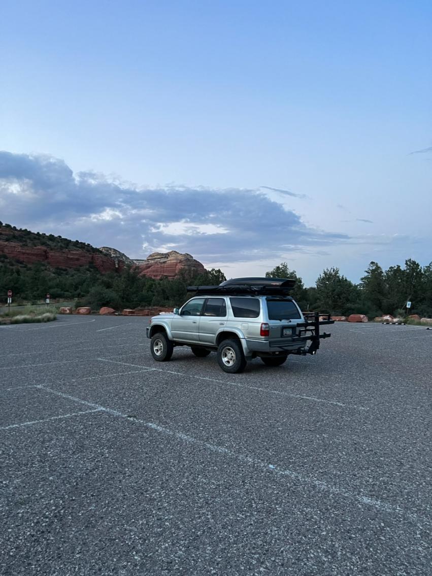

What she looks like today. Update list coming soon!
:fish2:
I hope you've found this out in the last 4 years but recovering off a ball tow hitch is a big no no. I
It can break and it's suddenly a projectile with a butt load of force aimed at the other vehicle. This has killed people in recoveries before. Always use a shackle receiver or a soft shackle.
Sent from my moto g stylus 5G using Tapatalk
Totally dangerous.
I’ve watched quite a few recovery videos since then and have had some more experiences.
Luckily it was a simple recovery that day and all was well. Won’t be doing that again though !
