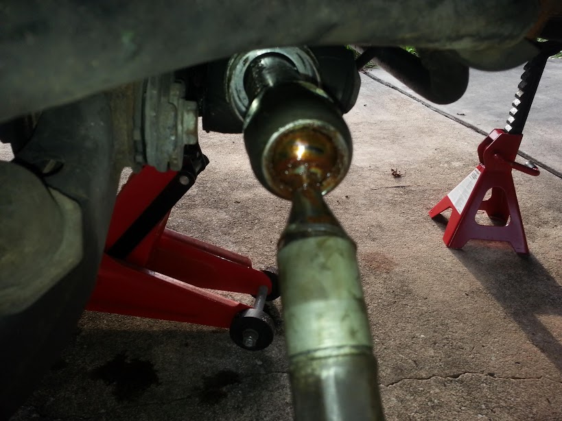

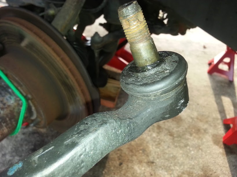

Ok so got one side done tonight, Used a big pipe wrench on the ITRE and finally got it off. Was able to break the Jam nut off as well even though you really don"t have to. Big issue tonight was getting the knuckle to flush back up to the new lower ball joint. It just would not sit tight against it for some reason and finally got it with just pulling down as hard as I could on the knuckle and screwing in the 4 bolts as fast as I could. It was a bugger but I got it. So here are the old ITRE and OTRE.....they looked pretty bad so glad I was able to do this.

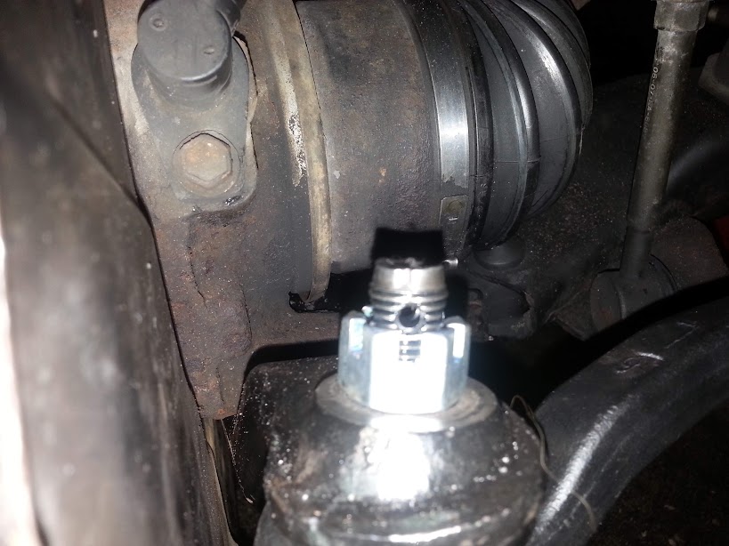

Ok so got everything in and went to tighten on the last castle nut on the drivers side OTRE and put in the cotter pin and this is what I know have happening. The castle nut goes way down the OTRE bolt and much farther then the other OTRE bolt and will not tighten up due to the OTRE bolt spinning along with the castle nut. Here is a pic:
UkryjvO06m1grFHn-vKEr9ly4IQAYeNHsxrBf4LmNIc=w819-h614-no
Not sure what I did different but everything looks the same on both sides but the drivers side OTRE will just not tighten without spinning. So I tried to C clamp the bolt will trying to tighten the Castle nut....no go....tried to lack the ball joint up from underneath to apply pressure to the OTRE...no go......tried holding the bolt while using a open end wrench to turn the castle nut....no go?
Is it possible I got a bad part from Toyota or if you have any other ideas that will help me get this OTRE tighten down I would be very grateful.

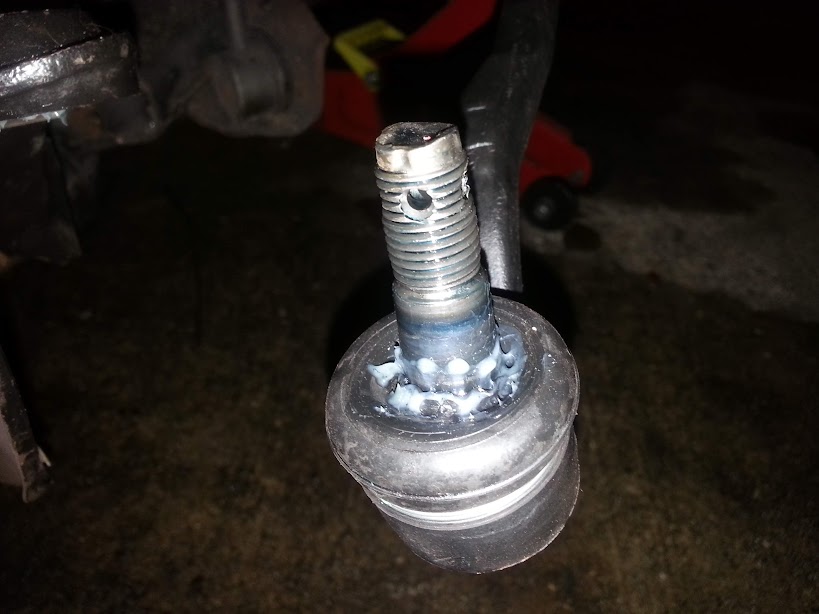

There is grease seeping out of the OTRE that I am unable to tighten but none came out of the other OTRE....is that normal? Here is a pic:
