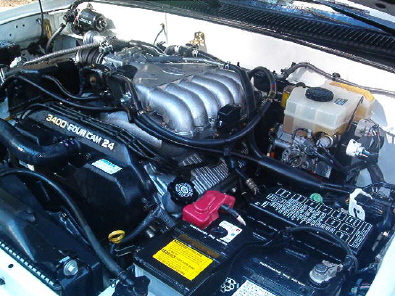

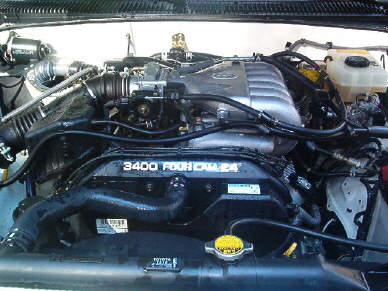

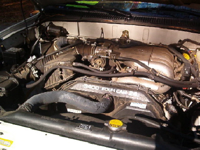

Today is a beautiful day in Atlanta and I decided to try that trick. I found Simple Green and Simple Green Automotive and went with the automotive stuff. I like being able to clean every nook and cranny and with a cold engine, I could get into every corner.
Before
I'm surprised that the battery was all you had to cover. Did you just use a hose or a pressure washer on it??
Thanks!
Well, I didn't exactly follow Turboale's advice to the letter. Simple Green says do small areas at a time. I wet the whole area down with a garden hose and then worked on one area at a time and then washed down that area. I started with the hood first and then the fire wall and just continued on. At the end I even cleaned the battery, (that I left uncovered). I used the hose sparingly and used no pressure on the hose.
It worked so good I decided to clean my other two cars and they have a lot more mileage. If I condsider my 4Runner with 43,000 miles, semi-new then my Acura at 187,000 is semi-ancient.:D
I have used Gunk on hot engines and that works pretty well, Simple Green was more for the whole engine bay including things like brackets, hoses, inside of the hood, heck I cleaned anything I could see and a few things I couldn't.:blulaugh:
