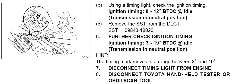

Another observation: The idle is 600 rpm but the timing varies between 9 and 16 degrees!?

What would cause the Spark Advance to wander between 9 and 16 degrees. I think that's my big clue but I don't know what to check besides the cam position sensor; the ohms were ok.

By "ready for a timing belt" do you mean the second one or has it ever been changed? I believe the ECU controls the timing on these based on what the sensors tell it so if the cam sensor checks out maybe the crank sensor is off..? If your belt is really old maybe it's streched just enough to affect the timing....? I'm totally guessing :biggrin2:
I was being lazy last night but I looked it up today and your timing is fine.
Wow, I appreciate you looking that up. I thought I really had something when I saw my timing hunting from 9-16 degrees over a period of seconds. It is on its second T-belt so it's due again. So where does this leave me and my random misfire?
