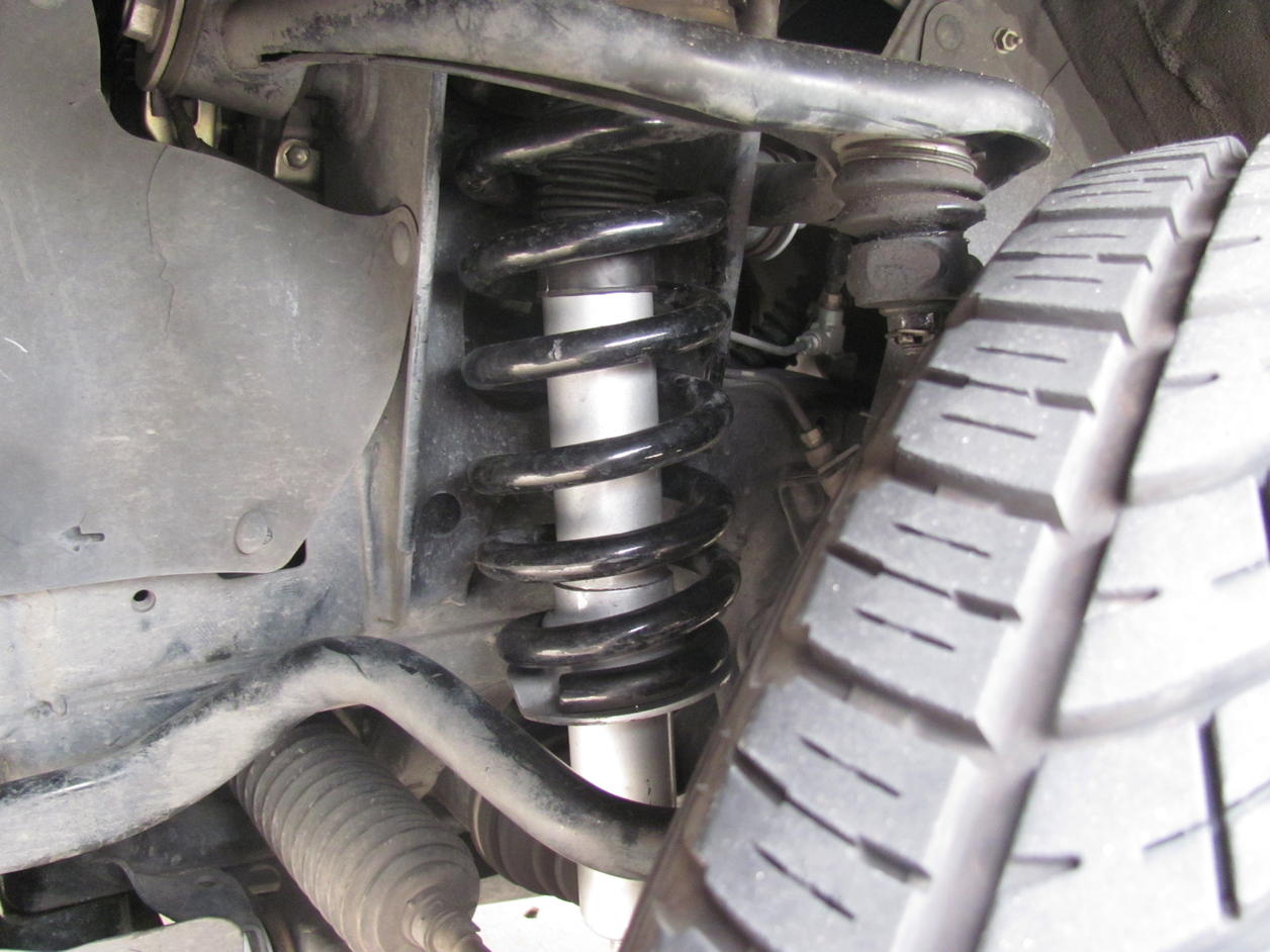

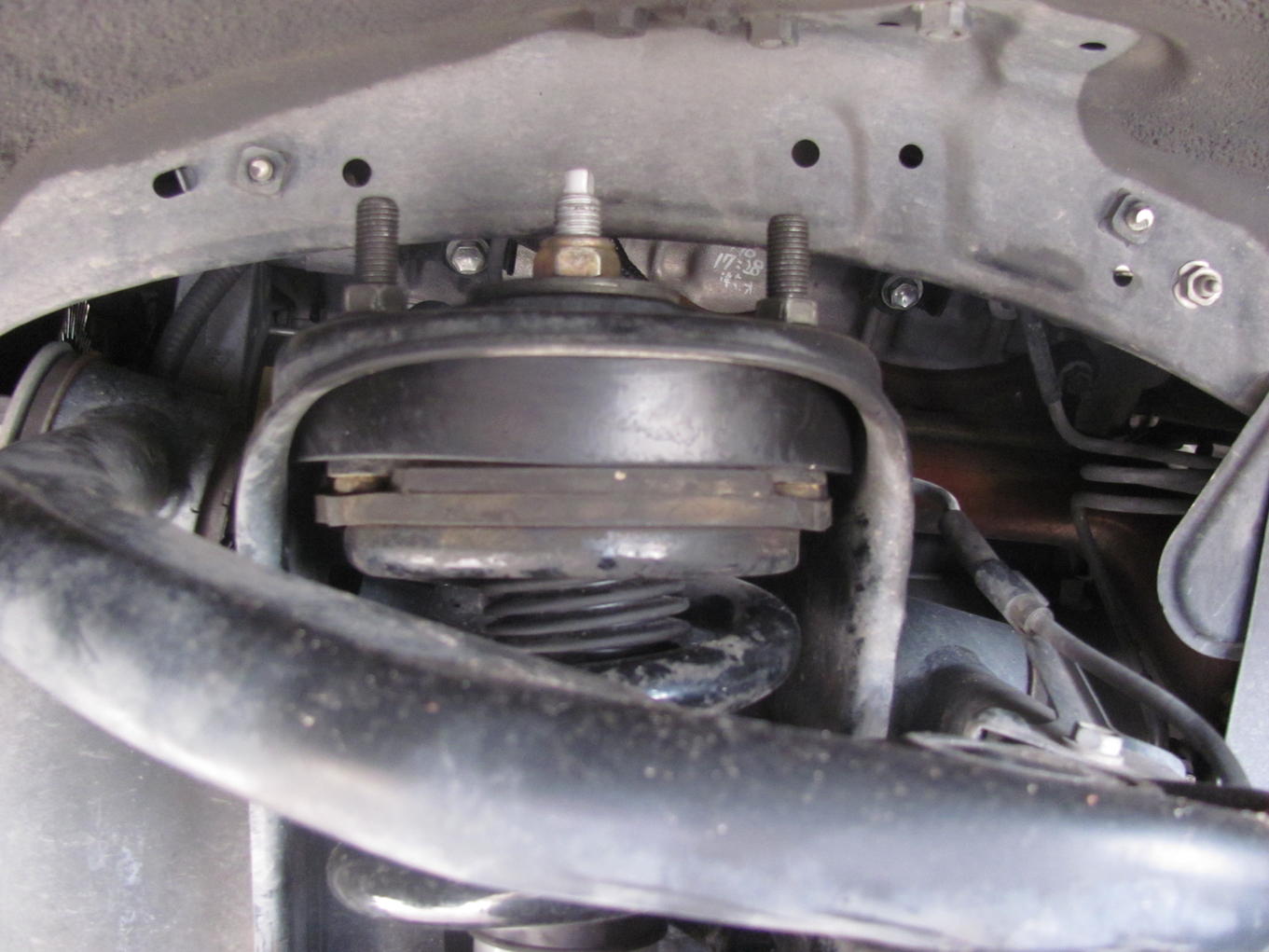

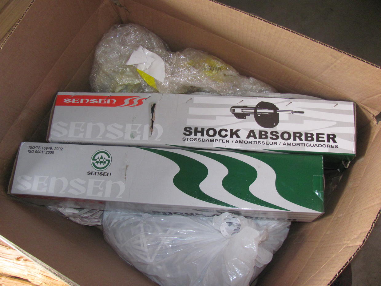

About 2 months ago, I bought Sensen shocks and struts on ebay. They were only $140 shipped, so I gave them a shot. They seem pretty good. I would say that they are an adequate stock replacement. My 06 V6 4x4 has about 80000 miles. The rears didn't seem to make a big difference. The front made a huge difference. The struts wouldn't even rebound when compressed when they were removed.

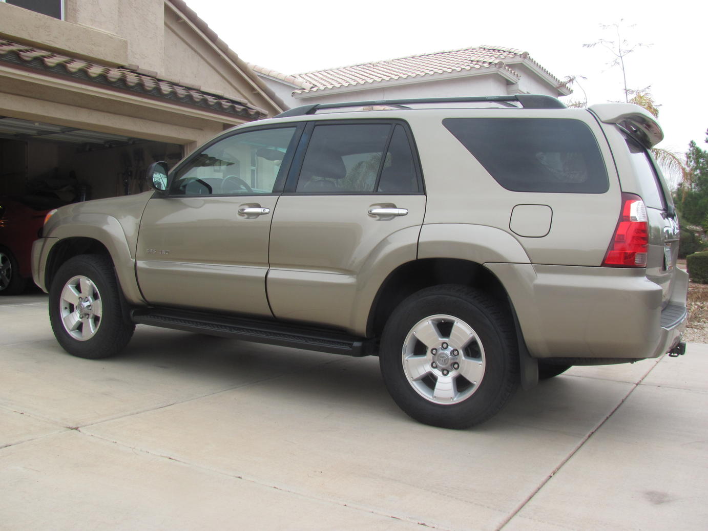

I noticed how much higher the rear actually sat than the front, so I installed the daystar 1" leveling kit about 2 weeks later. I really like how it looks now. My wife, who could care less about cars, even noticed how it looks tougher now. There's also a pic of my ebay spoiler on there.
The only thing I had to do was drill a larger hole in the washers on the rear shocks. The mounting nut was a larger diameter on the Sensen shocks than the rears. Other than that, everything was perfect. I thought I'd post since, no one else had yet.
