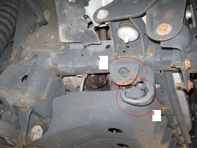

noob to recovery. so to make sure. this is a pic of the passenger side loop and hook.
both can be used for recovery?
the driver side also has a tie-down loop but no hook. do i attach a shackle to that loop?

The tie-down loop (#1 in your pic) is NOT an acceptable recovery point, unless you're stuck at the mall or something.
The hook (#2) IS there for recovery purposes.
For the rear, you can use one for the hitch receiver if it's a good Class III hitch.
so i think i wasted my money on the (2) d-rings i just bought. i already have a hook on the front and just ordered a hitch receiver w/ shackle.
