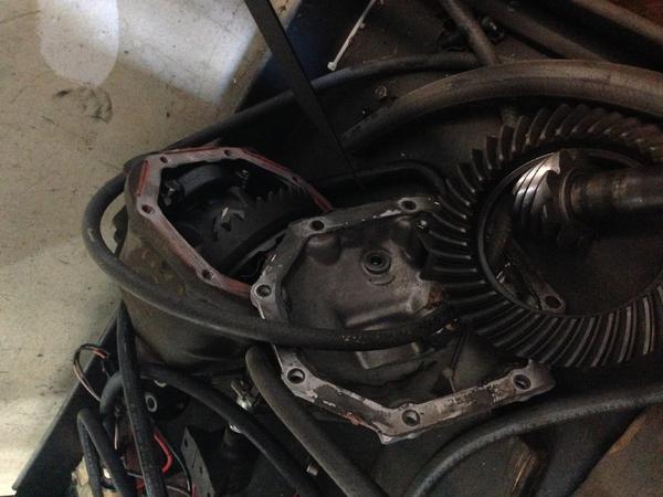

I started with swapping out my 4.56 gears which are pictured below, and installing 5.29s front and rear with a spartan 4 pinion locker in the rear. The front center section in the picture is for sale, factory 4.56 open, just sayin.

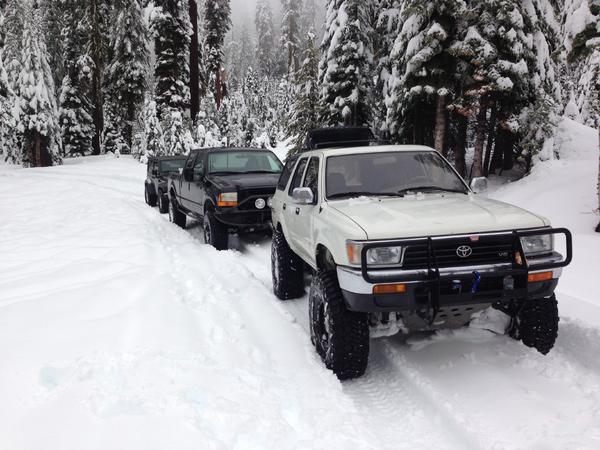

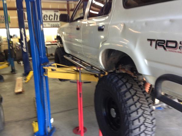

Then to my next order of business. The tube steel thing thats attached to my grill. Same guy with the tires had recently retired his 90 toyota pickup, it had a marlin crawler front bumper. He sold it to me for a reasonable price. I bought me some rock sliders and the rear bumper to match and installed them at work a couple weekends ago.
I put the sliders out so far so my wife can use them as a step. She likes them :D

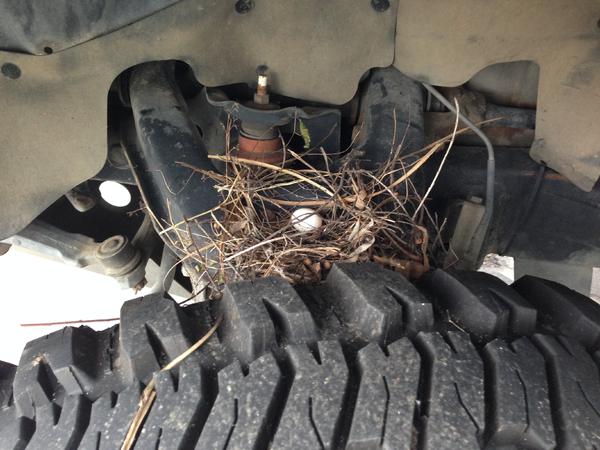

Also, what makes my 4Runner different than all the rest, My 4Runner is eco friendly as you will see in the picture below. Some birds decided to make a nest on my upper control arm. It happened in the course of an 8 hour work day...
sharpie330-albums-other+stuff-picture25162-official-green-certified-vehicle-see-bird-nest.jpg

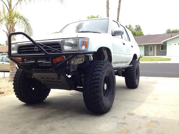

Very cool, custom front skid plate?
Not exactly. I found the skid plate in a pile of parts in the back corner of our shop, it's the pile where we put things that didn't make it back onto a vehicle. It doesn't happen often, but sometimes things like skid plates and engine covers don't make it back on their vehicle. I have no clue what mine came off of but it fit with a small amount of modification.
Lucky you lol, I'm making one today or tomorrow, just depends when I get access to the CNC. I'm making it out of 3/16"

So you posted the BBQ grill pic AFTER the bird nest w/ egg pic... little afternoon snack of scrambled egg? LOL!

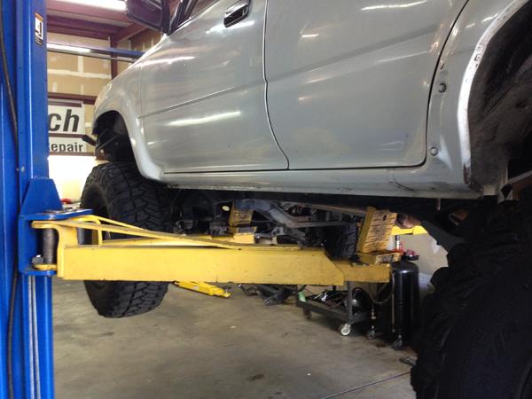

I was able to get the rear leaf conversion done today. Took about 9 hours.
Before
First thing was to get the links out of the way
Then disconnect the brake line, proportion valve linkage, sway bar links and brake cable. Then the axle came right out from underneath.
I had to cut off several brackets.
These are the lower link brackets before and after
After all that was cut off and cleaned up I measured and squared up the leaf spring hangers, tacked em on then installed the leafs and loaded them up to see how they sat.
After finding a happy spot I burned them in.
It was pretty dark when I finished so I couldn't get a great pic of it after. I will post up some when I get it cleaned up and it's light out.
Here are some more after pics, it rides way better than the 4 link did. Firm but not rigid, the 4 link was super soft and swayed a lot.
