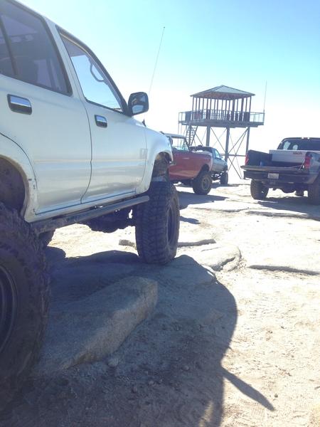

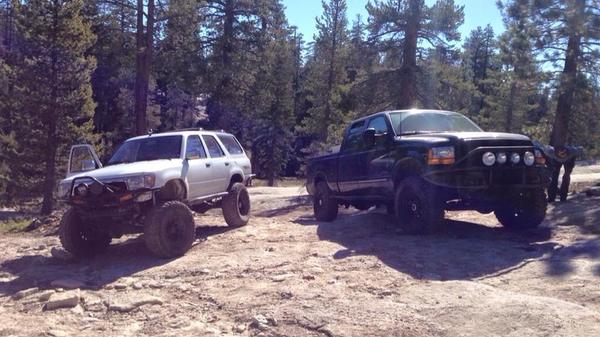

Went up to bald moutain this weekend near shaver lake in california. Was a good time. Got to test out the new suspension.
This is at the top.
This is on the trail.
