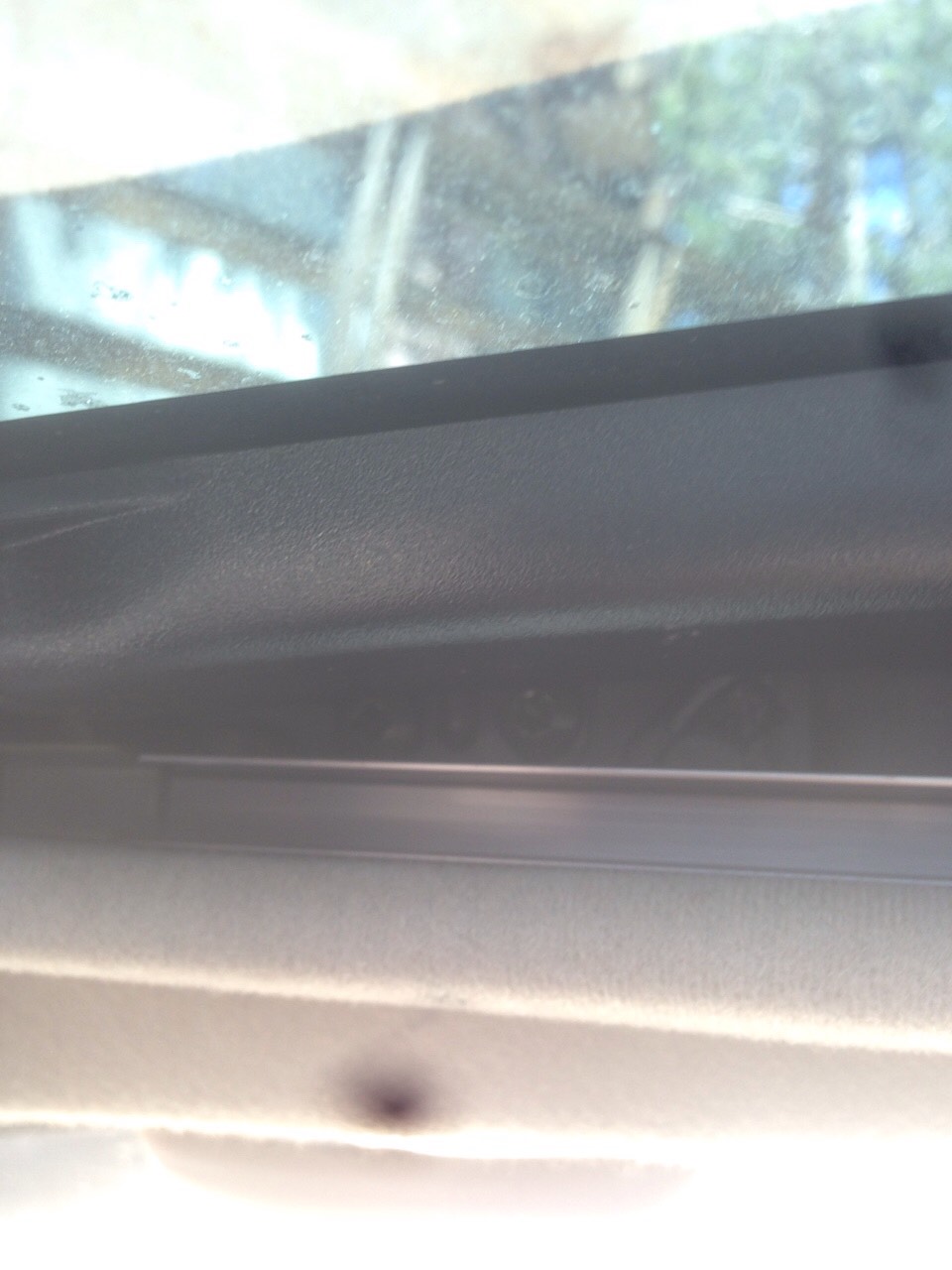

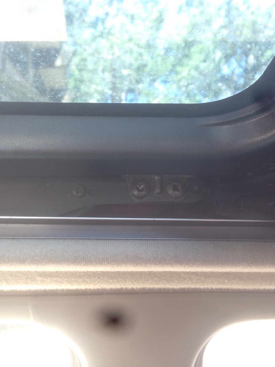

I'm pretty sure you can just remove these screws on both sides to get just the glass off. So put the sun roof into vent mode where it lifts up the back and remove it from the outside and shop vac all the glass out. Not 100% but just trying to help [emoji106] Also I think there's one on the front corners not sure about the back..

Yes it’s easy to pop the plastic covers and undo the 4 nuts. If you’re coming to Vegas I’ve got one with a gasket that has a leak, but the glass is there.
It's not hard - I figured out how to do it while replacing the cables & motors last year. Heck, if you were anywhere near me I'd just give my my old glass, since the $150 replacement I got from a parts yard came with new glass, and I just replaced the whole thing.
